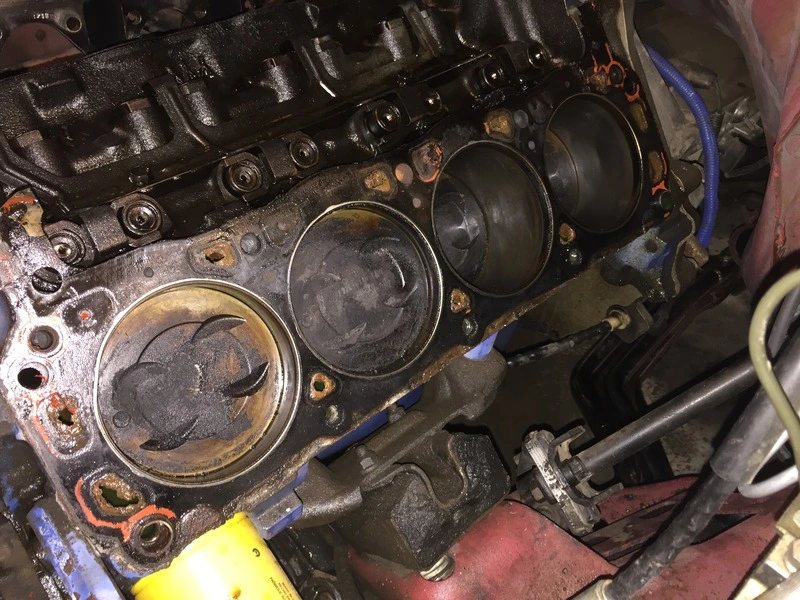

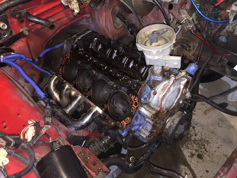

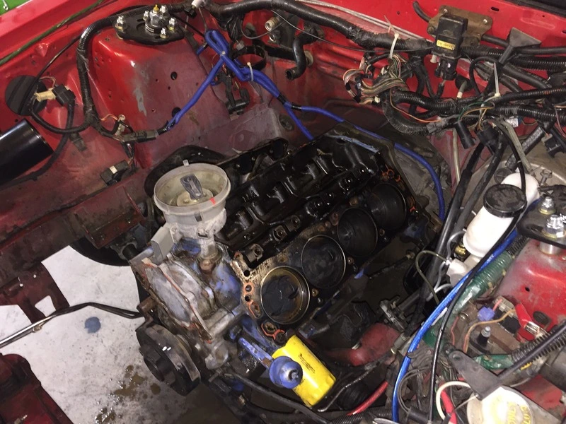

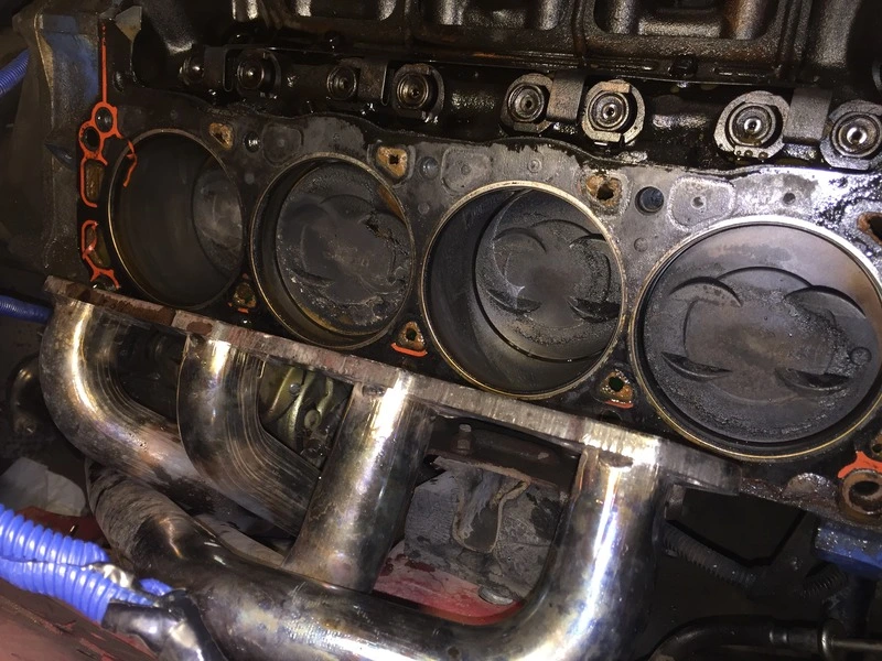

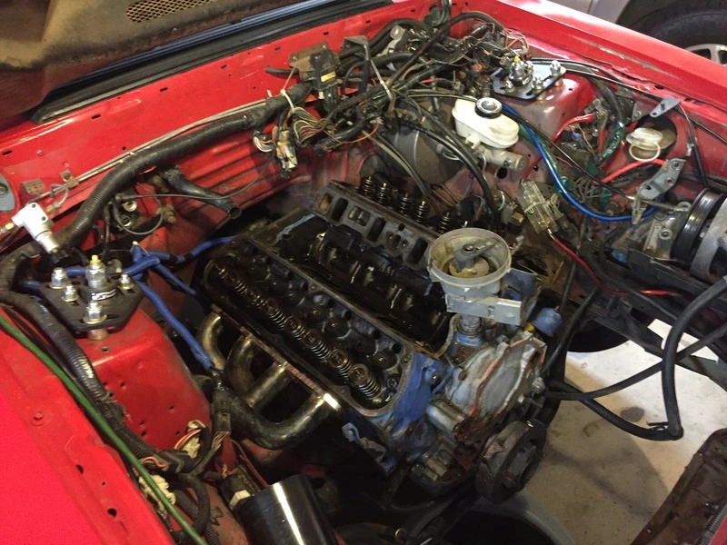

So today I got more done despite getting home at 3am last night from seeing Tanya Tucker and then trying to watch the Masters today as well. I've now got the heads off, and just need to go buy a puller to remove the harmonic balancer then I can get the timing set and cam off. It looks like I've got a stock 87-93 long block (car was originally a 4 banger) and I didn't know for sure what would be inside... pistons have stock ford markings on them and valve reliefs so I know it's at least newer than 86. Not much crosshatching left but the compression was good before the tear down began and I'm fine with this thing running as is as long as it chooses to live as I don't race it or even beat on it really.
And HOLY EFF BALLS why didn't someone tell me how friggen heavy the stock E7 heads are? I feel like I can skip the gym tomorrow after lifting the pair of them off there.
