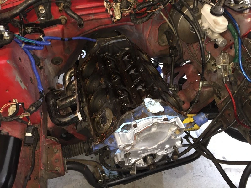

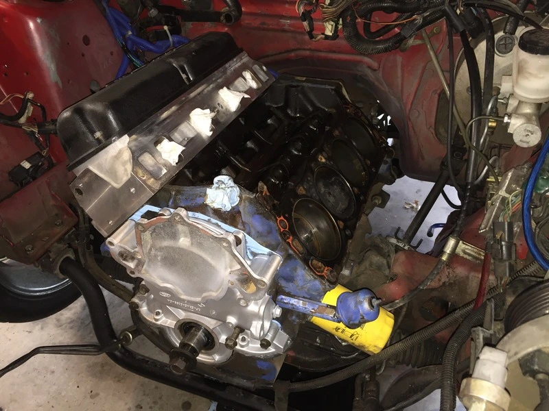

So no pics yet as I didn't have time today but I got my PTV clearance checked and I've got .090 on the intake and a country mile on the exhaust... seriously, like 1/8" or more. To the point I had to remeasure it like 6 times to be sure I didn't do it wrong. That's with a stock short block, a TFS1 cam, Scorpion 1.72 RR, and using the SVE PTV checking tool and the old head gasket. That's also after having .018" milled off the heads as well and Woody from SBF tech said anything over .080" on the intake is good and .100 on exhaust is good so I'm all set and also measured my pushrod length which seems spot on too. So I cleaned up my timing cover and painted it, got it reinstalled with new gaskets and seal... and now I'm done till later if I'm not too tired or drunk after watching the Stars game with buddies. More to come tomorrow.

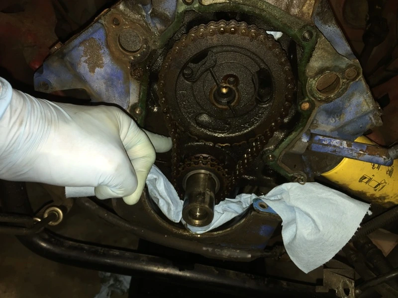

Old chain was worn!

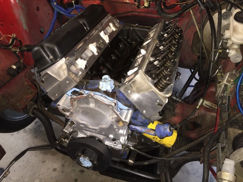

Where I left off last night after checking PTV and pushrod length.

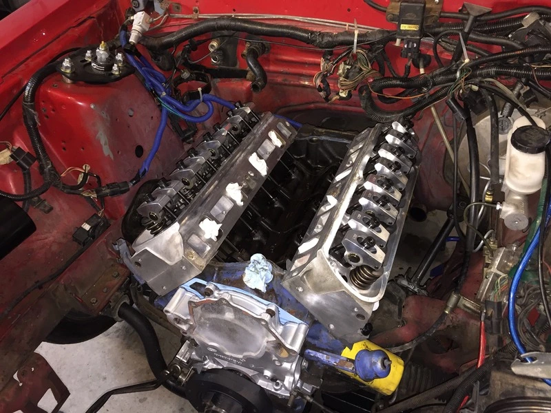

Ready to install gaskets and heads.
Where I'm leaving off tonight.
I still need to torque the heads, rent the balancer installer tool and get that all the way on, finish installing the pushrods and then put on the rockers and get them set... then it's basic reassembly I think! Gotta stop for now as I've been called inside to be and adult and family man.

Old chain was worn!

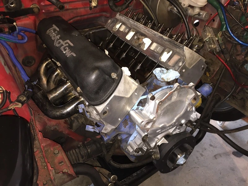

Worked on the car for a few hours last night... would have made more progress but I had to take a @madmike1157 step backwards since I forgot to loctite the cam bolt. So off with the timing cover, and loctite on the bolt and torqued back to specs. Then I had to install the balancer using the tool I borrowed from Autozone that didn't have enough spacers to allow me to get a wrench on the nut, so another trip to lowes was necessary to buy a stack of washers to space the nut back with. Once I got that, it took like 15 seconds to get the balancer installed. Then I returned the tool, so a 15 second job took 3 trips to 2 stores and about an hour of my total time.
After all that was done, I got my heads torqued down, all the pushrods and lifters put on and the valves adjusted. For the valves, I got them set to 0 lash which as I understand it is no play on the rocker arm and the pushrod can just barely be twisted by hand under the rocker. Then I added 1/2 turn on the nut and locked down the allen screw on top. I made sure to do this on a completely closed valve with the opposite valve open.
That was about all I had time for last night, but now I think I'm ready to start putting back on the headers, front accessories, intake, etc.
Where I left off last night.

Yeah, I've had them for a few years now... I'll say this, the passenger side is MUCH easier to install from the top with the head off the motor. The drivers side wasn't that bad to begin with as it comes up from the bottom so I've left it off at the moment but it should go back on today.
Yep, driver side is simple, passenger side requires a lot of alcohol consumption..errr... I mean patience.

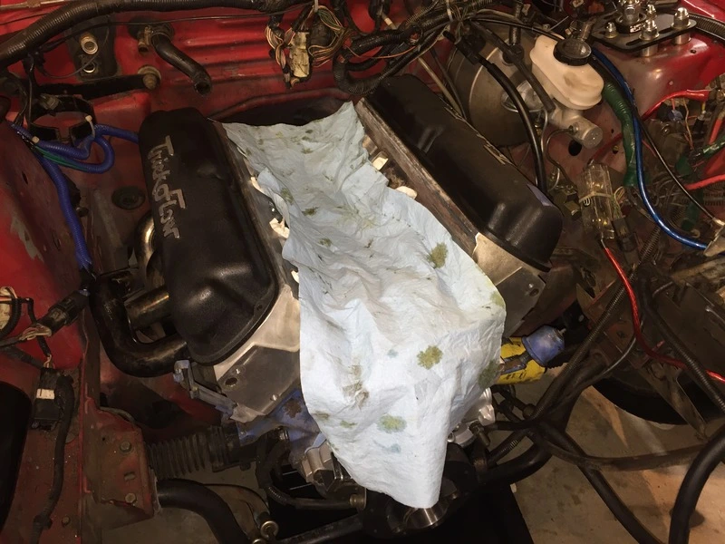

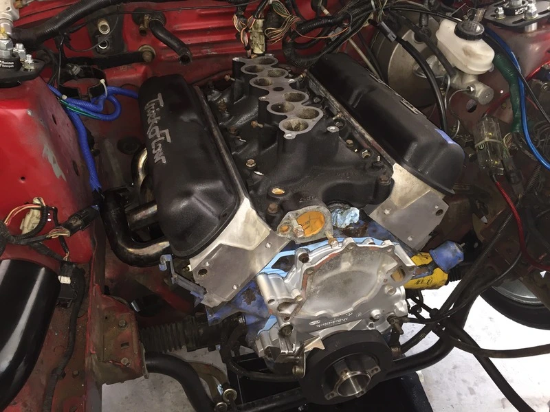

Over the lunch break I got the passenger side header bolted on, passenger side spark plugs installed, and the lower intake snugged into place but not yet torqued down. Hopefully will have the drivers side done the same tonight and stab the dizzy... then final assembly.
