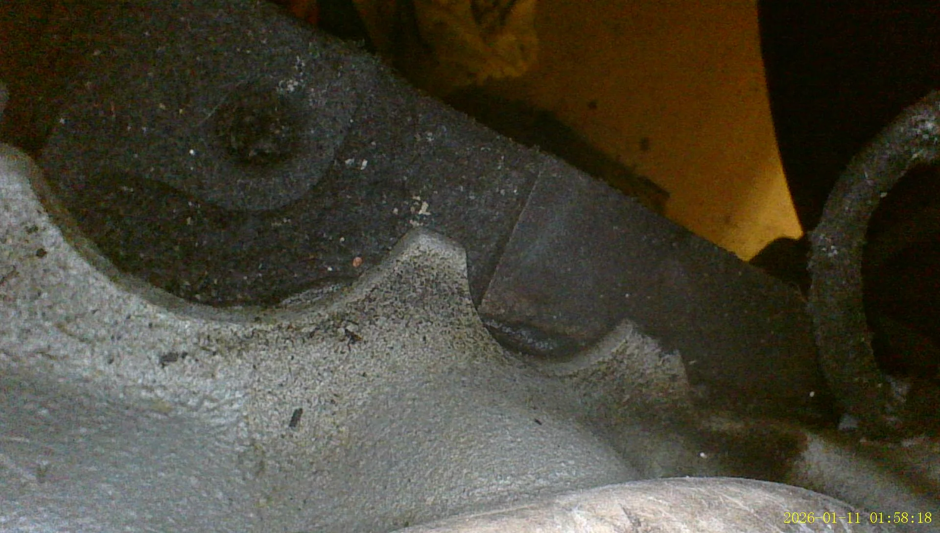

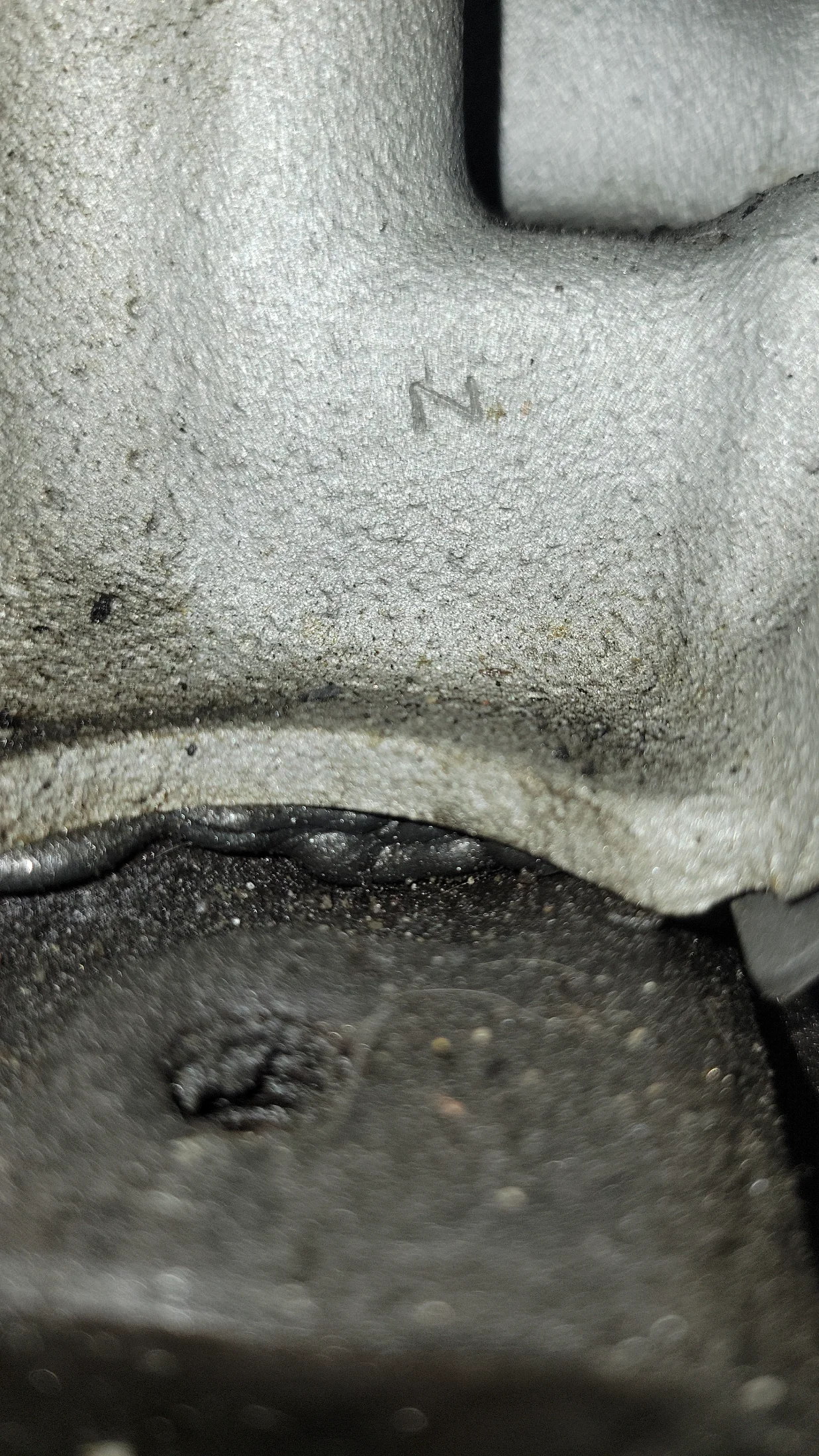

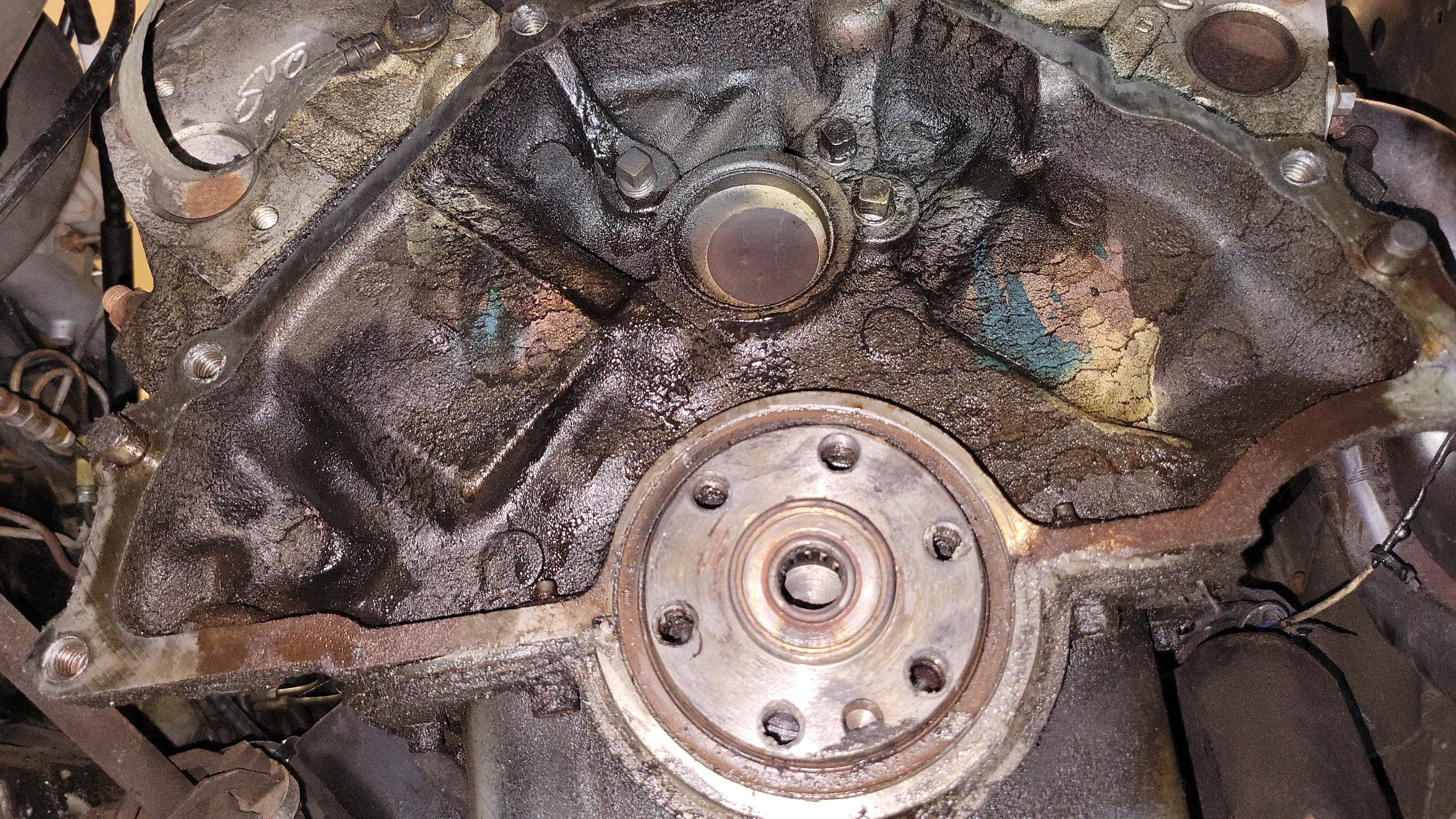

Well, whaddya think, boys? Is it just the rear main seal? If so, it looks like it slung oil/grime upwards. Should I pull those threaded plugs and teflon tape them? It looks pretty nasty on the low end of the drivers head, too. I'll look more closely at the valve cover in that area. The damn thing drips around the steering rack, the oil pan... pretty much everywhere, but why not clean things up whenever I'm in the place to do it, right? Anyways, lemme know what you would do while you're in here.
Also, for not checking bellhousing centricity when I installed the T56, the pilot & input snout looked to be in good shape.
I'd be concerned about the lower intake seal at the china wall, but I got the phone in there for 1 pic and a borescope in for another, and it doesn't seem like it.
Borescope:
Ignore the date-stamp. Looks greasy/dirty, but not sopping wet with dripping oil.
Recommendations for when I get started again tomorrow?
Reactions: RaggedGT
Looks like the rear main to me? Years ago I had a rear drip on my engine. I retorqued the intake and it eliminated the leak, the engine was pretty fresh at that point.
I would check the gally plugs and cam freeze plug, all could be a source of leakage.

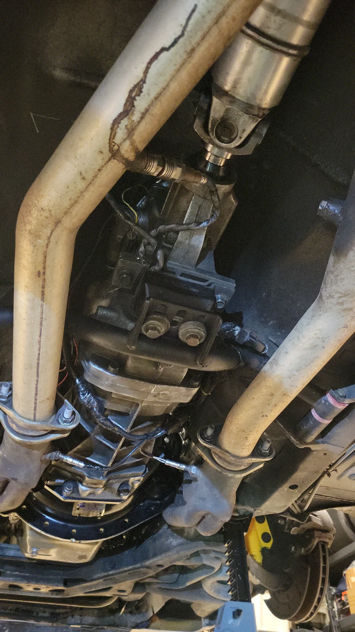

The drivetrain is back together,

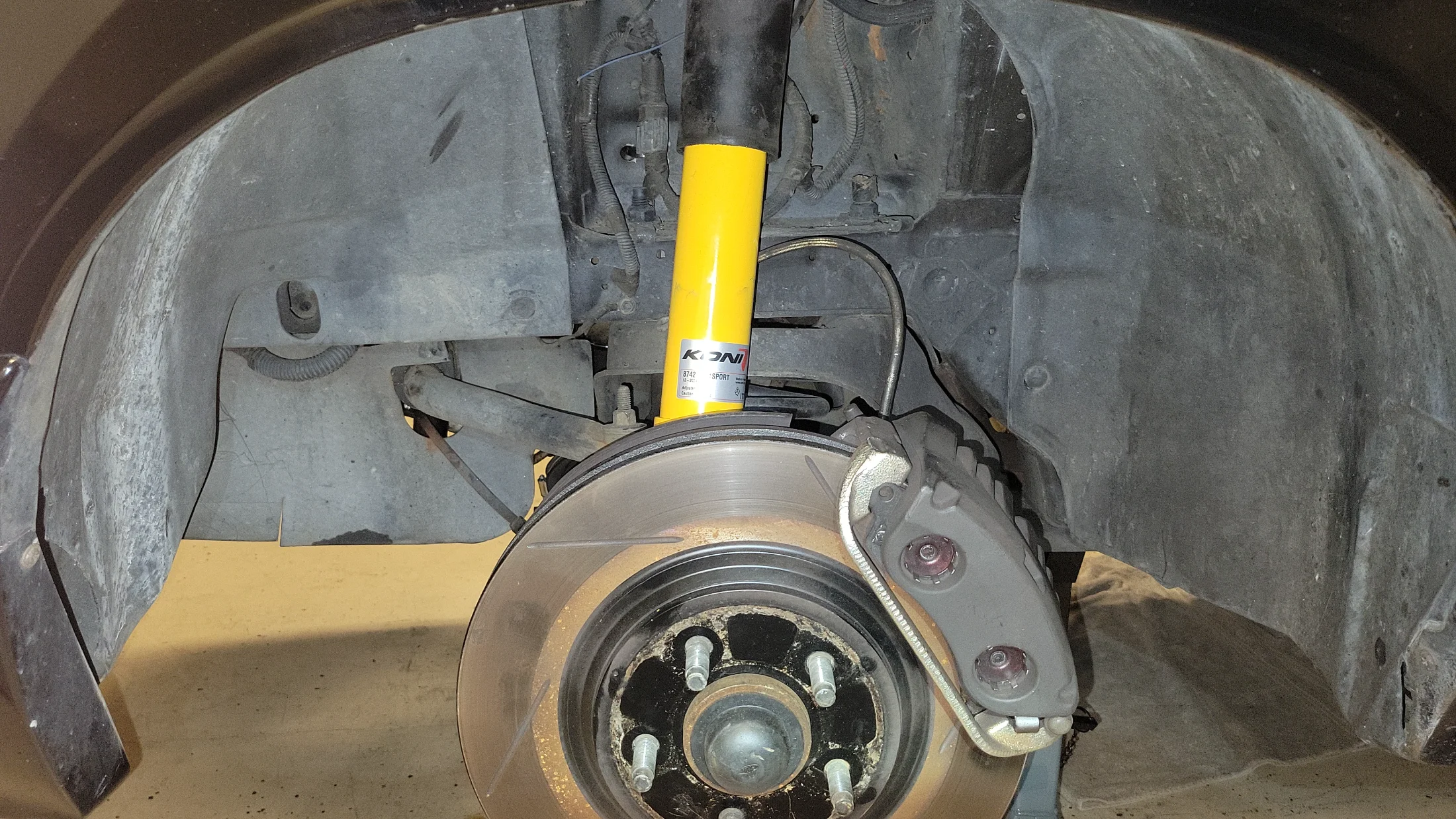

The front struts are amazing! I have Blilsteins on Grover and I like 'em, but so far, I love these. Started, per a previous post, with 1 full turn, out of ~2 3/4 from full loose on rebound, and with just 1 click, of 12, from full loose on compression. Did a little slalom style wheel sawing and noted more body roll than I liked. So, I added a click of compression (2 of 12 from loose), and this is a really good spot for me. Black Jack used to feel boaty. Now, there's still some body roll, but it's much flatter, and turn-in seems crisper to me, but it's not so stiff that it's a bother over uneven pavement.
I think this is going to be a big improvement at an auto-x.
When you say 1/2 the pedal, you mean effort or travel? Also, I'm interested in continued feedback on the struts. Out of the half dozen cars I've butchered, this is the first one thats a dedicated street machine and am interested in handling improvement.
Maybe an exaggeration, but seriously, the old worn clutch got to a point that even with preload, it wouldn’t fully disengage even with the entire pedal stroke. It was making the trans really notchy and tough to shift, especially when trying to be aggressive.
Now, after installing the new clutch and setting it up, engagement happens much sooner in the pedal travel. So when I say “half the pedal,” I mean travel, not effort. Pedal effort feels about the same, but it’s actually disengaging cleanly now, which makes a huge difference in shift quality.
On the struts, early impression is they’re a big step up. The car feels more settled in transitions and takes a set quicker. Still some body roll, but much more controlled and predictable without getting harsh over bumps. I’ll keep dialing them in and report back once I get more time on them and push it a bit harder.
