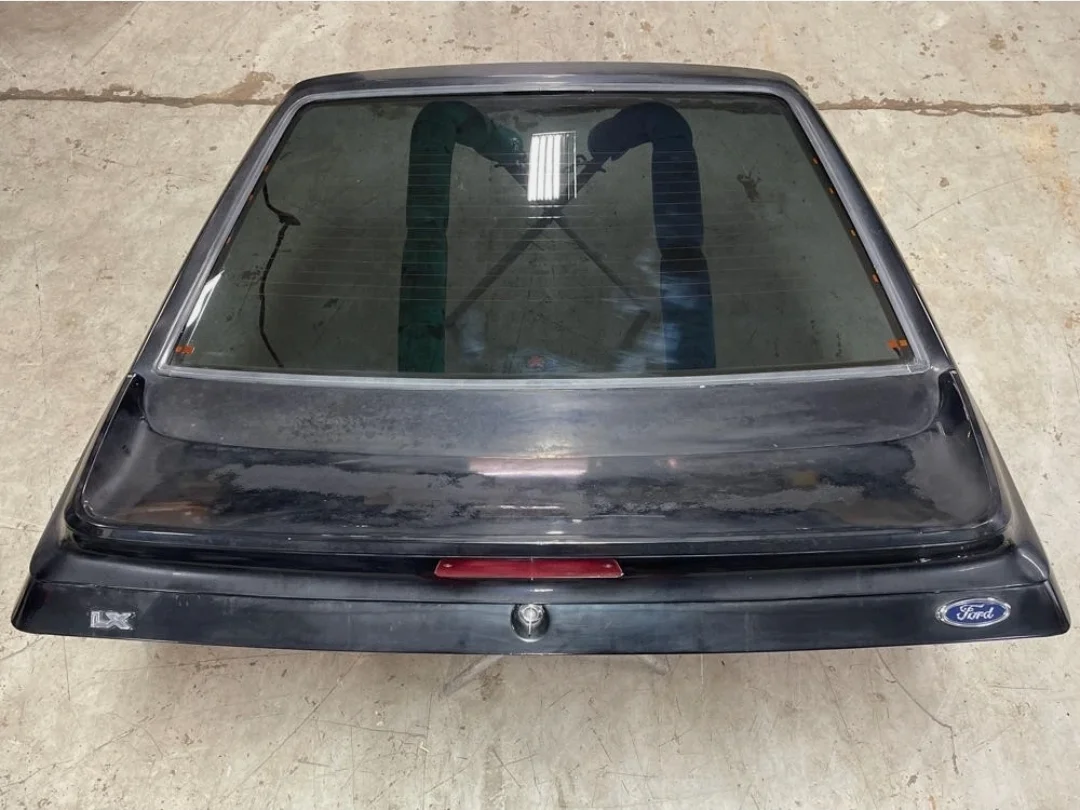

I am pumped to have found a black rear hatch and rear bumper cover panel off of a wrecked 92 at a nearby junkyard! The paint ain't great, but neither is the rest of black jack's. Looking forward to finally 'repairing' the damaged ones from when that truck hit me a while back. Got $3.4k or something like that out of insurance and this will end up being a $430 repair.
Oh... and I'm also unreasonably excited about getting back to the LX spoiler.

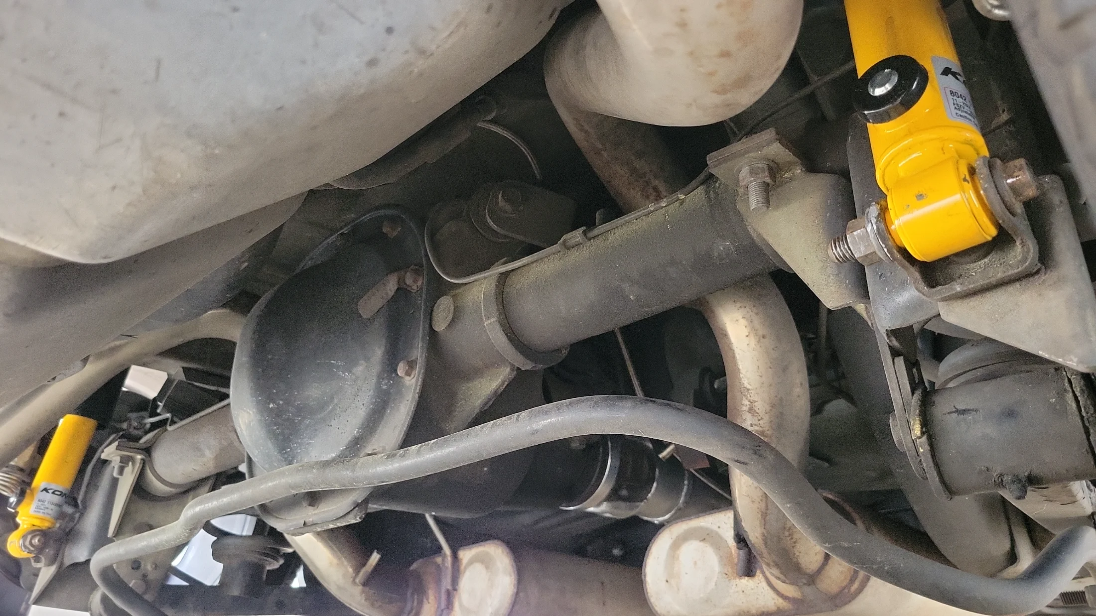

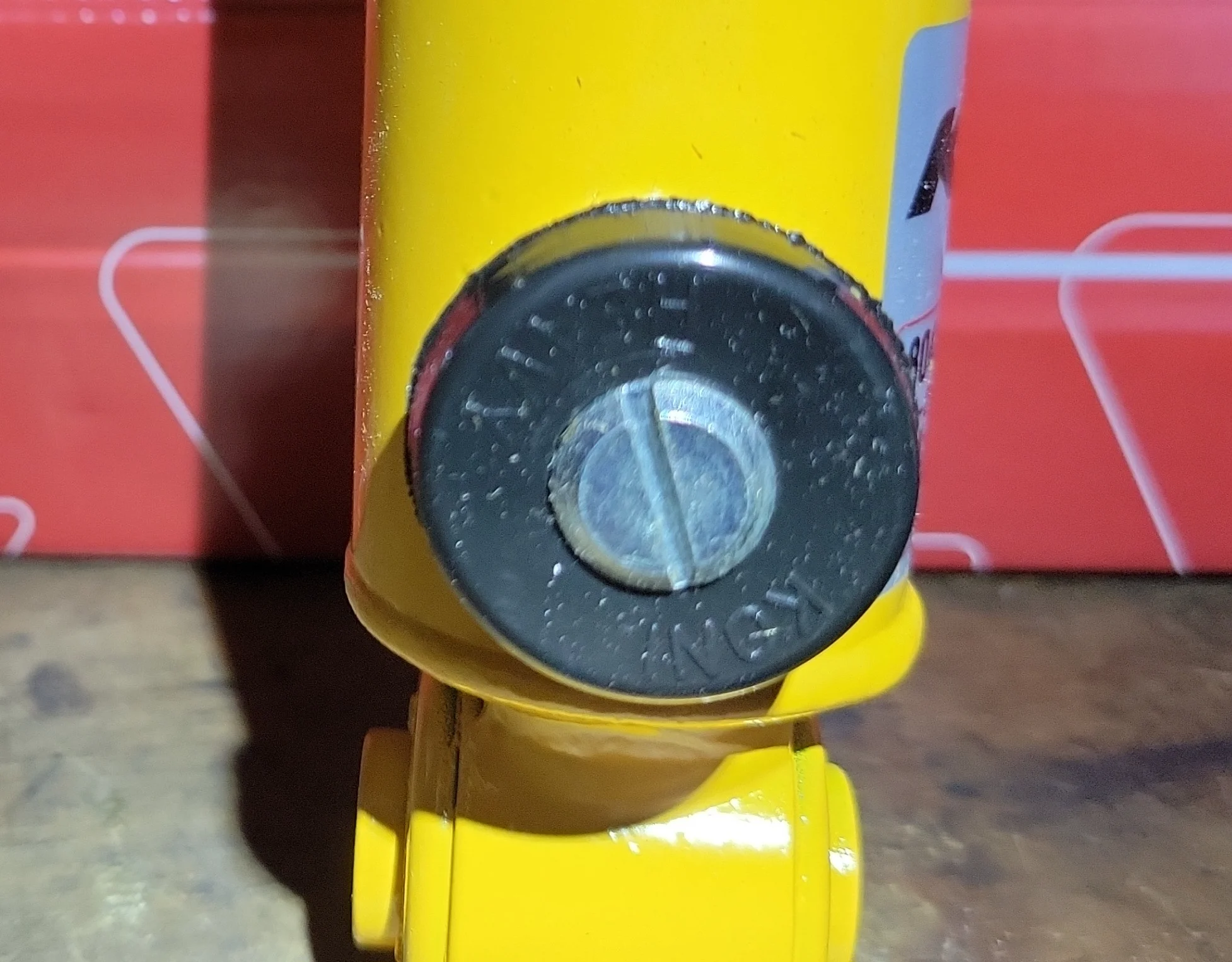

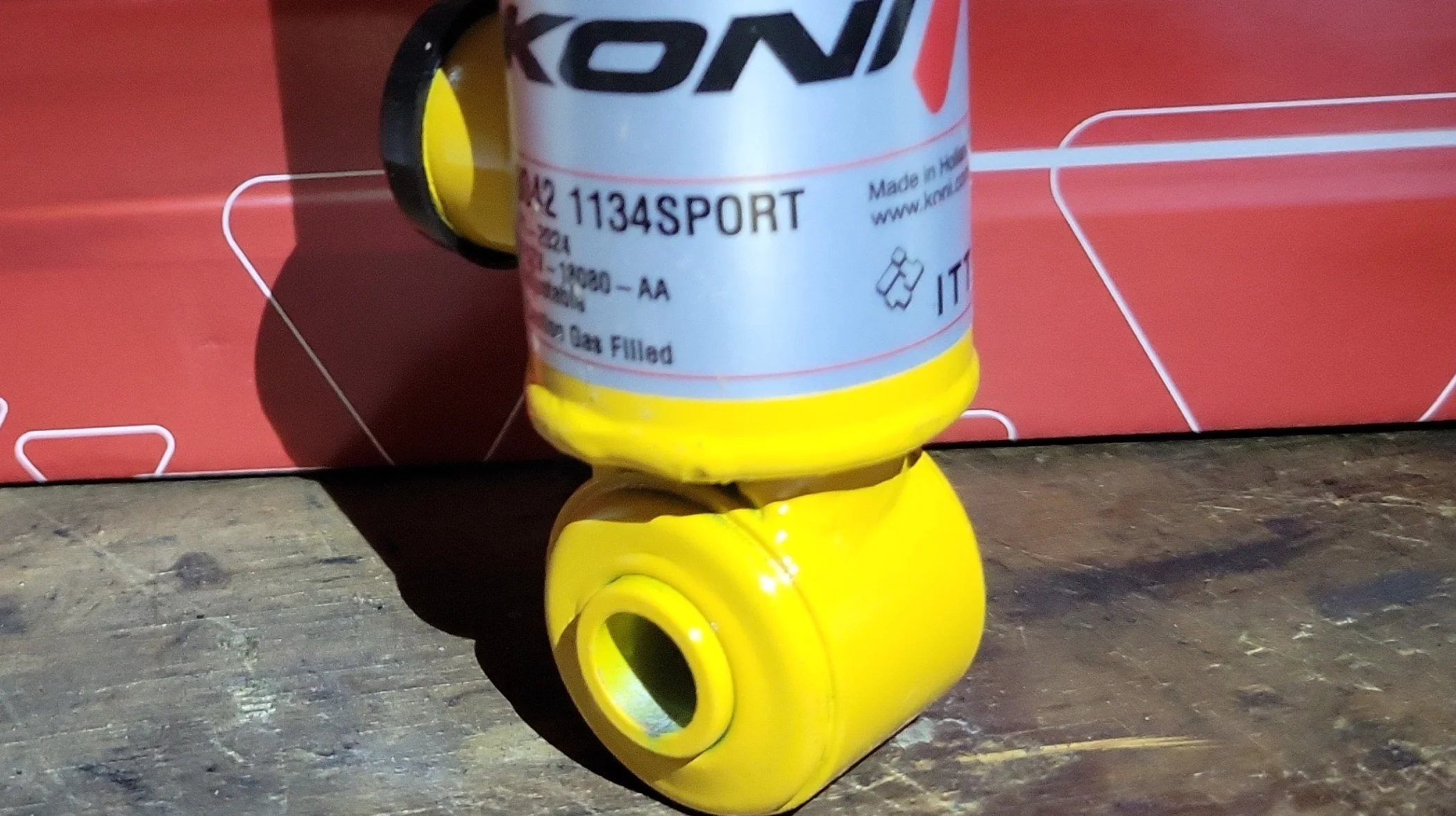

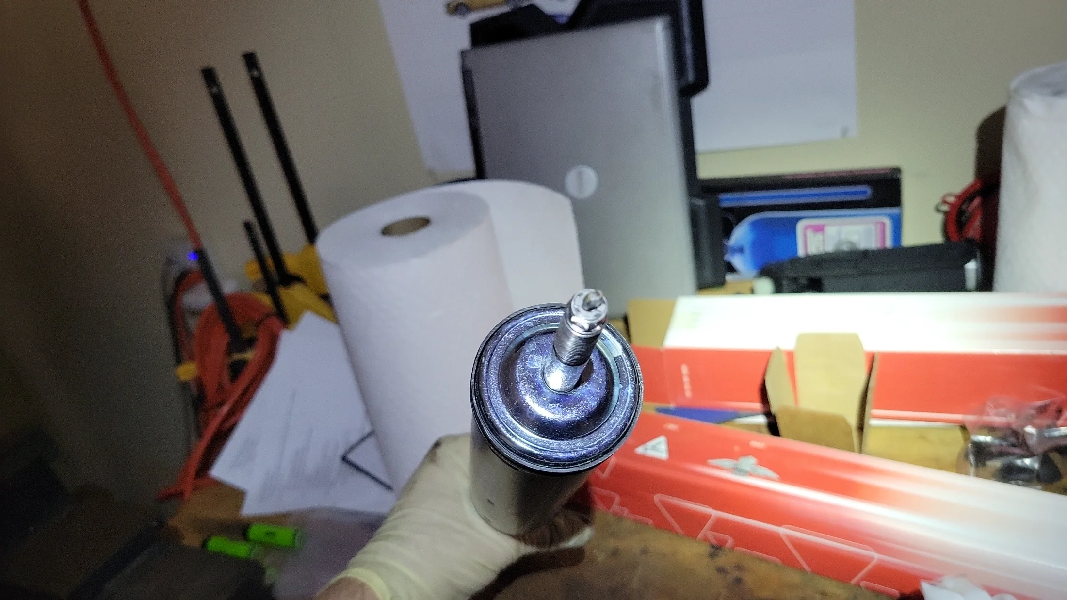

Koni rear DA shocks (8042-1121 Sport) installed
As mentioned in one of the last posts, I was so impressed with the front Konis that I bit the bullet & ordered rear double-adjustables, as well. They were ~$370/ea.
They replaced Lakewood 40301 shocks, which are ~$100 50/50 drag shocks. It was time. They were no longer doing their job, and were making noise. I didn't notice any leakage, but the mounting rubber was pretty rough, and the driver side's shaft was loose & rattled.
Initial settings were clearly softer than the Lakewoods, and induced more body roll and too much softness, making the rear too rolie-polie. Adding another click of compression back there helped more than I expected. Turn-in is nicer than before, body-roll/laziness are pretty decent, & so far as I can tell balance seems alright, but I'll know more on auto-x day when I can safely keep it near the limit in transitions and hopefully a sweeper.
Talking things through with my dumb-but-smarter-than-this-newb coach, ChatGPT, I'm trying to maintain or improve Black Jack's balance. So, while I have the front at 1/2.75 (36%) on rebound, and 2/12 on compression, I set the rear to 0.75/2.25 (33%) on rebound, and 3/12 on compression. Theoretically, the slightly softer rebound should allow weight to transfer forward more freely, as the inside rear extends easily and outside rear resists extension slightly more than the front.
It still needs adjustment, and it doesn't have the same wire colors or connectors, so I still have stuff to work through, but hell yeah brother, that LX spoiler just looks better than the GT on these cars:
1. Better spoiler
2. the later years latch, fortunately I had a spare striker for it on the shelf
3. Already tinted (no spots like my KY tint guy had in there)
4. Everything in better condition
Everything's squared away on the hatch. It's a much better piece in many ways.

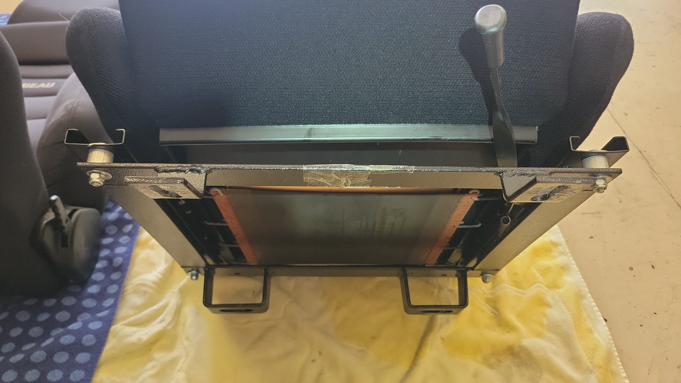

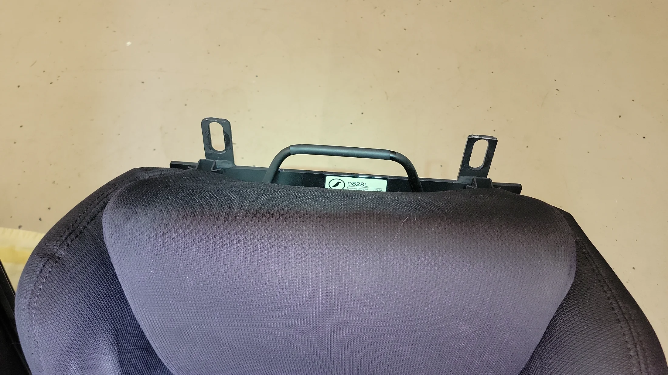

Next up: I dropped off the driver's corbeau GTS II, because I can feel the almost wire thin metal frame protrud8ng from the left-thigh-bolster's padding. I think if I let that go too long, it'll wear through the cloth cover. Gotta say, these are the economy seat options of the upgrade world.
Also, since they sit so much higher, I've asked my upholstery guy, Ahail, to remove about an inch of the bottom padding.

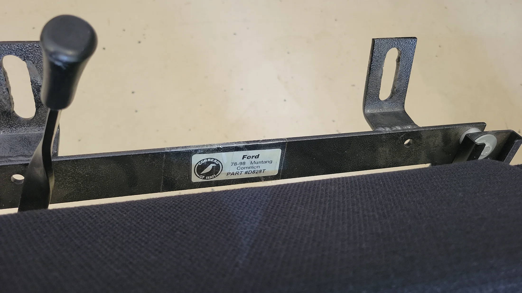

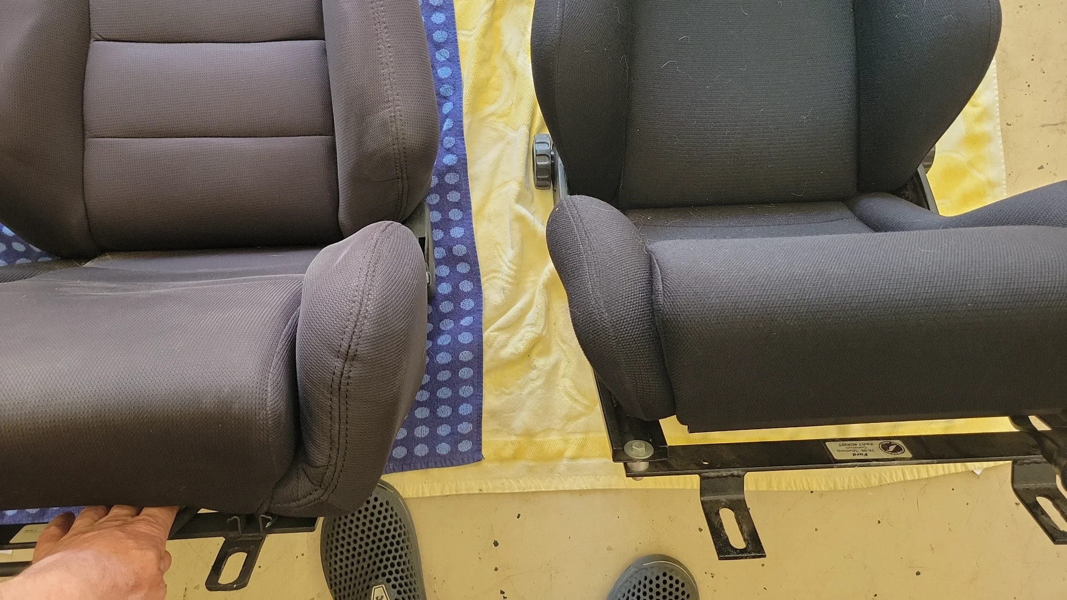

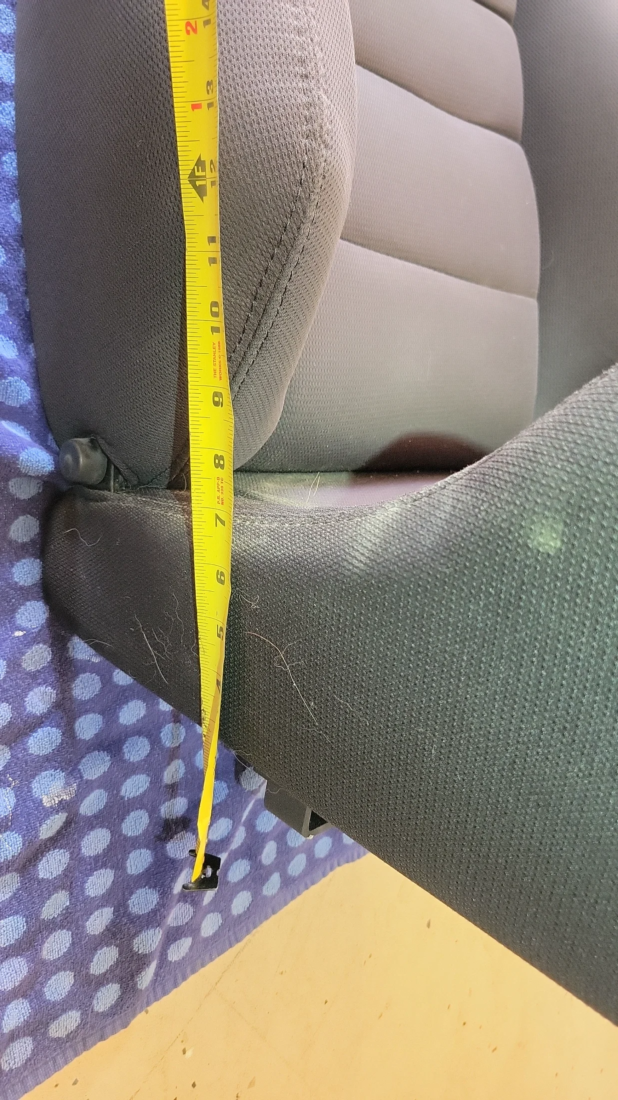

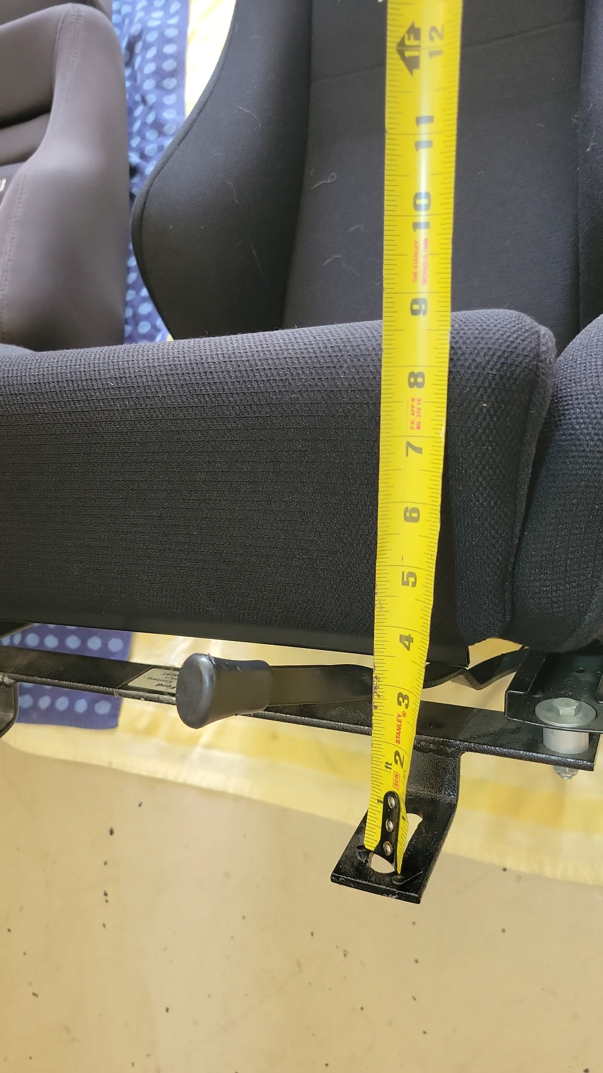

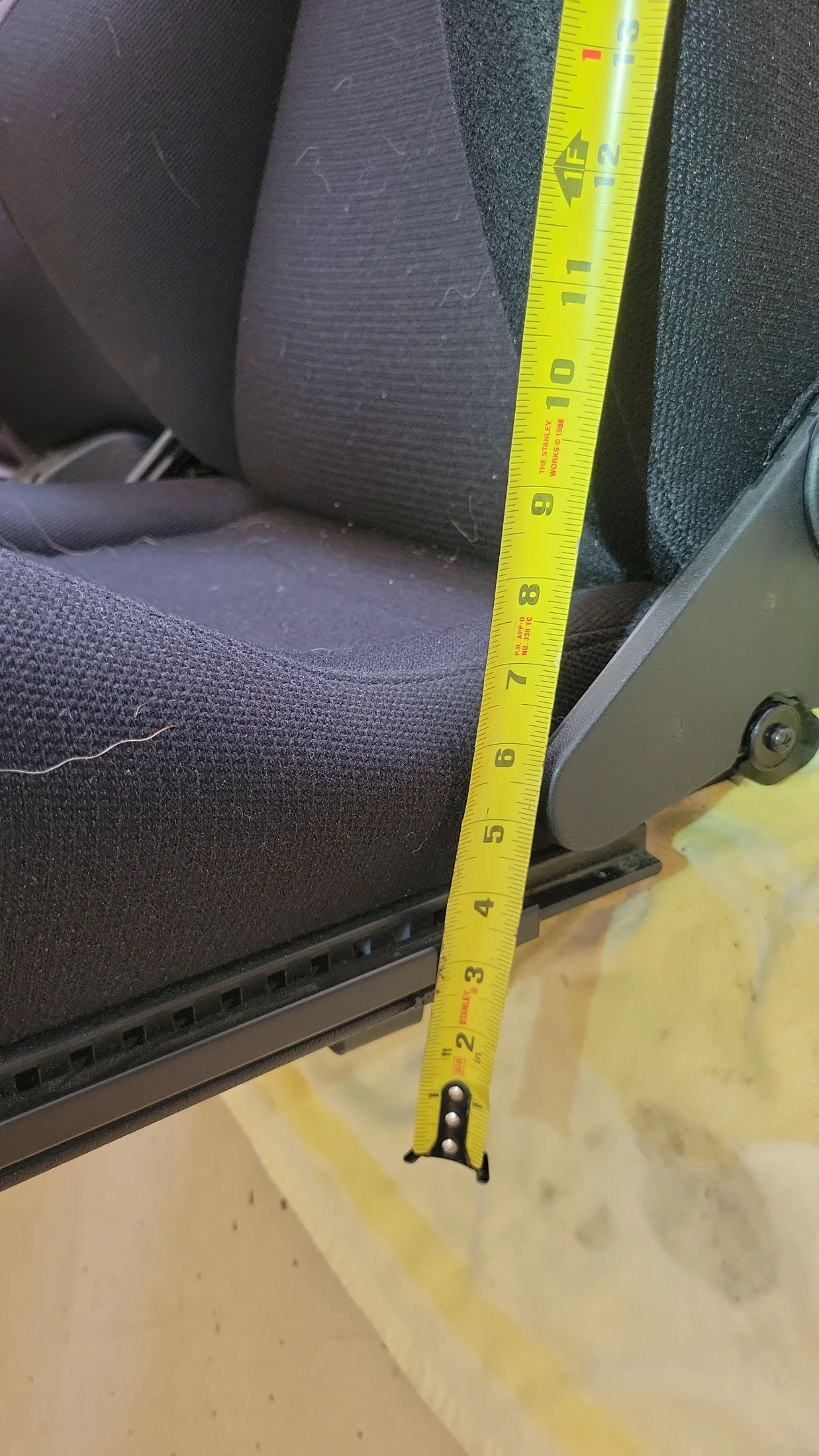

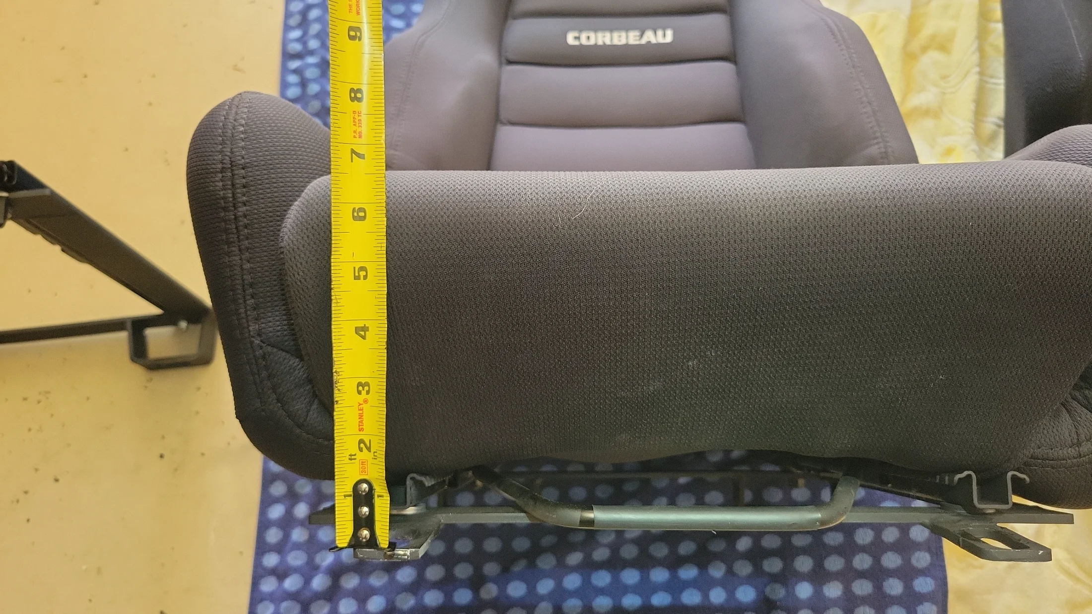

For :poo:s n giggles, since I temporarily swapped the driver's seat over from Grover, I went ahead and put it side by side with Grover's Recaro SE. No wonder! The angle, combined with the fact that the Recaro's bitt padding buckets in below the outer portion of the seat, makes it tough to see the actual measurement, but even with a STANDARD height corbeau bracket, the butt pad is 5.5-5.75" from the rear floor mounting surface, whereas the Corbeau is more like 7" from a LOW-PROFILE Corbeau bracket's mounting point.
The guy apologetically said it would be two weeks, and internally, I enjoyed the excuse to daily that far more comfy Recaro.
Corbeau:
Recaro:
Both:
Both in Father Time & Grover, the Recaros are just better. The upper torso lateral support is higher, the padding is more glove-like, the knee bolsters are not in the way but still supportive, & the cloth is nicer. Plus, the Recaro's tilt is infinitely adjustable, and it sits just right in the car on these old standard 828D brackets & sliders without needing a seat track extender.
I don't wanna blow the $2k onthe modern knock offs, but it's on the christmas list for some day.
Ps. I'm not knocking any other Corbeau, and I got these for $6-800 (probably posted earlier in this thread), but these vs. my Recaros is a "get what ya pay for" kinda deal. Still, the GTS IIs are doing what I needed them over the stockers for... they keep my fat in the right spot on the auto-x without needing to death grip the steering wheel.

Love the dogs hair on your seats, my boys hair is on my seats and he doesn't even ride in it.
I gotta say the corbeau sport seats I gotta killer deal on six years ago have served me well,but my fat arse doesn't auto x
Being 6'5 I tried a set of seat track extendeners, and they do work - well made and easy install but I lost an inch of head room that I didn't have to spare.
I'm actually changing back now.
What seats? I'm 6'4. I made the Corbeau's work with low profile brackets and detaled that here in this thread. But, while it's even fine with a helmet on, it's still higher than I like. That said, the Recaros work on extenders, too. You would have enough room in them.
I was thinking the same thing. Every single thing I own looks exactly like the seats, covered in white dog hair, LOL
Reactions: nickyb
I tried the Corbeaus initially, and even with the shaved foam option I felt they sat high. The recaros actually sit low enough you feel like to get down into your Mustang when you sit in it. It's low enough I have to put a hand down on the door sill to get out of the car.
I highly recommend LX style recaros. The LS ones that I have are just too aggressive in the side bolstering.
Where does one get the best price?
I'm honestly about ready to sell the Corbeaus and get my money out of them while I still can.

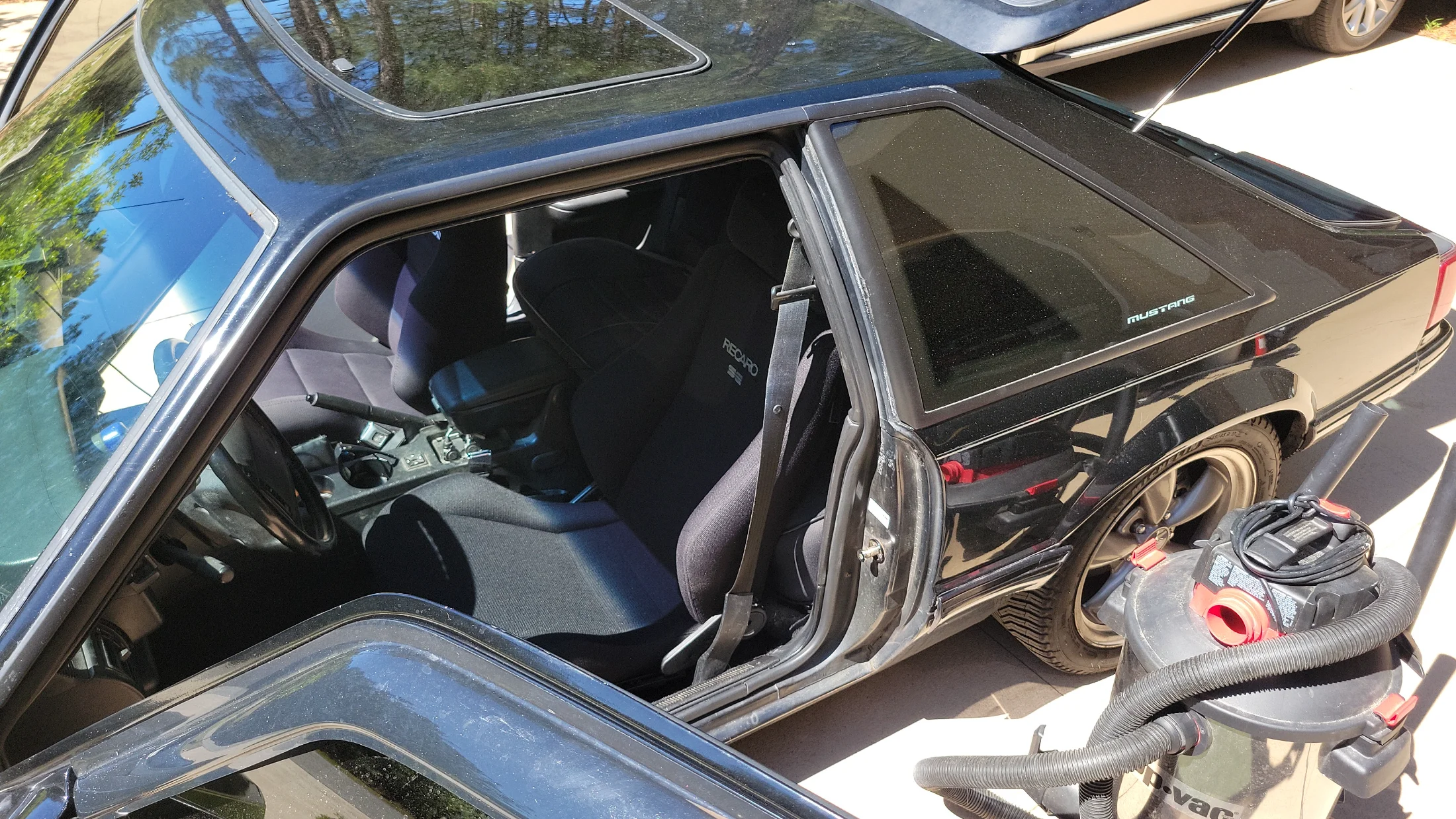

It's not something I remember acknowledging on here, but without cats, the stench of the exhaust was noticeable in the cabin whenever I came to a stop. I'd gotten into the habit of using the vents and/or non-recirculating A/C when going at parking lot speeds or idle. Now, after installing the new hatch, I can leave it on however I like, and the air stays clean. I guess the old hatch, despite the newer seal, was allowing some air into the cab.
