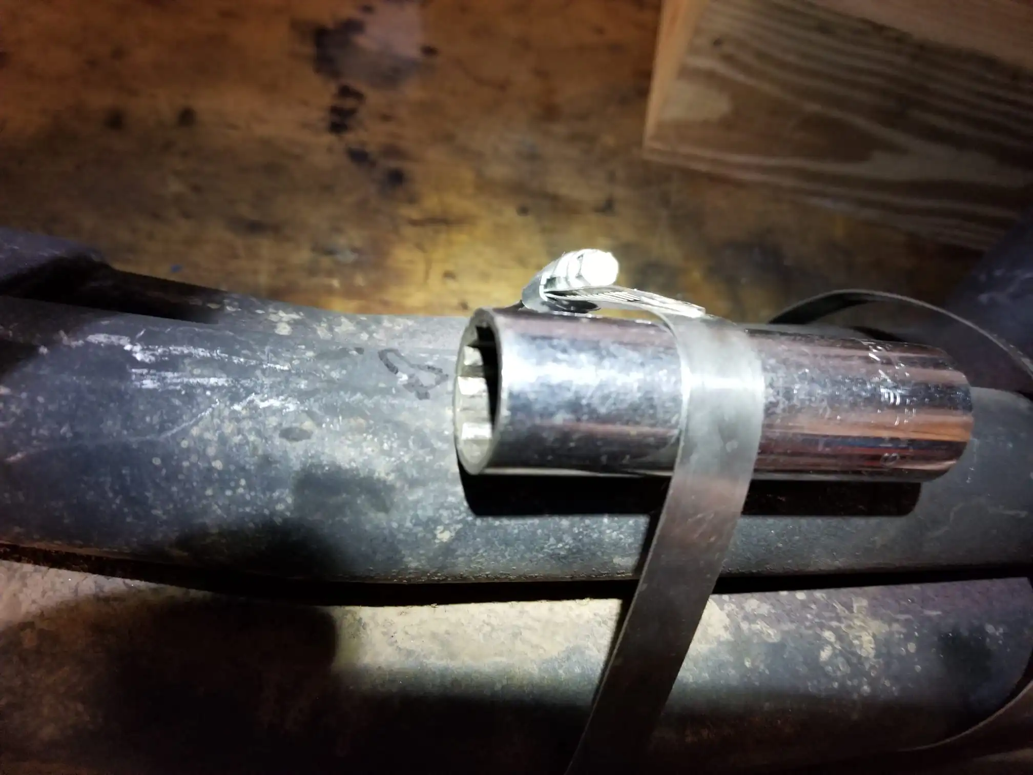

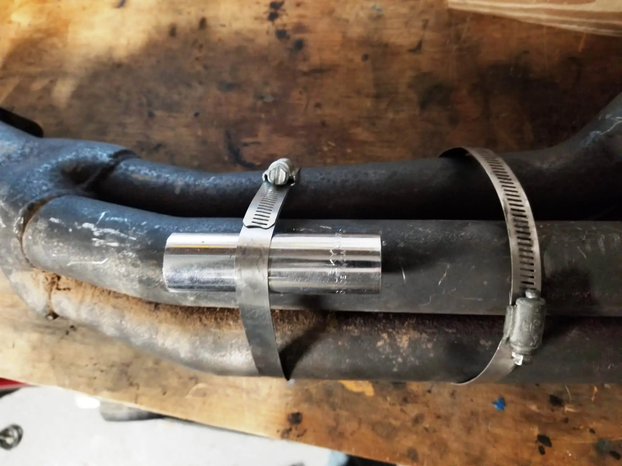

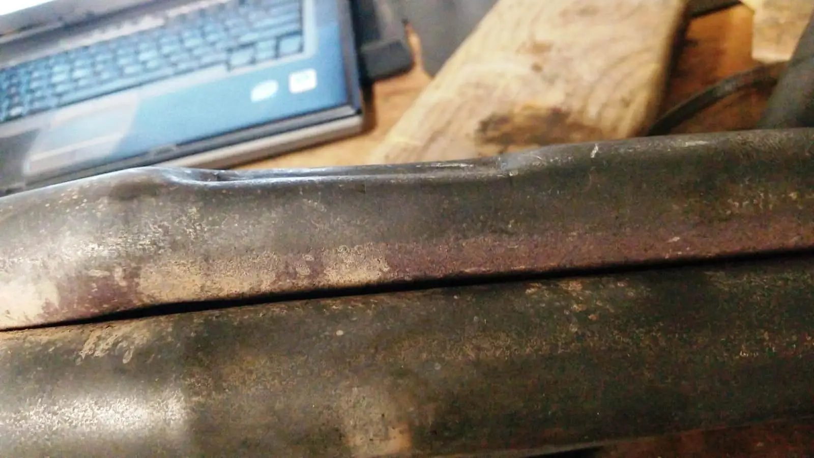

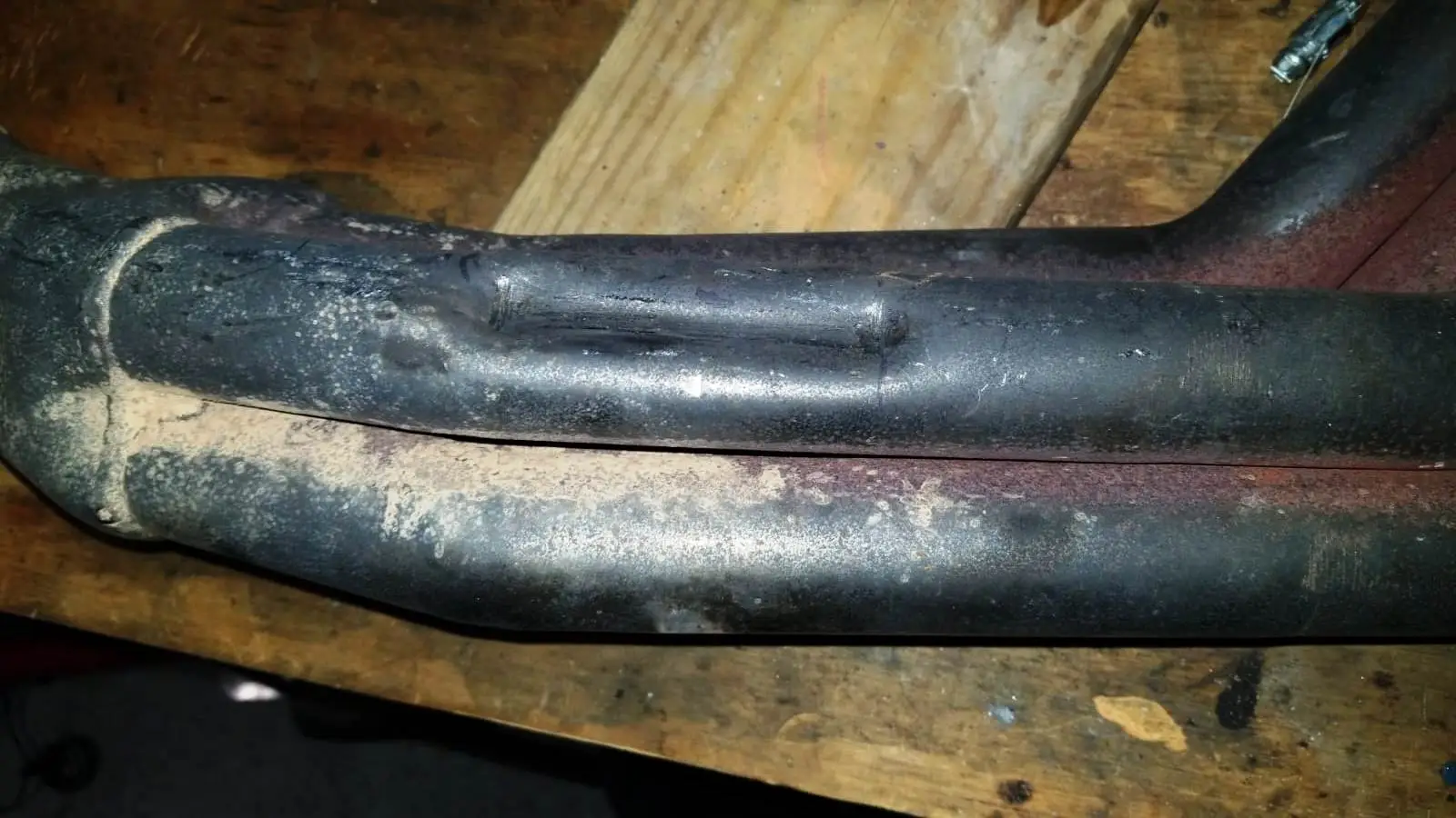

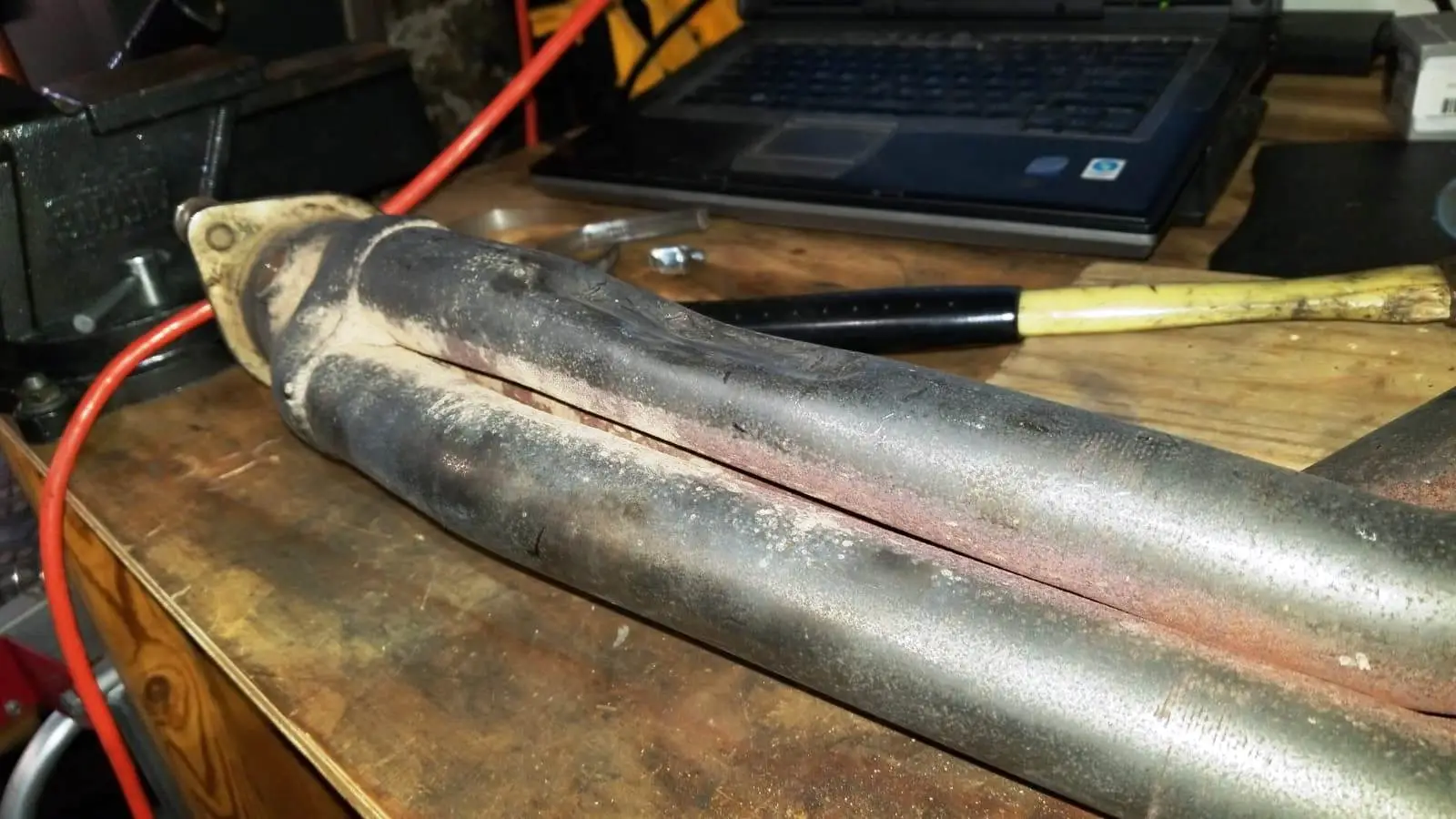

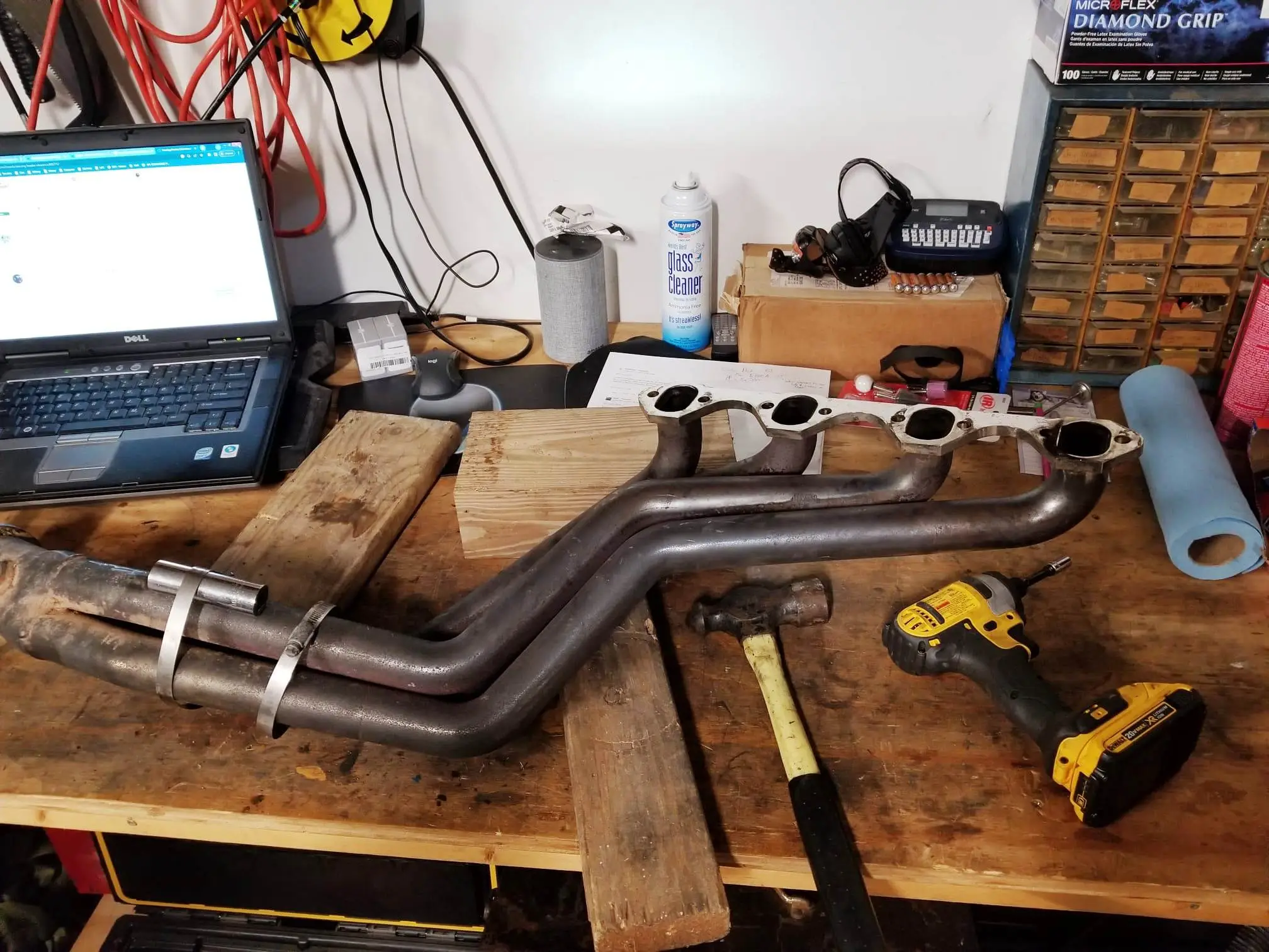

Header-to-clutch-fork clearance plan: I've been semi-obsessed with finding what I could about fitting a T56 in with my BBK Long-tubes, and what I keep finding is that either:
1) Folks make it work behind a 351, with probably an extra inch of clearance, by hammering denting on of the primary tubes to achieve proper clutch fork clearance. I don't mind doing this as long as it's a very minor dent that won't affect performance
2) A guy actually cut and redrilled the end of his clutch fork to achieve clearance. I like this idea the most. Another guy on Corral suggested that the cable would have such a bend that it would cause premature wear. This doesn't sound right, to me. If I'm going as far as cutting the clutch fork, I don't see why I wouldn't modify the angle of the cable sheath into the bellhousing's front plate so that the cable can continue straight to the clutch fork. This is the idea I suspect that I'm most likely to try. I'll need to fit everything up first to be sure.
3) One guy actually used a jack to bend the headers out of the way. I really don't like this idea, but would use it if I felt confident I could do it without screwing things up. I don't want to irreparably damage the headers without being certain I would achieve fitment and keep my exhaust alignment to the tail pipes.
Is there a right way to install a T56 without hitting the BBK Long Tubes?

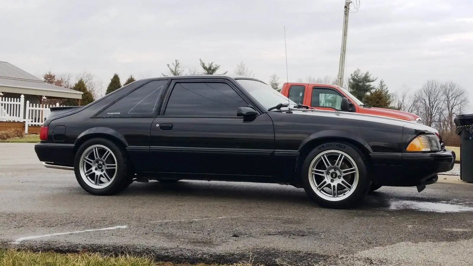

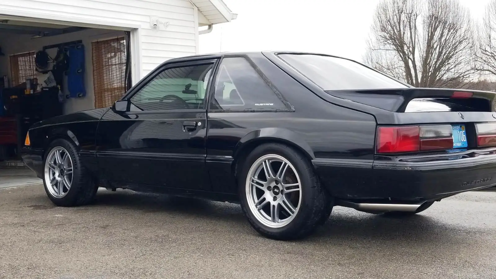

New Shoes:
Nothing outside of the box on this one. They look ever so slightly better than the Ponies ;-). Honestly, I've hated the Winter Tires. I don't know if it's because they're a bit taller than stock or if it's just Michelin's design, but they sway a bit like a bias ply tire. I'm sure they're great in snow and ice, but until I'm dealing with that weather, I'm sticking with the Pilot Sport 4's up front and the old Nitto 555R Drag Radials I already had out back. Back spacing is 5.95" and I'm a bit surprised that when cornering to the right, the driver's tire is grabbing something. I can hear a repetitive thud. So, I guess it's only hitting the tire in one spot. The 245's up front are grabbing the liner at wheel lock to the left. I have a fender roller, but I'll put that on the back burner for now, because...

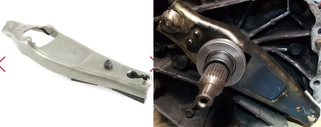

I *think* I've got what I need to put the T56 in, now. I mocked up the SN95 clutch fork with the QuickTime Bellhousing, marked the fork and took it to a fabricator who cut and rewelded it for me. It turned out very nice, and I'm hoping that shortening it up between 1-2" will give me the clearance I need for my long-tubes. I also managed to find a 43.5" aluminum driveshaft with a 27-spline output shaft yoke from a seemingly nice fella on FB marketplace for $150. The Cable-X was on back order and I cancelled with the 3rd party company I was ordering it from. If everything works out over the next couple of days and the T56 goes in ok, I'll live without a speedo for a while, which is ok since I have 2 others between my Garmin GPS, and my Escort Radar Detector.

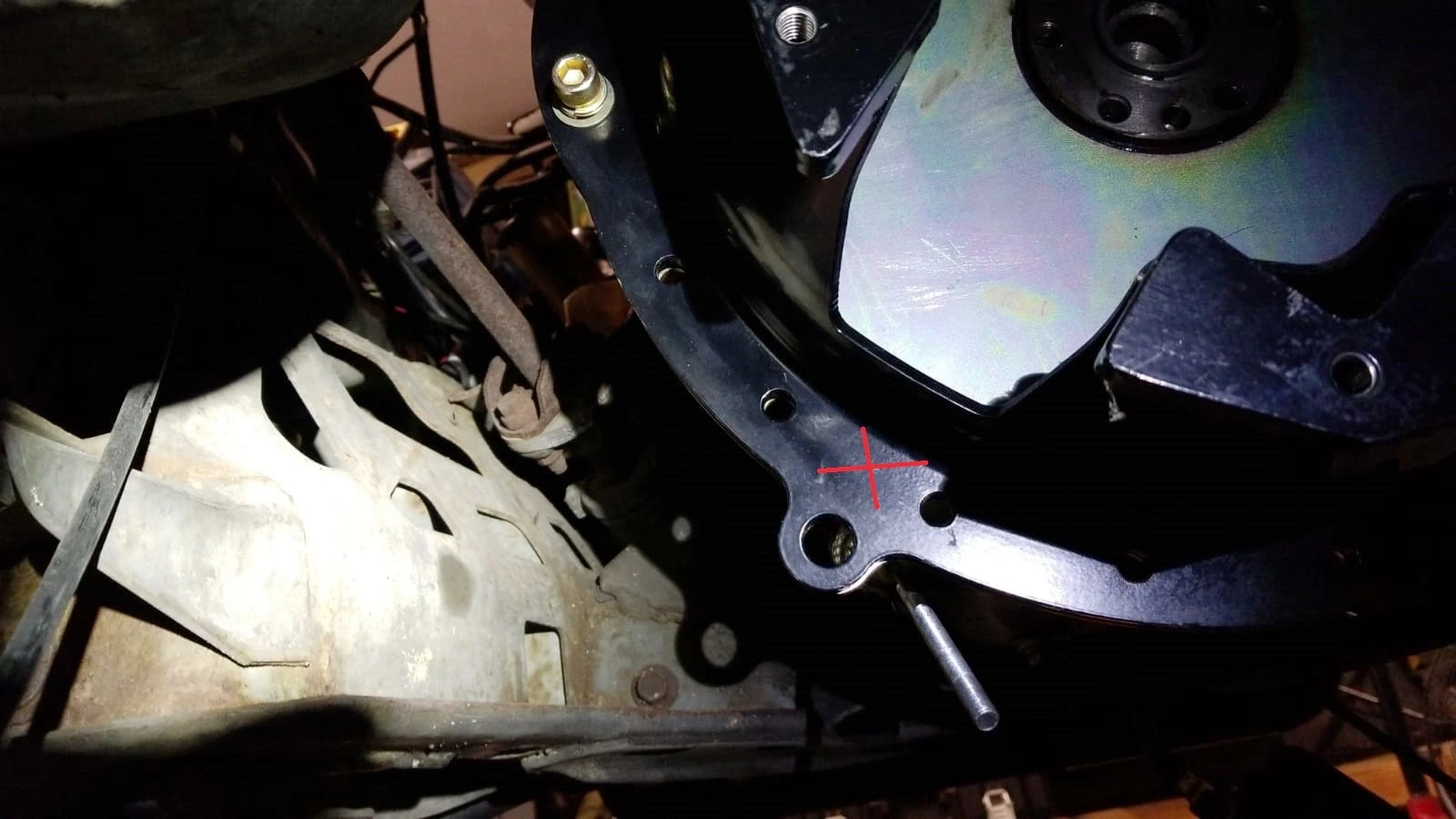

Though, I haven't been in a hurry, I've made a little progress. I got the flywheel & clutch out of the car, and I mocked up the T56 to see whether the shortened SN95 clutch fork would play nicely with the BBK Longtubes. It didn't. So, I broke out the BFH, and we're working through our issues to see if we can find a resolution:
The red x indicates where I'll need to drill so that the clutch cable placement doesn't cause too much of an angle that will prematurely wear it out. With the Longtube back in place in the next pic, I was happy to see that I would not have to cut anything off the bellhousing, but you definitely start to get the sense of why the 7 o'clock fork position is not optimal with BBK longtubes:
I didn't get a great pic of the shortened fork on its own, but I'll take one when I pull everything back out before the final install. But basically, the clutch fork has been shortened 1.5"-ish, no longer has the hole that the cables like the MM and OEM cables need, and only has the outermost hole as close to the bellhousing as it can be. With the Steeda cable, I can just put the adjustment screw through and add the nut on the backside.

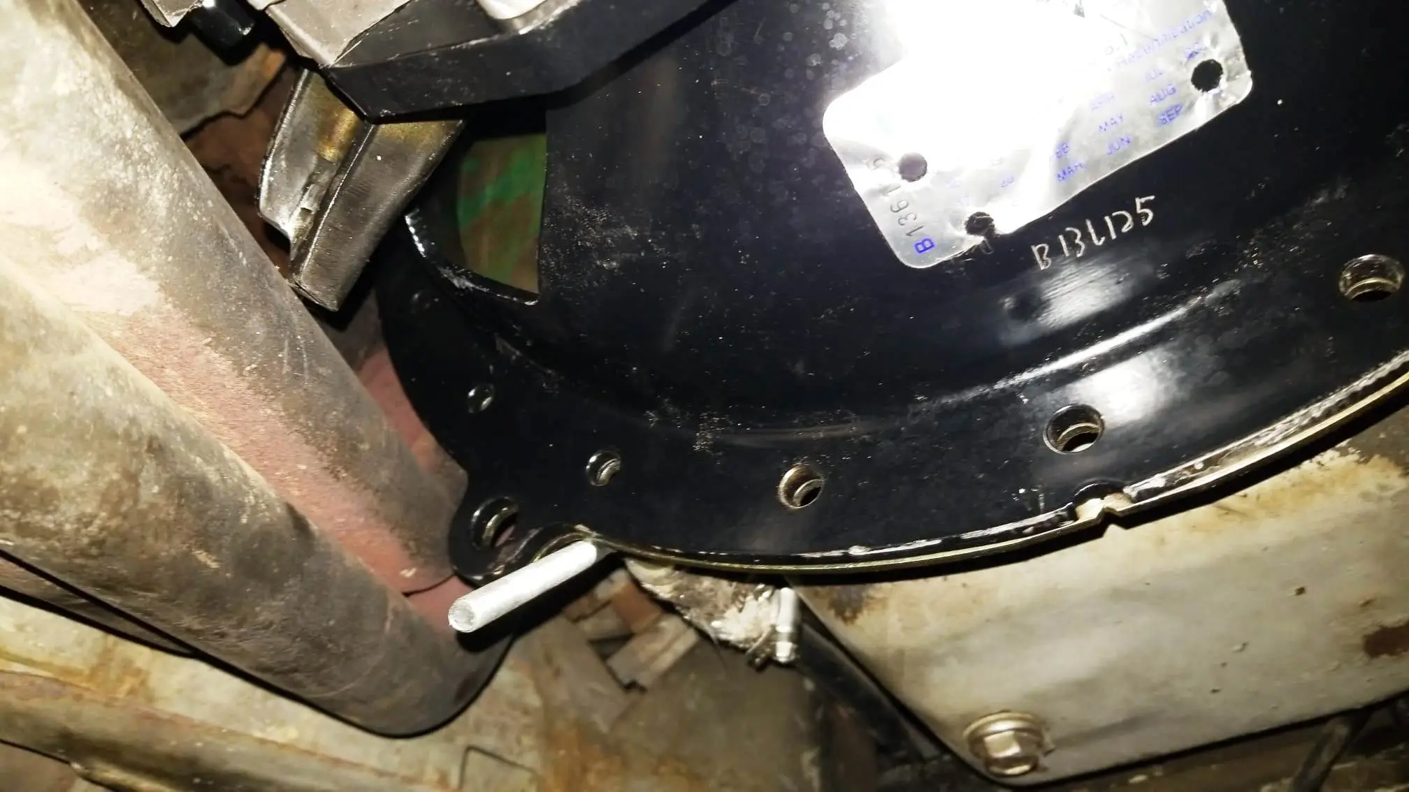

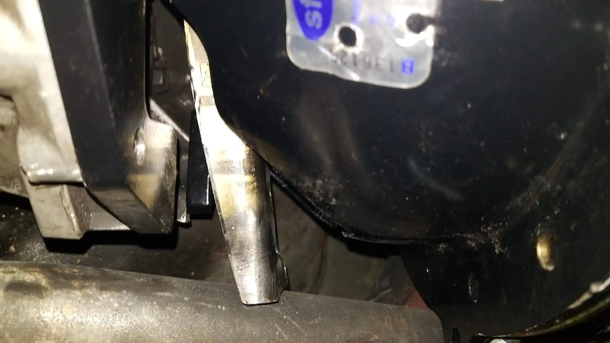

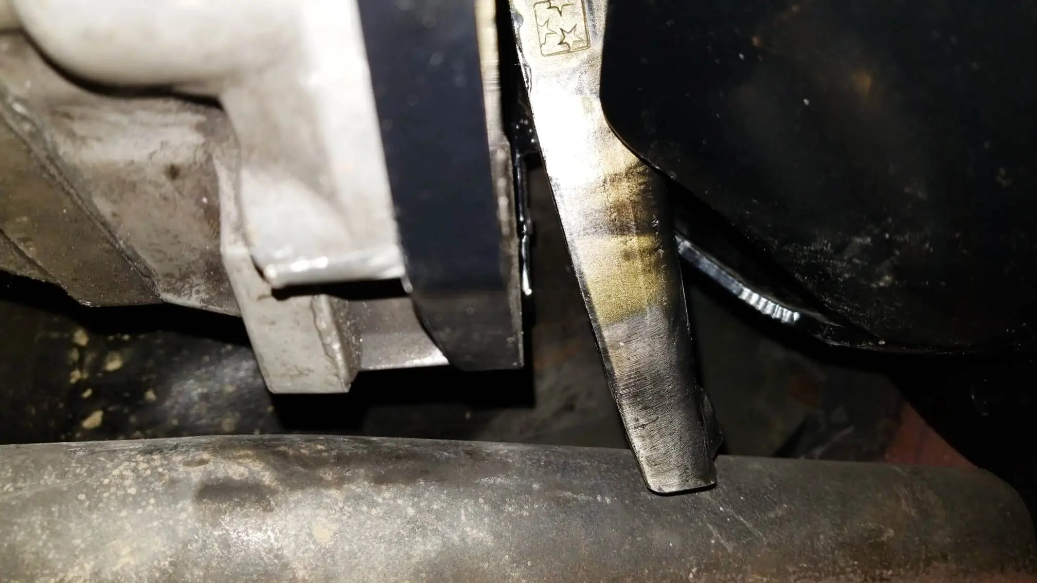

This pic, however, shows that shortening the fork still didn't provide the necessary clearance. My hope is that with a little massaging on the pipes and a little more grinding on the end of the clutch fork, I can make it all work together without resorting to some of the more extreme methods I've read that others have used, such as one post where a guy just used a jack to bend the pipes completely out of the way.
I reached my stopping point for the night, and I'm guessing it's not enough to clear the fork yet, but I think it's good start. Maybe it will work depending on how much more I take off of the clutch fork, and I don't mind mocking it up as many times as I need to. I don't want to do any more damage than I need to get the job done, and I'd really prefer not to punch through the header.
Once I get this part to work, I think the only other potential show stopper with the parts I currently have is the driveshaft length.
I'm moving slower than molasses, but made a little more progress, today. I was able to check the clearance on the pipes, which needed a little more 'love' to get just right. I didn't have dent the tube any deeper, but I did have to account for the sweep of the fork that slants across the tube in its arc:

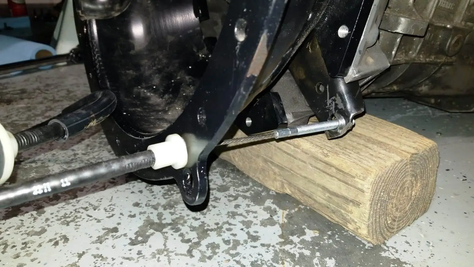

To anyone considering doing this, you DEFINITELY need to shorten the clutch fork unless you're gonna go with a hydraulic TOB. I'm so glad I had this done prior to starting. If you don't shorten the fork, you'll end up having to dent the pipe too much, or you'll have to bend the pipes away from the fork. I finally got a good shot of the fork after it was shortened. Here's a comparison with an untouched SN95 clutch fork:

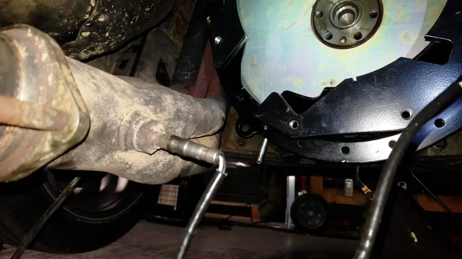

So, you can see how the hole designed to let the crimp on the end of a clutch cable is no longer there, which is no problem for a Steeda cable with a threaded end. You can also kinda tell how much closer the outer hole is to the hole that would typically hold the counterweight, or whatever that piece is. I'm not sure you could achieve clearance without completely choking off the #6 primary. I'm not happy about how much I had to dent the primary, but I really don't think this is going to cause a significant hp-robbing restriction.
After drilling out the bell-housing to reposition the cable's slot, the cable aligns nicely with the clutch fork, and allows travel through the fork's full range of motion:
An SN-95 clutch fork cost me $70, and having a guy cut and weld it cost another $40. So, I'm happy to save on the T56 install vs. a hydraulic clutch.

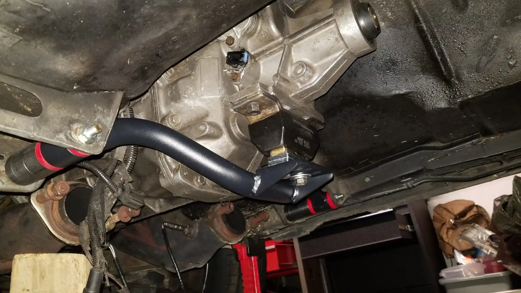

Technically, the T56 is in!
I wish I'd had a spare input shaft every other time I've installed a transmission, because this one slid in, including into the alignment dowels, easier than any other transmission install I've ever done. I didn't even have to pull the clutch fork forward to allow the disc to shift.

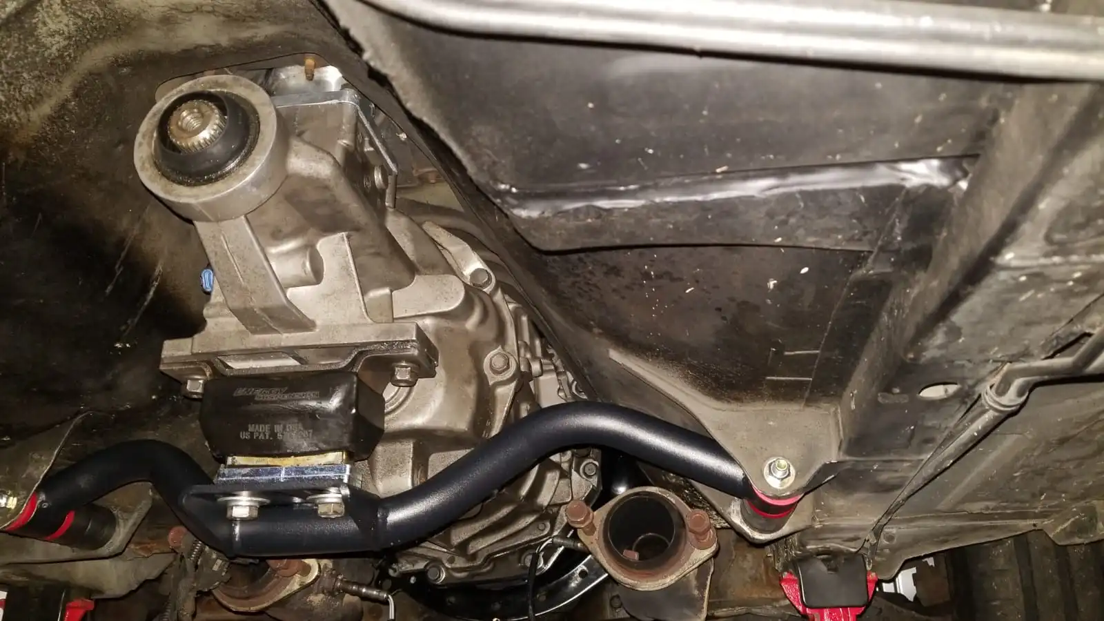

The Stiffler's crossmember was no fuss, no muss, just a bolt up deal! The mount I ordered must've been the one for a T56 Magnum, because the bracket wasn't anywhere near wide enough. Fortunately, someone had already upgraded the T5 to an energy suspensions poly mount, and it went right on. I put both spacers on so they're there when I set pinion angle again. I'm sure it'll be easier to remove them than to find them, lol.
I was also fortunate that the clutch fork pivot ball was already properly adjusted. I'm sure my buddy's set up was about the same.
