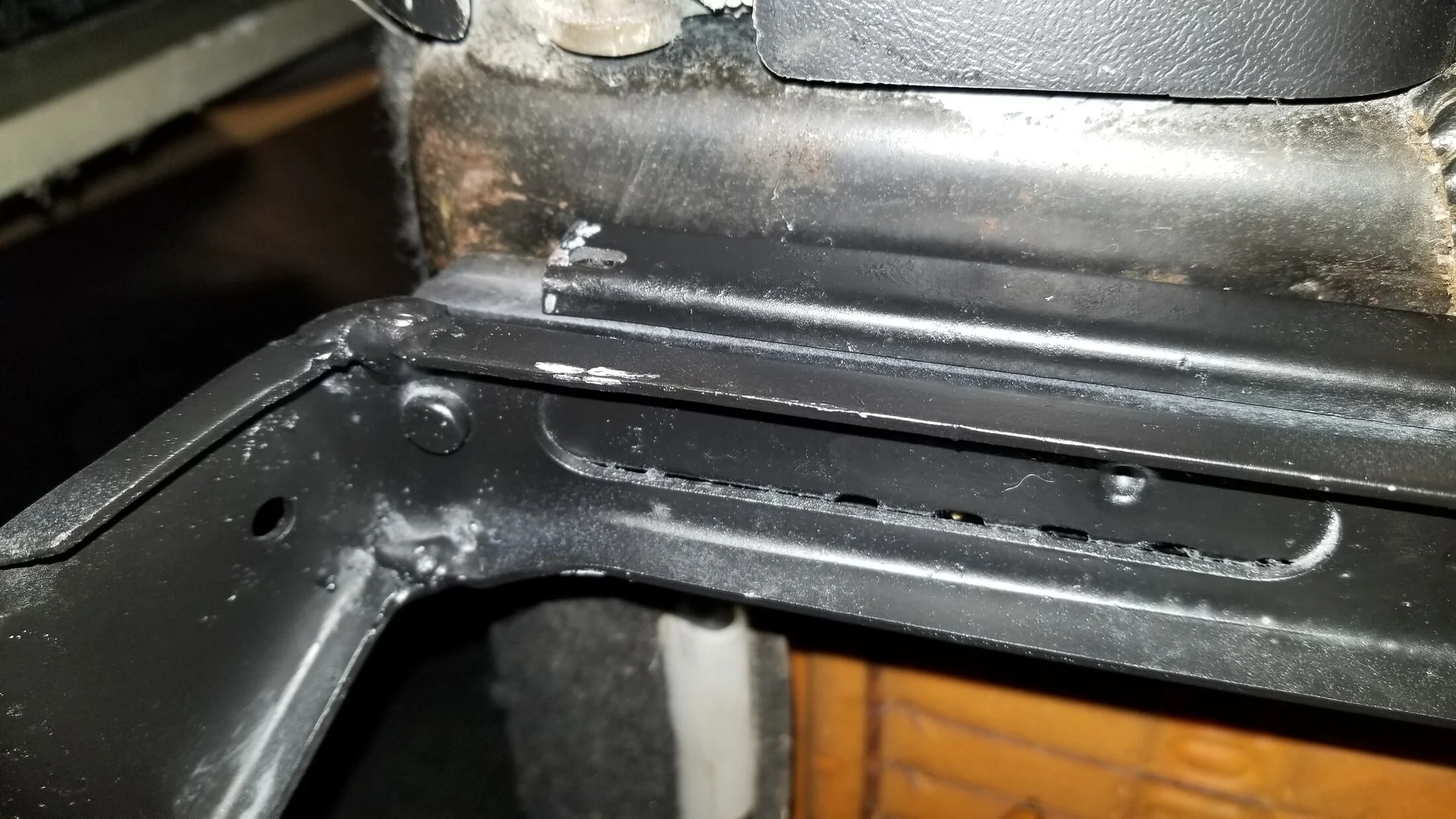

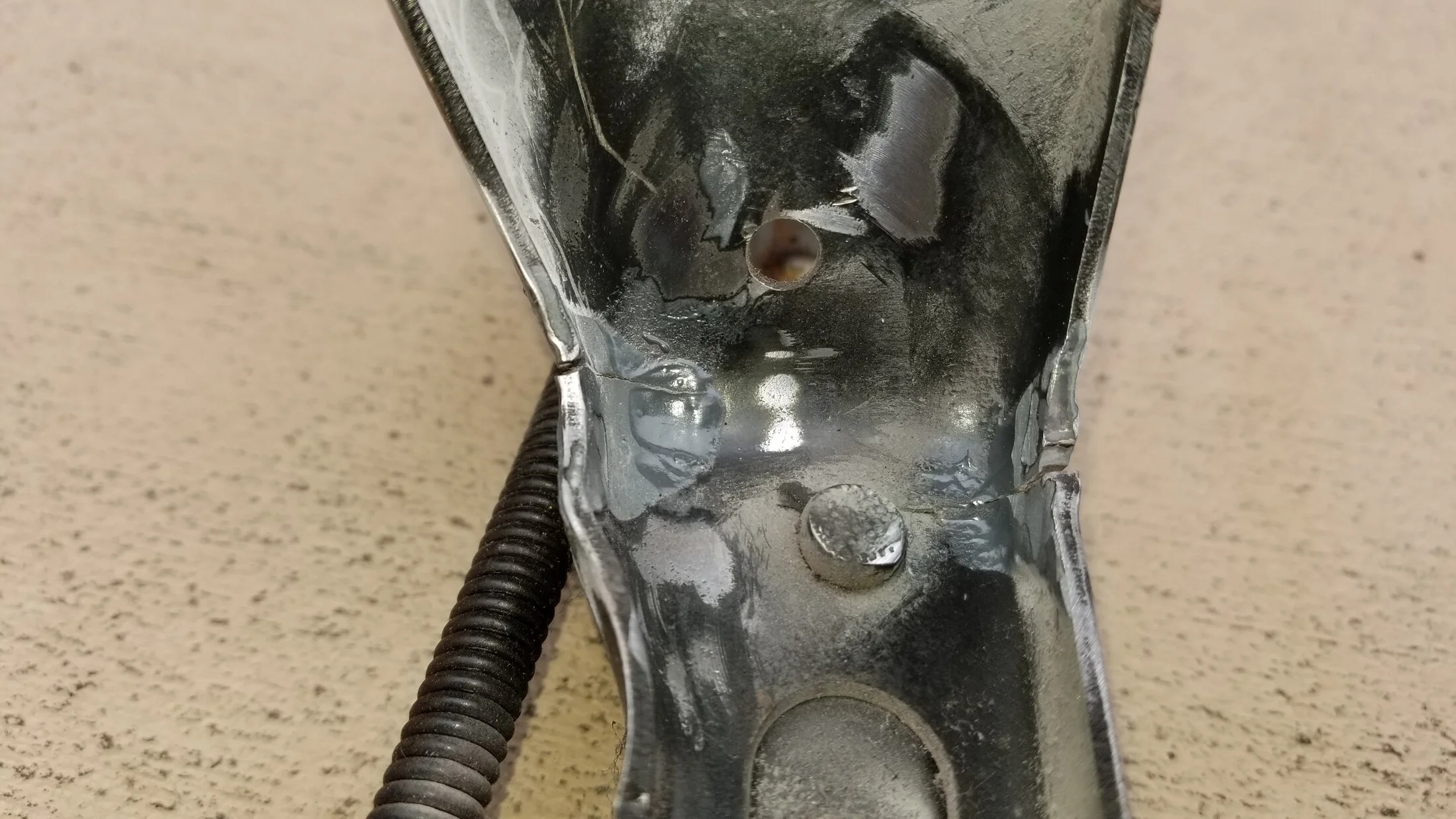

Seat bracket repair:
Got a guy to weld the passenger seat bracket, which I painted and will install tomorrow.
Before:
After:

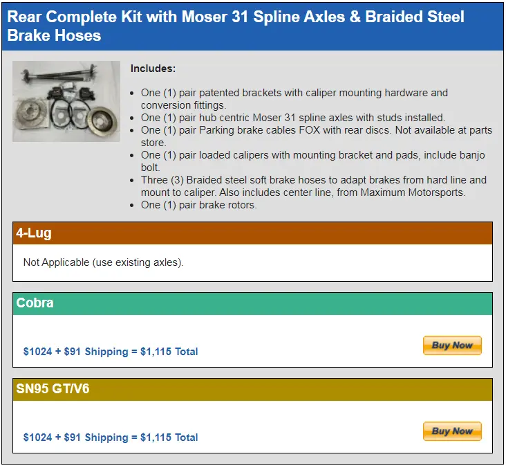

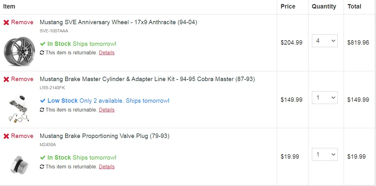

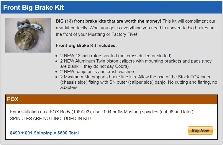

Shout out to foxbodybrakes.com. I didn't buy anything from that guy, but he was so slow, unresponsive even to email, and incapable of being reached via phone that he motivated me to say, "F@#$ it!," followed by "Hi, North Racecars! Send me everything!" Richard there is a wealth of info, and he made a great point about staying with 5-lug -- I can just walk into a parts store and say, 'I need 98 Cobra Brake stuff,' instead of needing to find someone to drill out the 4-lug pattern in 13 & 11.65" rotors. .So, now here's what's coming:
@Mustang5L5 North Racecars said to try my stock booster with the 94-95 MC. I also have the 94-95 spindles, and other than new wheel bearings for it, would you mind looking over the list and telling me what I may be missing. Also, if you tell me to go ahead with another booster or any other part, I'll just do what you think is best. Thanks! I am grateful for the knowledge you provide on this subject to our community. Also, can you clear up my confusion: I asked Richard, after he told me that these are the same as the '98 Cobra setup, if they were 38mm pistons up front, and he said, 'No, they're 40mm pistons in the front & 38mm in the rear.' Your thread shows no such caliper in the front, just 40.5mm for 99+ Cobras. Does that make any sense to you?
You are missing a 1993 Cobra brake booster. 94-95 MC or 93 Cobra MC they both benefit from the bigger booster. Do you absolutely need it? Maybe not but when you are dropping the coin you are it baffles me you would not go ahead and go all in on a proven booster set up.
Reactions: jsgif99
I honestly figured that, but when I asked about it, Richard said the stock booster is fine. Anyways, it's done. '93 Booster on order. Richard also failed to mention the adjustable proportioning valve that does NOT come with his kit. Called back to ask, and he said, "Do you see them on factory cars?" I thought that was a dumb question. I'm autocrossing and tracking, and I want the ability to adjust the rear brakes to the tires I'm running and track conditions (different when wet). Plus, I've appreciated them on my other cars. So, that's on order, too.
Reactions: AeroCoupe
I have his rear brake conversion kit for Fox length axles with Cobra brakes on my T-Bird and it works really well. Both cars have a manual proportioning valve and each one is adjusted a little different.
Reactions: FastDriver
I'm concerned about the MM lines you just mentioned. If you don't see them above, I didn't order them. The master above has what looks like 3 lines (3-2 kit?) that it comes with. The Front kit mentions 2 MM line kits. The rear kit includes a bullet point about lines and another MM center line. If you're saying there's another I need to have, a link would be much appreciated.
