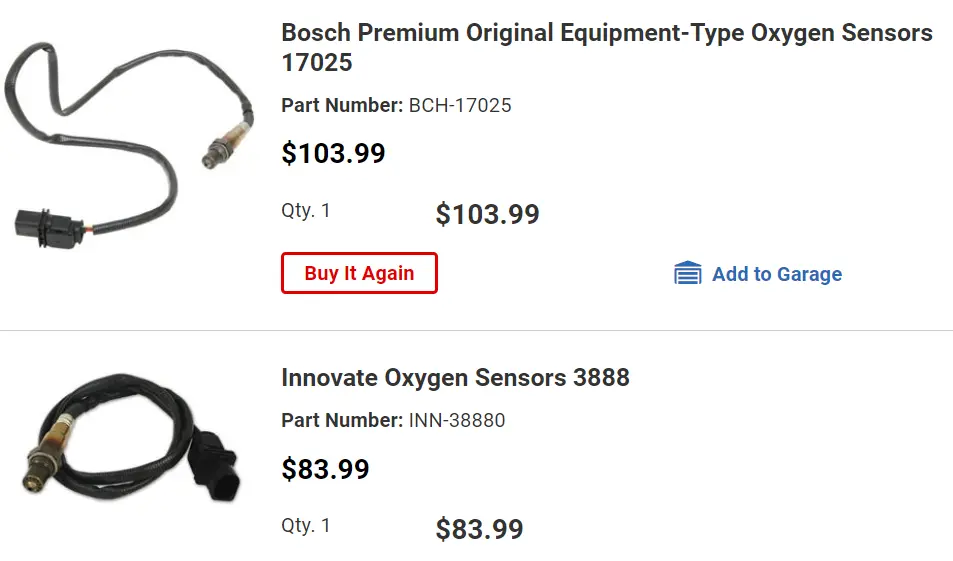

I've always heard that Bosch is the quality sensor to go with. So, I decided to see if it would be compatible. Turns out, they're the exact same part, same connector, but with a $20 difference in price. Now, the interesting thing is that buying from Bosch is more expensive than buying it from Innovate. I hesitate to post, because someone's going to chime in that they're $25 on Rock Auto, but in this case I checked & they're actually $69.99 + $13.99 shipping. So same total cost as the Innovate from Summit. So, ha! Beat ya to it.

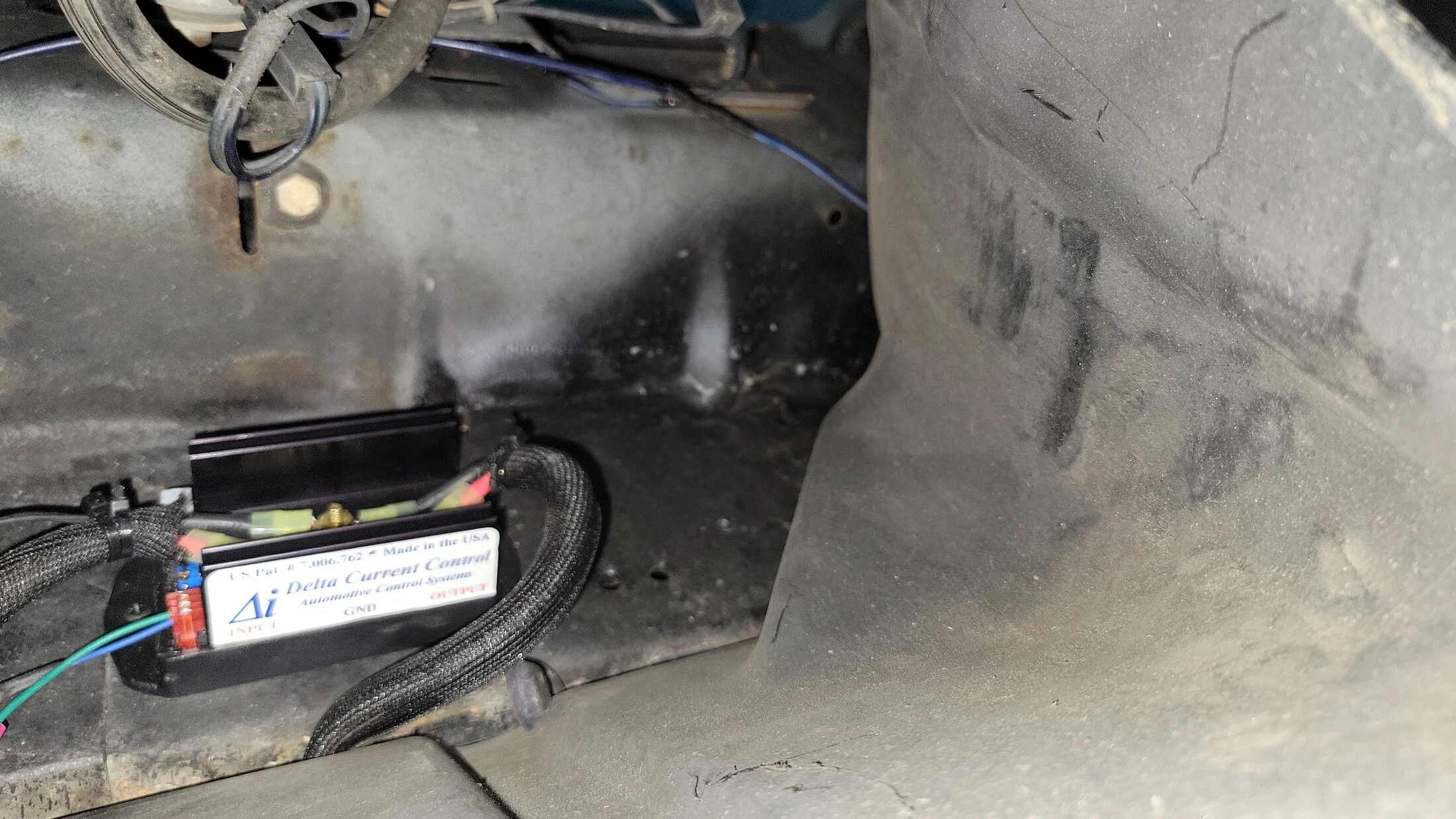

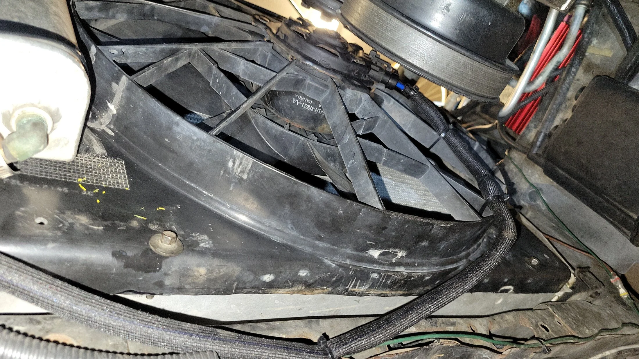

This is what I was up to, today:
This will probably be a part 1 with part 2 being adding a switched 12V source to the green wire, & adding a relay and 3-way switch so I can force the fan on/off or leave it to the DCC.
Testing it out afterwards showed me that the A/C switch is working, and so is the temp sensor, which after a small adjustment seems to be coming on at just above my thermostat setting. That's right where I want it.

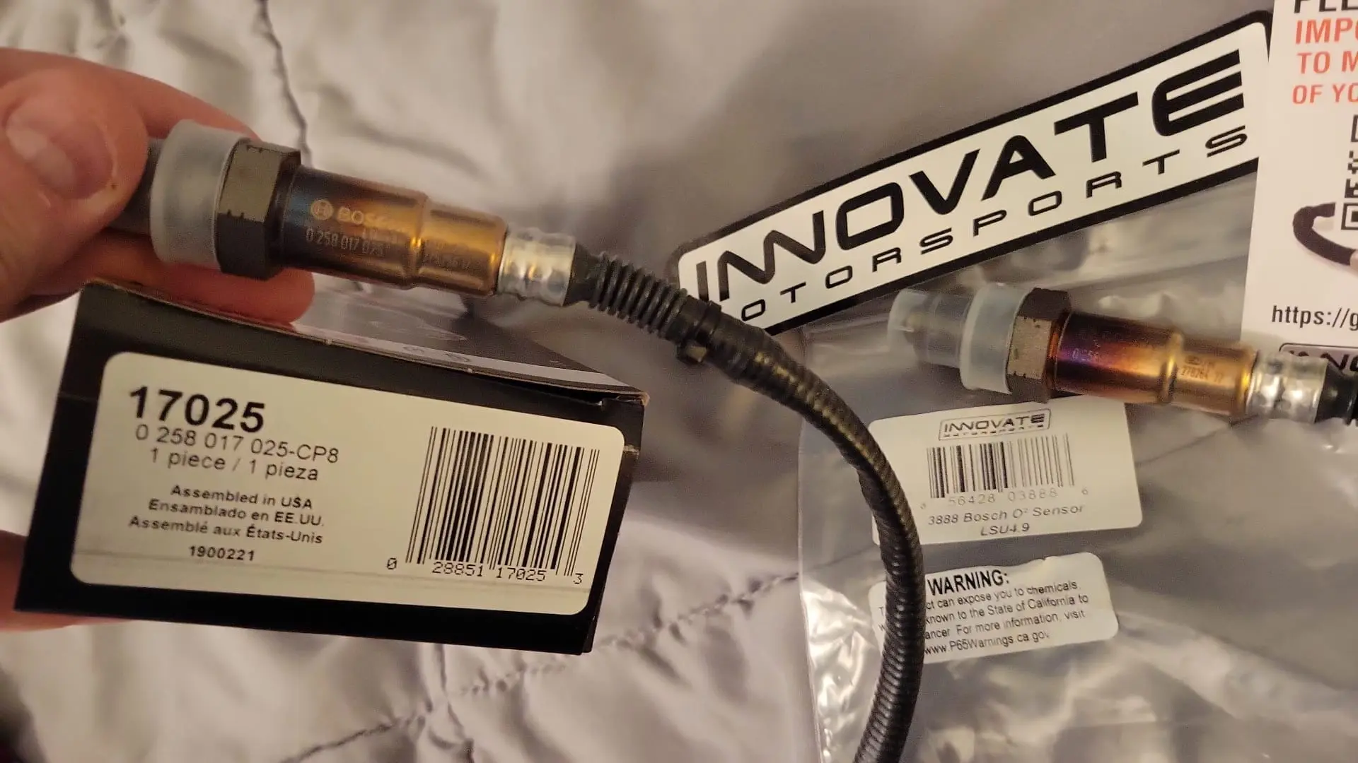

Lately, my 2nd $80 Bosch wideband O2 sensor has been on the fritz. This is the 2nd one in just about 2 months. I remember reading stories about problems like this with Innovate. I pulled it out into free air, and pulled up the carpet to unplug it so I could follow Innovate's "calibration" instructions. I got an E2 error, like the first one before I replaced it. Then, after a few more tries, it started giving me a reading again, but alas, it was bouncing all over the place to unreasonable numbers that would absolutely be easy to feel, such as going completely (up to 22:1) under load. Yet, the car is running wonderfully, as always.
I guess my next step is to talk to Innovate to troubleshoot or possibly warranty.

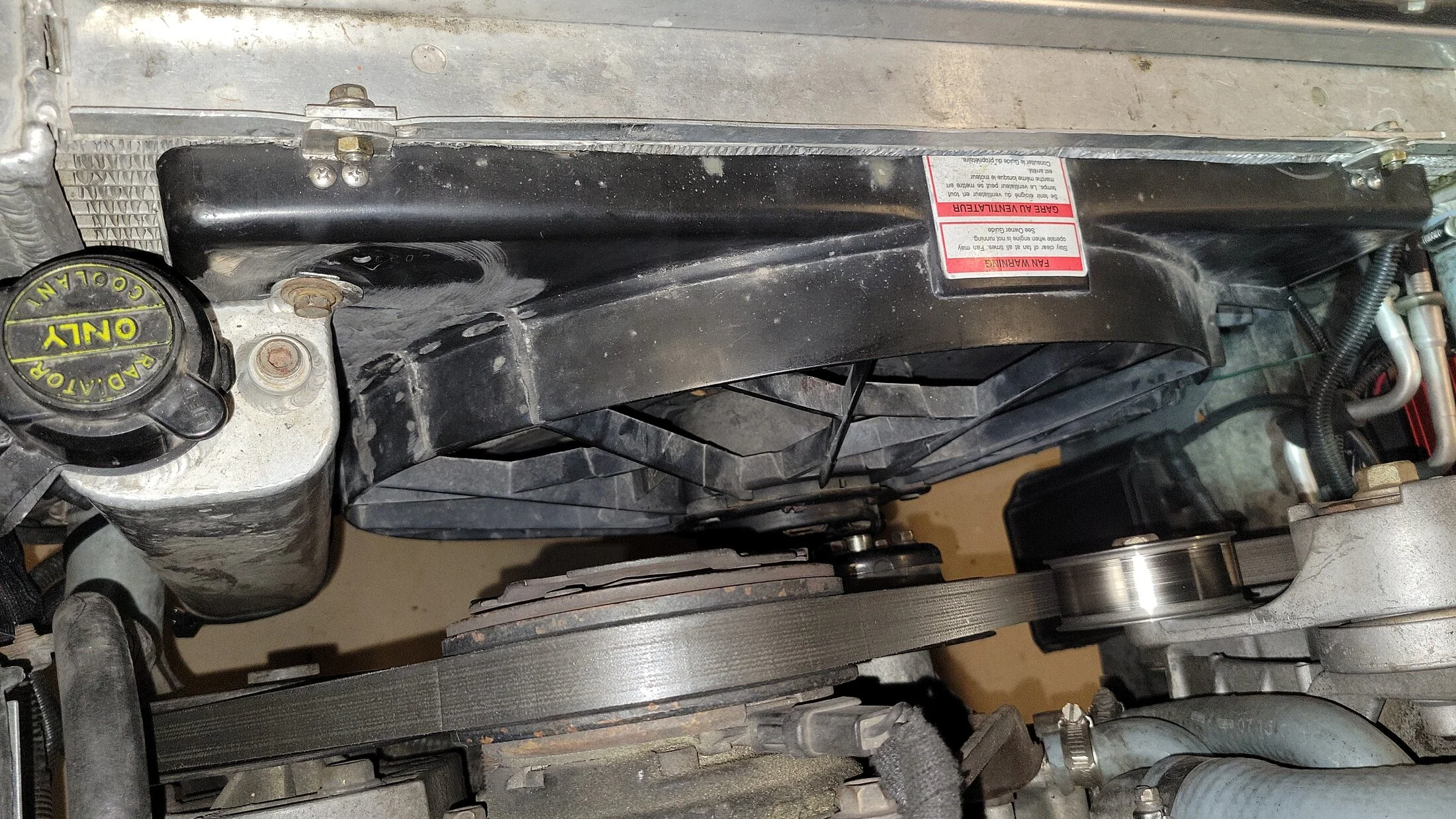

I fought overheating issues on Black Jack early on, when I bought the car originally and again when I bought it back. Both times I did everything I knew to do, all in this thread, before finally giving up and swapping stock pullies on, which solved the issue... well except at idle in hot weather with the A/C on Max.
After installing the Mark VIII fan last weekend, I decided to try my luck one more time and just reinstalled my old ASP U/D crank & water pump pullies. I put an O/D pulley on the alternator to balance it back out. I don't believe in underdriving the alternator. This should give the definitive answer as to whether spinning the fan or the water pump slower was the issue. The electric fan has done well for the past week without any temp problems. Of course, we may have to wait for some hot temps outside to know for sure, but I hope I get the benefits of power & mpg without the cost of cooling issues. *fingers crossed*
edit: 1st day down. Ambient temps around 72*. So, not much of a stress test.
Update Sep' 2025: U/D pullies have been totally fine for coolant temps after E-fan conversion.

So, in just 3 weeks (including a 1k mi round trip to Ohio), I killed another sensor. I just installed the actual Bosch 17025 instead of Innovate's identical-looking sensor. Some part of me hopes that Innovate themselves, assuming that's summit's source, were getting knockoff Bosch parts.
Meanwhile, I'm going to put #3 on order... And, I bought an innovate cable that adapts to an LSU 4.2 sensor. Some stuff I've read gives the impression that the older sensors may have been a little tougher. It's mixed, but since my other cars both run on the LSU 4.2 version, if/when I have another failure, I figured it was worth giving an older sensor a try.
I've also read that it is NOT recommended to allow the sensor to heat up before cranking. Apparently, a hot sensor and a blast of water from condensation in the exhaust is a big no-no.
If none of these things work, then I'll do like many have and swap it for an AEM or some other Wideband gauge.
