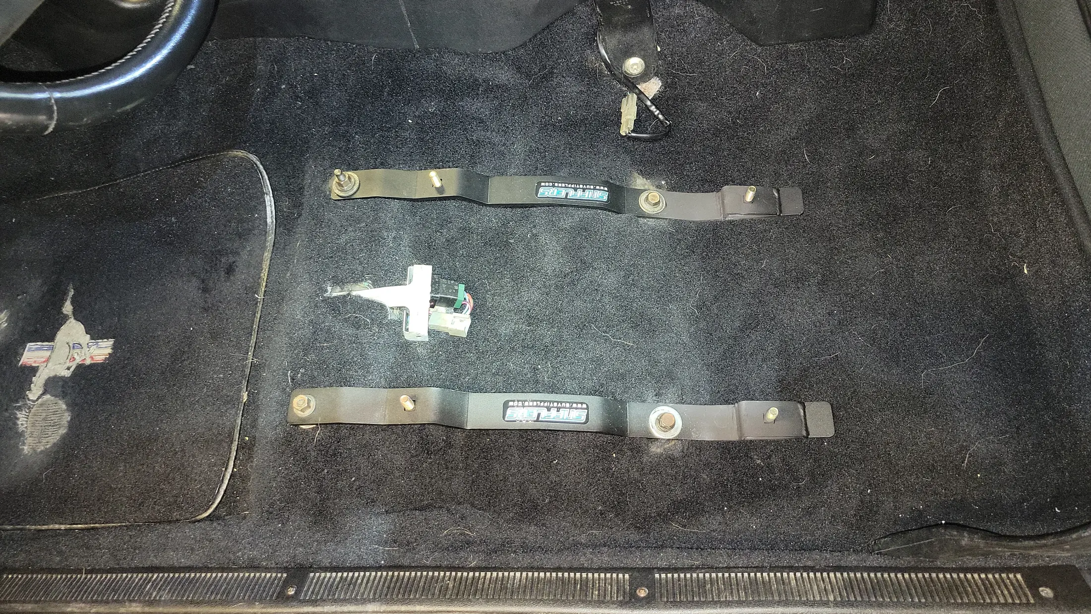

Stiffler's Seat Extender Rails + Corbeau Low Profile seat bracket:
Well, boys, I'm 6'4, and the added height from the LMR seat extenders I used to have that look like this

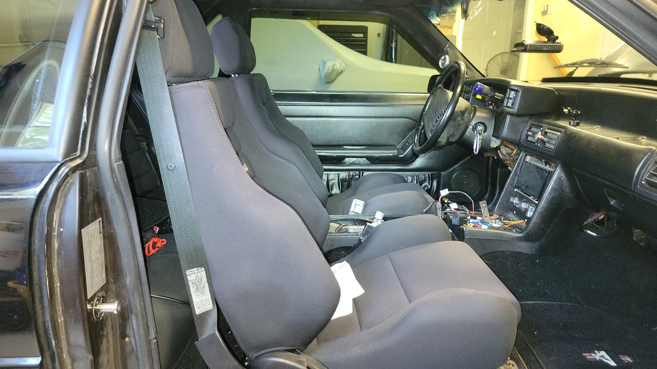

... worked just fine in Black Jack with stock seats. However, when I installed Corbeau GTS II seats in post #331, which are also well-known to raise height an inch higher, it felt uncomfortably high, and put my helmet into the ceiling on auto-x days. This is why a lot of folks have the cushions shaved 1/2-1" to compensate. However, recently, Stiffler's released a new seat extender that caught my attention when ads claimed that it dropped ride-height by 5/8". This, which I now believe is a dubious claim for reasons I'll demonstrate in this post, is language that seems to have been removed from Stiffler's ad linked above, but can still currently be found on resales sites, like:
Lethal:
Beefcake:
So, I put my order in for both 1 set of the $99 extenders and 1 low-profile Corbeau seat bracket ($139). Tonight/tomorrow, I'll try to figure how to install it, along with being hopeful of restoring my emergency brake cable, in one operation. That said, I'm scratching my head on the supposed height drop. I took some pictures to explain why:

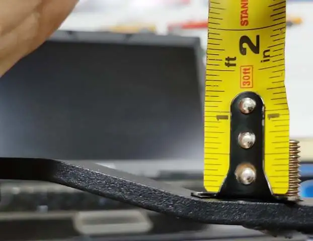

First, the good news, the front seat bracket mounting point does drop, though only something like 1/2", possibly slightly less:
However, the rear mounting point (more aligned with your spine) is ~1.25" HIGHER :cautious:

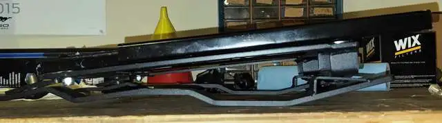

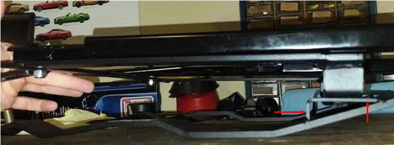

What kinda sucks about this is that the Corbeau braket now does this:
Look at the rear mount area and see how badly angled it is. This isn't something I can just add spacers up front to fix, because this is how much the front would need to come up to flatten the mating surfaces:
So, with the rear mount flat, the front mount is a couple inches above the studs.
Now, if the corbeau bracket was any lower in the back, the rear stud would interfere. However, there may be something I could do, if I can find a welder out here, and I've indicated where-ish with red arrows in the pic above. If ya took a little more off of the vertical part of the mount than the horizontal, you could induce a forward tilt & simultaneously drop the rear slightly more. I think this is what Stifflers should have done in the first place & I don't understand their thinking in raising the back so much. Hell, it almost looks like they could have re-angled the lower bar, and brought the rear mount down to it:
It's not all bad... I have kinda noticed that the corbeau seats with the standard height bracket is a little high towards the knees. So, some tilt forward would be welcome, but this much seems extreme.

Alright... So, I've got the new shifter, seat extenders & low-profile Corbeau bracket in place, and frankly, I'm concerned about how far back it starts, and how high up it would be, if I didn't combine it with a lower profile seat bracket.
To start with, I found a guy in the neighborhood that welds, and after I cut the front of the rear seat-extender rail mounts down by ~ 0.200, he pressed & welded them, which corrected the angle, allowing me to mount them flush with Corbeau brackets. I then painted and installed everything, today.
At first glance, the extender rails more closely conform to the floor pan, which I guess is a good thing:
Height is just about dead even to the passenger seat, though the passenger seat doesn't have the extender nor the low-profile bracket. So, the take-away is that the extender rails & low-profile Corbeau brackets basically offset each other in regards to seat height. Here's the driver's seat (with extender and low-profile Corbeau bracket vs. the passenger with the standard Corbeau standard-bracket bolted directly to the floor pan:
The difference is that the driver's side is fully-forward, whereas the passenger is fully back on its slider. This also gives an indication of how the driver's seat base cusion is tilted slightly forward compared with the passenger seat, which is a good thing. The Corbeau bracket lowers the front more than the rear and so does the Stifflers seat extender rail. Both have the effect of tilting forward. It may be hard to see in the pic above, but it is there. The seat base cushion inclines/tilts more to the front than the passenger side.

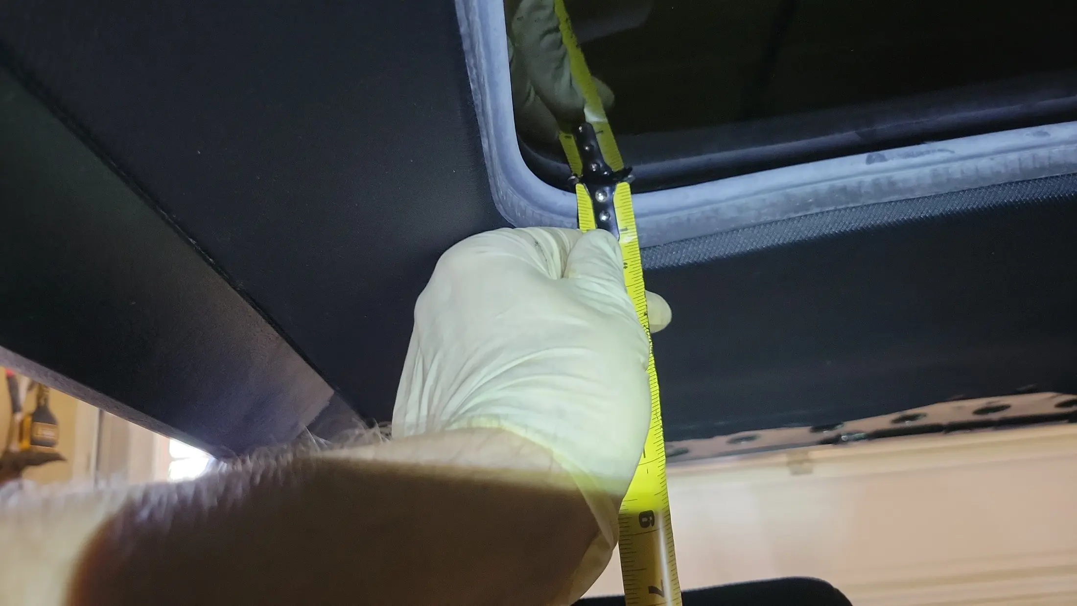

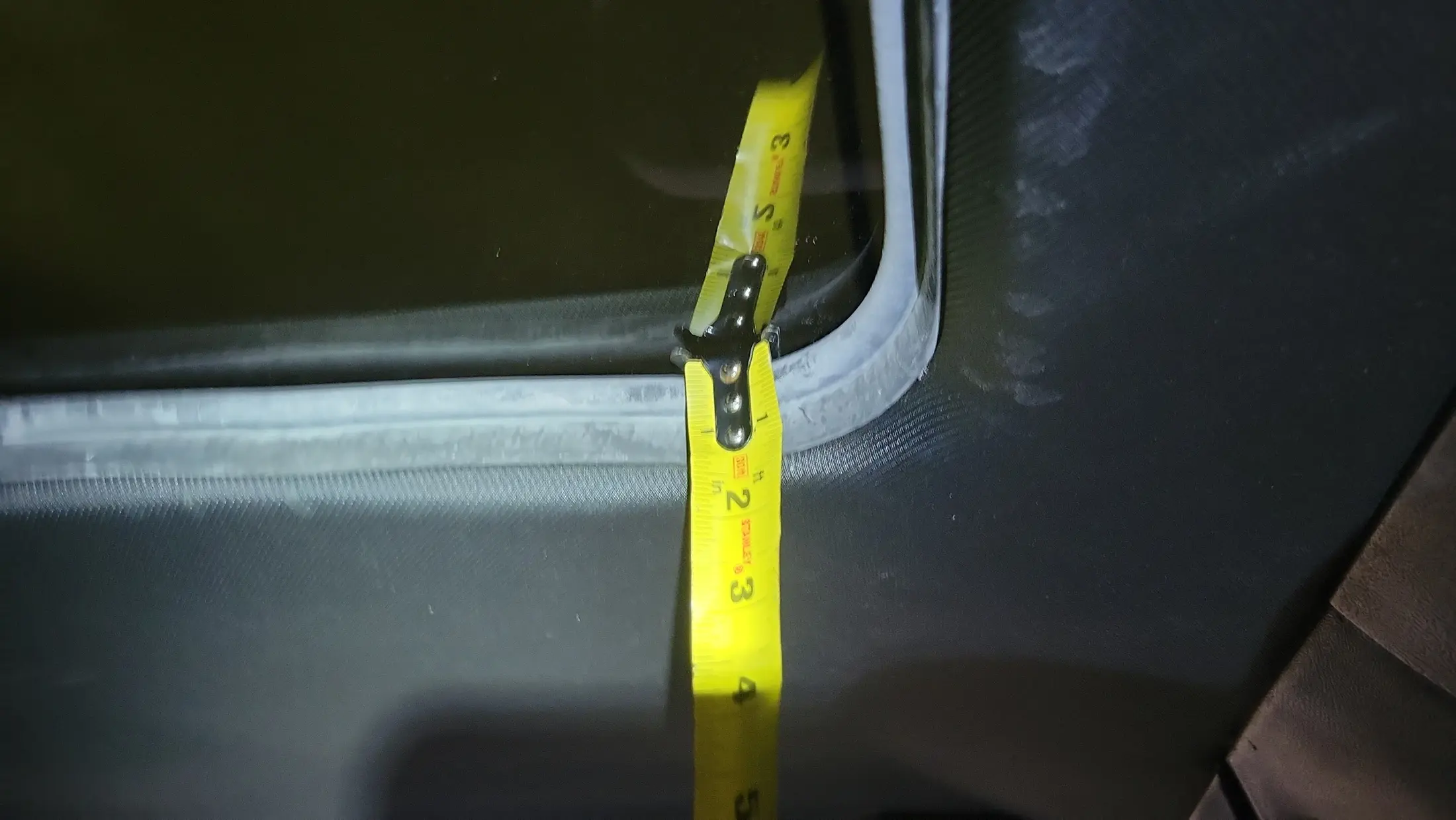

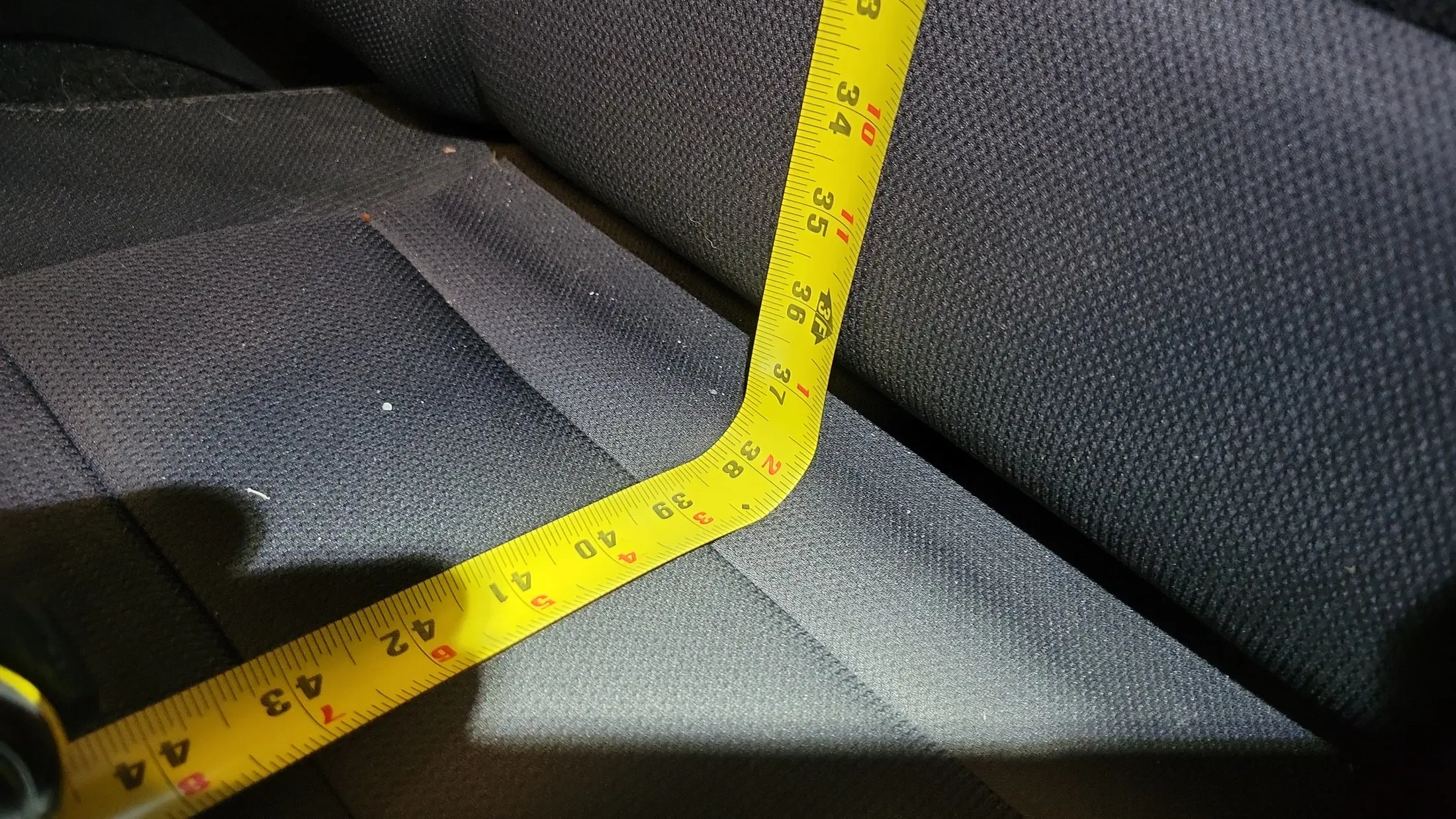

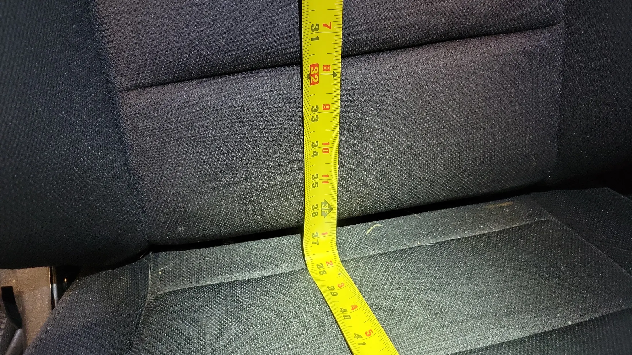

One nice thing about having a moon-roof car (not generally recommended) is that I have a consistent point to measure to:
With the stiffler's extender & Corbeau low-profile bracket, the height from seat cushion (no shaving) to ceiling is ~37.5". Note that the measuring tape is flush with the seat-back and continues straight to base cushion until it curves away, and starts to bend right around 37.5":
Whereas, on the passenger side, it is very close to the same:
I went back and forth at least 4 times. The seating position is definitely within 1/2" of each other, but I think it's very, very close to identical, despite the drop from the Corbeau low-profile brackets.
The conclusion, therefore, is that the Stiffler's brackets DO NOT lower the seated position, in comparison to bolting to the floorboard. In fact, I am certain based upon the measurements I showed above, and the fact that the Corbeau low-profile seat bracket is visibly shorter than its standard counter-part, that the Stiffler's extender, itself, sits higher than the floorboard mounting points, and by about 1".
I also have to say that my biggest concern after installation is that depsite working for me (6'4 with a 36" inseam), the seat in the fully forward position is perhaps not forward enough for focused track & auto-x driving. I wish it allowed ~1 more inch of forward seating position. In situations where I'm really pushing the car, I like to be a little closer than when I casually cruise. When casually cruising, it seems that with the new extenders, my position is 1 to 2 clicks from the fully forward position. I think < 2% of the population is going to feel comfy driving. I should also mention that at full-forward lock... literally nobody is going to be able to comfortably sit behind the driver, unless they have meth-legs:
Now, I no longer have the LMR seat extenders to measure for comparison, but if I had it to do from the start, my best guess is that at my height, the LMR seat extenders are best, b/c they are at least approaching as low-profile as the Stifflers, and I believe that they allow a slightly more forward seating position. They're also ~$50 instead of the the $100 Stifflers. So, all-in-all, if you're shorter than 6'6, I think I have to recommend the LMRs, but you need low-profile brackets or shaved Corbeau GTS IIs. I doubt I'll ever be able to toss Black Jack's keys to a designated-driver, again. I might try another set of the LMRs again, now that I have the low-profile Corbeau brackets, to compare.
ps. The Corbeau's are an unusually high-sitting seat, and that makes a big difference. Mileage may vary with other seats, and I would buy them again, but only because I pickedthem up with rear covers for $300 out of pocket after selling my worn black stockers. I got a smokin' deal on them, but stockers sit lower, and my Recaro SE's sit even lower still. The SE's are genuinely the best fox seat I've had the pleasure of using. Soft & comfy, yet supportive bolsters, low, even with a standard Corbeau bracket, seem to sit further back on the bracket such that full rear lock takes everything I've got to fully depress the clutch pedal. Here's the SE's for reference, and they are worth the money:

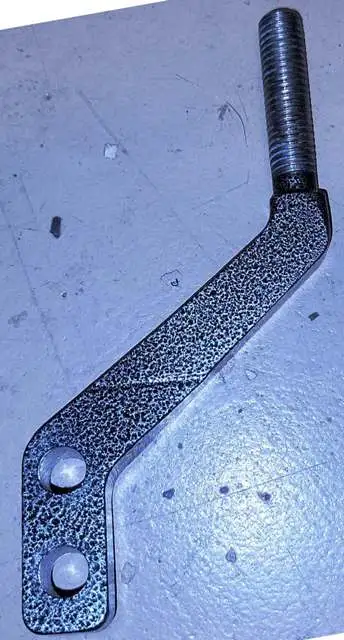

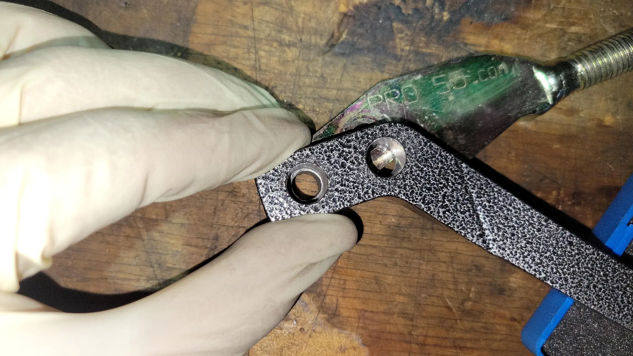

Pro 5.0 offset handle:
The Pro-5.0 handle yields about another ~1.5-2", and make shifting from a more rearward seating positions slightly nicer. However, there are 2 things you should know if you're interested in getting this handle. 1. The stock Pro 5.0 handle has narrower bolts:
... and, so as it turns out, you'll need to drill out the base stalk that it mounts to with a 3/8" drill bit to achieve the diameter needed for the new bolts that are supplied with the handle.
On the test drive, I liked the handle with my new seating position. If I'm being super picky, I wish the angle of the handle, at the top, was the same as the base Pro-5.0 shorty handle. And so 2. when shifting to the forward-most gears (1-3-5), the handle leans ever-so-slightly too far forward. That said, that's being super nit-picky. The handle is clearly better than the base handle would be on its own.
