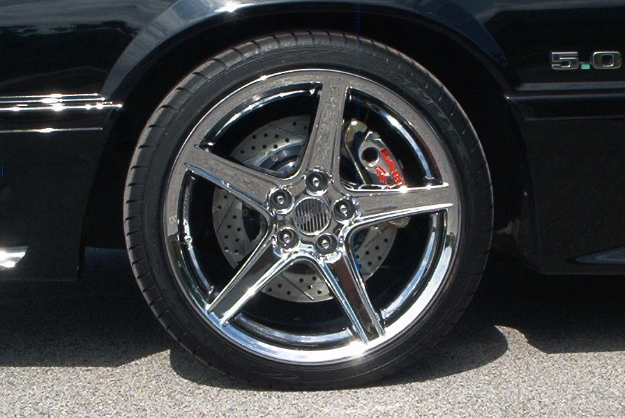

are those 18's? and what brake setup are you running? im really scared that the offset wont fit right, its a 24mm offset and 5.85" backspacing.
I am running the Baer setup. For the most part, it maintains stock track width at front and rear. The wheels are (4) 18x9" authentic Saleen front wheels (25mm offset). What are you using for spindles, k-member, and rear axles?

jmd2914 said:
stock k member, svo/lincoln five lug/4wheel disk setup

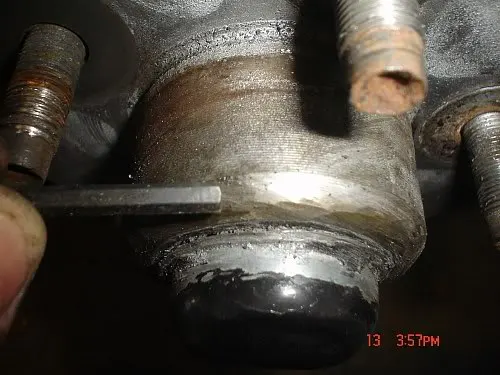

For the front, the wheels won't sit flat b/c you are not running the sn95 spindle setup. You will need to remove/flatten the dustcap and also grind down the lip of the hub portion of the rotor. Corral has a good thread on this, I'll see if I can find it.
EDIT: http://www.corral.net/forums/showthread.php?t=673038
As for the rear, if you are running stock length axles then you won't have any clearance problems with the 25mm offset - assuming you aren't running oversized tires.

You should be able to ditch the centercaps and run the wheels. You will still have to grind the lip to have it sit flat.
jmd2914 said:
its been a long day at work so im not really following why i will have to grind the lip to get the rim to sit flat
Because the lincoln rotors extend too far. Check the link I posted on the first page - it explains everything.
