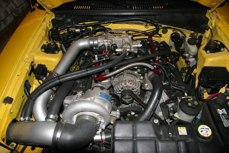

Here is a pic of mine. The big hose closest to the supercharger is coneected to my BPV which is hidden upside down.

i believe with your blow through set up your bov is before the maf....if so just make it go right back into the power pipe. i am not that familiar with blow through setups but that should be fine. if the air isnt being measured yet it doesnt really matter where you put it as long as it's before the maf.
Thanks again..
doing that should make it quieter than having it go to the atmosphere?

You will basically hear nothing at all. You might have a woshing sound if you get into high boost and let off but you wont hear any thing when you shift or if you get into low boost and let off.
Make sure when you drill the hole into the intake its about 1.5" in diameter. You want to have a big enough hole so air wont get backed up and cause surging or blow pipes off. I don't know how many times I blew my intake pipe off when it was 1". LOL
