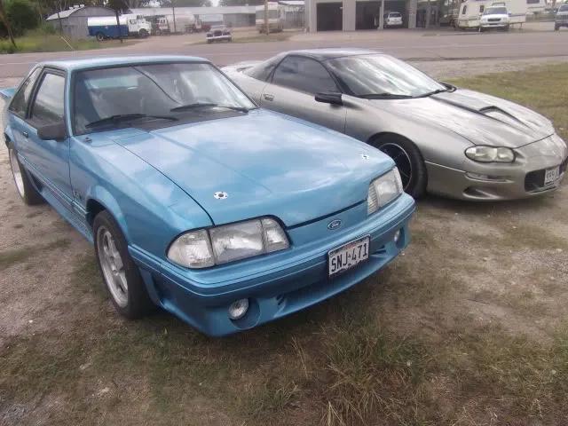

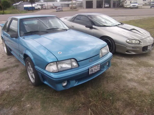

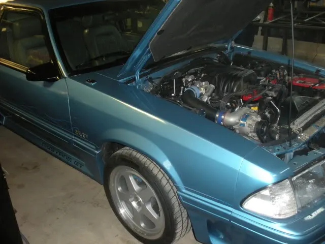

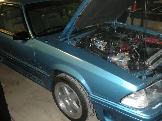

Here are couple pics of teh car, actually dont have many right now of teh car itself. We are not real big on teh color, but it's a fresh repaint, and was done right (all trim and everything pulled, so no overspray, no orange peel..they did a bang up job). Its pretty dirty in this pic as well:
This pic is underhood shot before I began upgrade on fuel system/meth kit/etc...(close inspection, and careful eyes will see the floor of 25.2 rollcage starting to take shape in background and is going in a '99 Camaro)...
