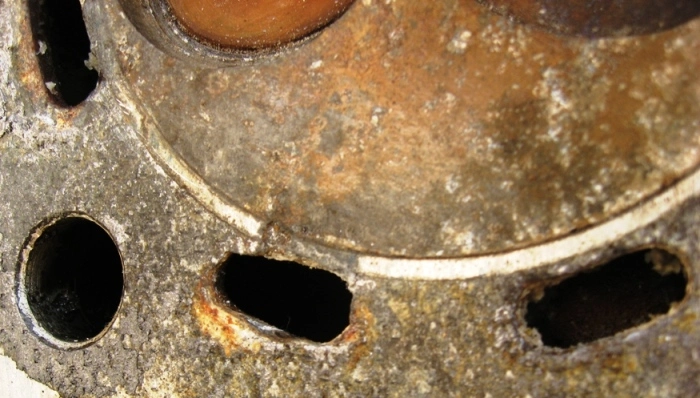

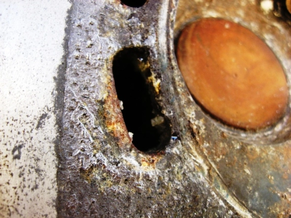

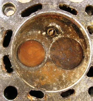

I took off my cylinder heads this morning to replace a suspected blown gasket on the passenger side. These are my finding after removal:
1. No issues on the driver's side, i.e. the head gasket is in good shape with no signs of leakages, the cylinders and the spark plugs look clean.
2. Passenger side: cylinder 3 (the one closest to the firewall) found with water inside with signs of early corrosion, the gasket had signs of deterioration, the coolant ways on cylinder head was found in the condition as shown in the pictures.
I know that 3.8's are notorious for this problem and I was ready to replace the gasket. However, looking at the head I may need to either take them to a machine shop or get a new one :shrug:
Appreciate any suggestions.

IMO, you should take it to a machine shop and get their professional opinion. However, at the end of the day, something will have to be done. It makes no sense to use the head in it's current condition. It will just start leaking within a short period of time.
Wasted time, effort, and $$ along with a generous dose of hair pulling will be the result.
How long was this condition allowed to continue? Can't help but wondering if it was too long.
Hate to bring bad news, but I suspect that you already knew it anyways.

Hi,
That head has leaked for some time judging by the corrosion around the entire perimeter of the gasket surface. The coolant passage noted is a bit too close for comfort although likely it could be repaired with laser welding in the coolant channel to get the correct land width back , you could probably pick-up a better head for much less than the cost to weld & re-machine the surface. Head skimming on a 3.8L should be O.K. since valves & compression ratio are low anyway. If it were mine I'd look for a replacement head (or better still; pair of heads).
ATB Aeroman

It took me a while to find some time to continue the work. I took both heads to a machine shop. The passenger side could have been re-manufactured but I didn't like the price. They quoted something like $ 100 for welding, then it would take machining, cleaning the valves and changing the valve gaskets to get the head into a decent shape. So I scrapped it. I got a head from a '97 stang in the junk yard nearby. Got it checked in the machine shop, machined the mating surface and changed the valve gaskets. It cost me $ 60 for the head and another $ 40 for the work.
I had another look at the driver side head. It was not that good as I had thought initially. I got it welded in one or two places, machined and changed the valve gaskets.
