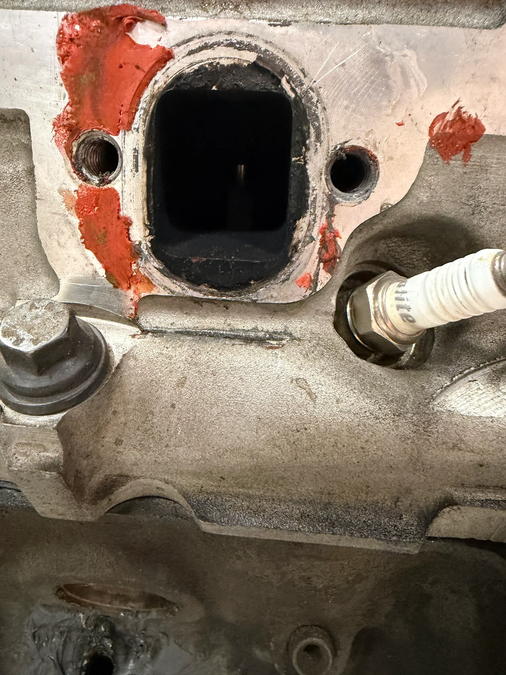

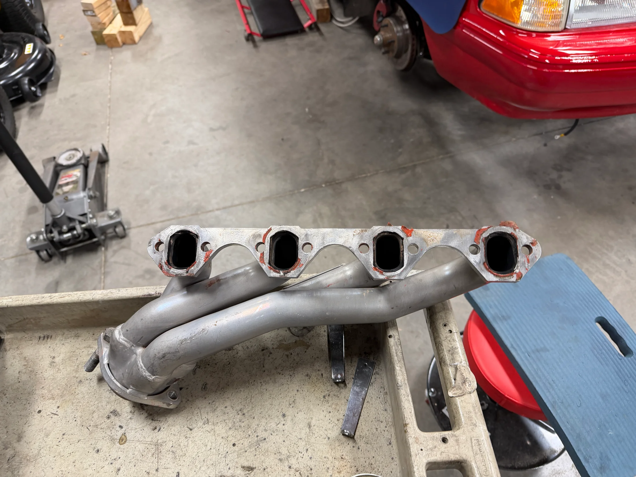

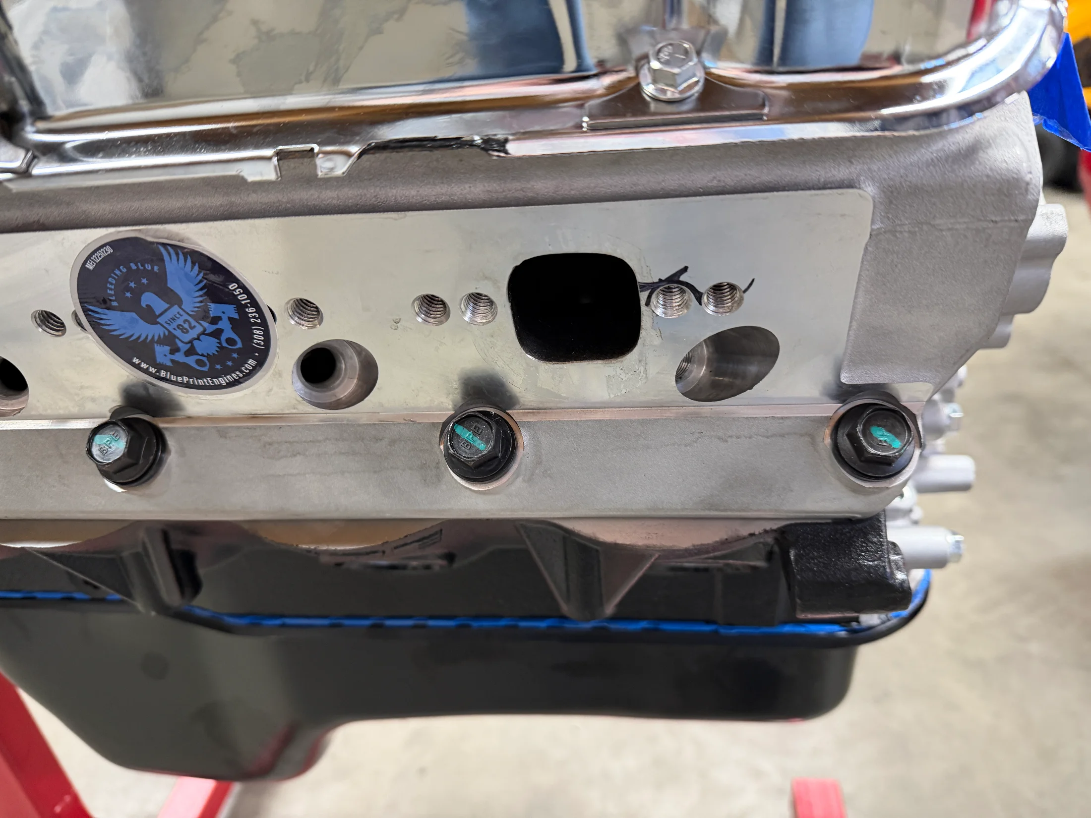

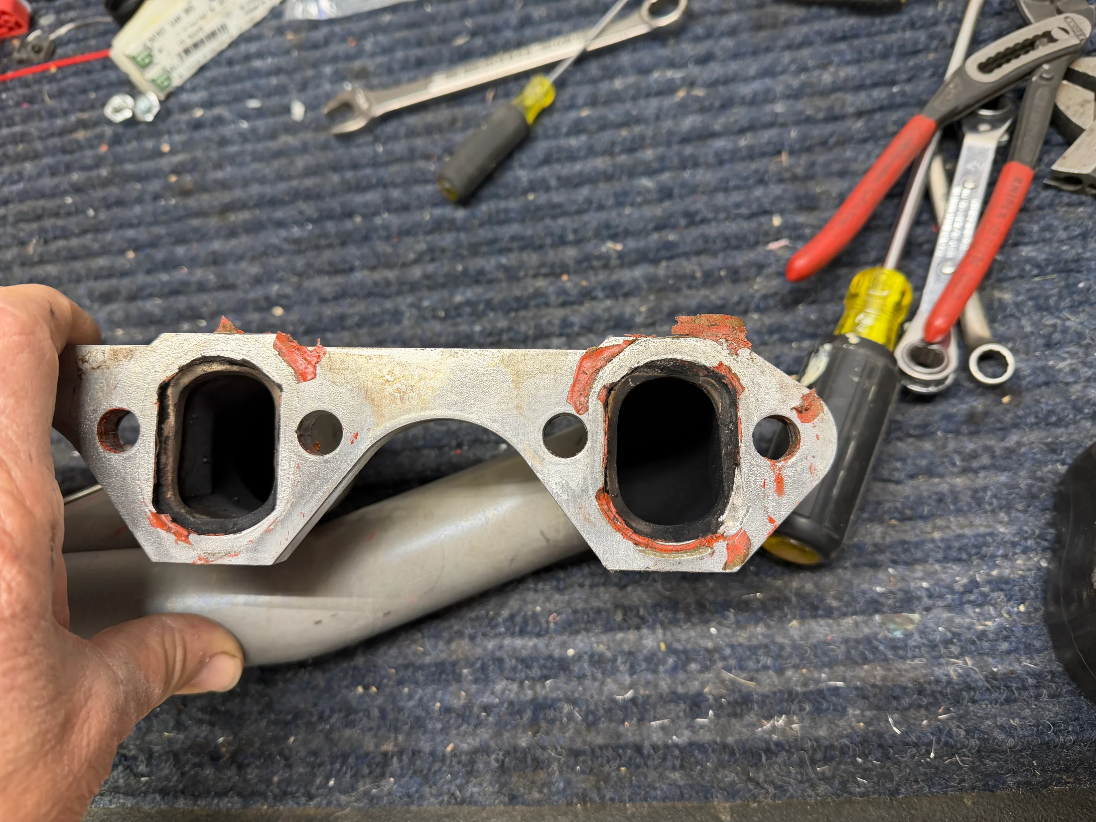

Old motor is out, and I've been gathering parts and cleaning things up before the new motor goes in. I got around to test fitting my 1 5/8" BBK shorties on the new engine and noticed the ports on the new heads are square, and my old SVO Ford aluminum heads are more rectangular. Looking online, it looks like square exhaust ports are typical for aftermarket heads, and 1 5/8" headers are more rectangular shaped. They fit fine on the new heads. So what am I missing here? I really don't want to or think I need to go to a 1 3/4" primary. So am I just overthinking this and just bolt them on and don't worry about it, or is there a different 1 5/8" header that's better fitting?

They will fit and work fine, exhaust face on the bpe heads are flat, so should probably seal better than on the old ones. I actually use a modified LS 1 7/8" swap header with those casting and the outside 3" bolt pattern vs the oem ford one, but I ported them a long time ago and was complete budget set up where I built the heads out for under a grand, many switched to a more D shaped exhaust port years ago copying afr's stuff. That casting is branded by many even afr as the enforcer and most don't have any issues making decent power with it. Even the cheapy 100-150 China stainless shorties everyone sells now will work fine on those, some of the shorties just have way more of a square/ rectangle crimp at the port than others do and yours seem to haves a real heavy crimp to them from the pic, how old are they, bbk has changed their shorty design a few times in the last 20 odd years, last one resembles the P headers with the swooped out number 5 primary. Either way I wouldn't worry about to much as long as it seals.
They're the ceramic coated ones I bought off LMR about 8 or 9 years ago. They are holding up really well and I'd like to keep using them. The welds in the ports were really heavy when I got them, so I did grind them down and smooth them out some. I may get a little more aggressive with the welds and smooth them some more. Thanks for the info. :nice:
