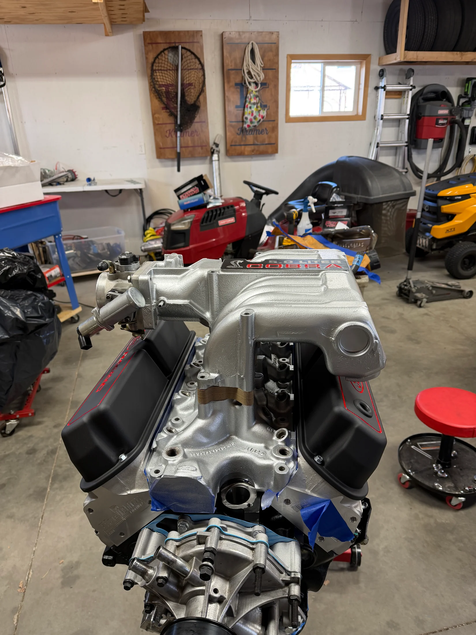

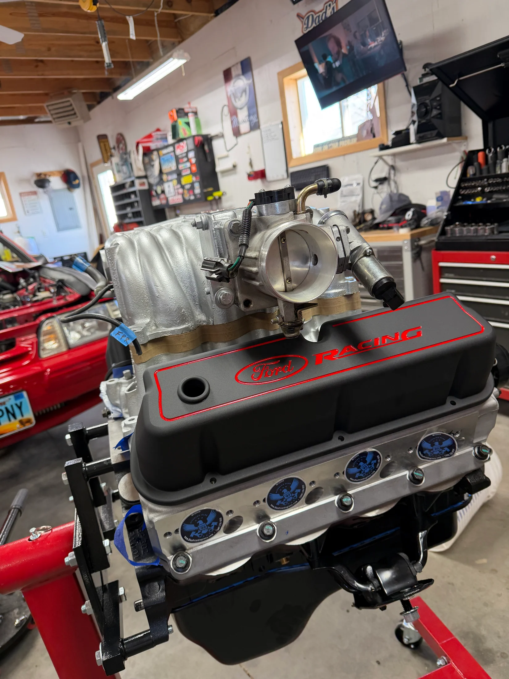

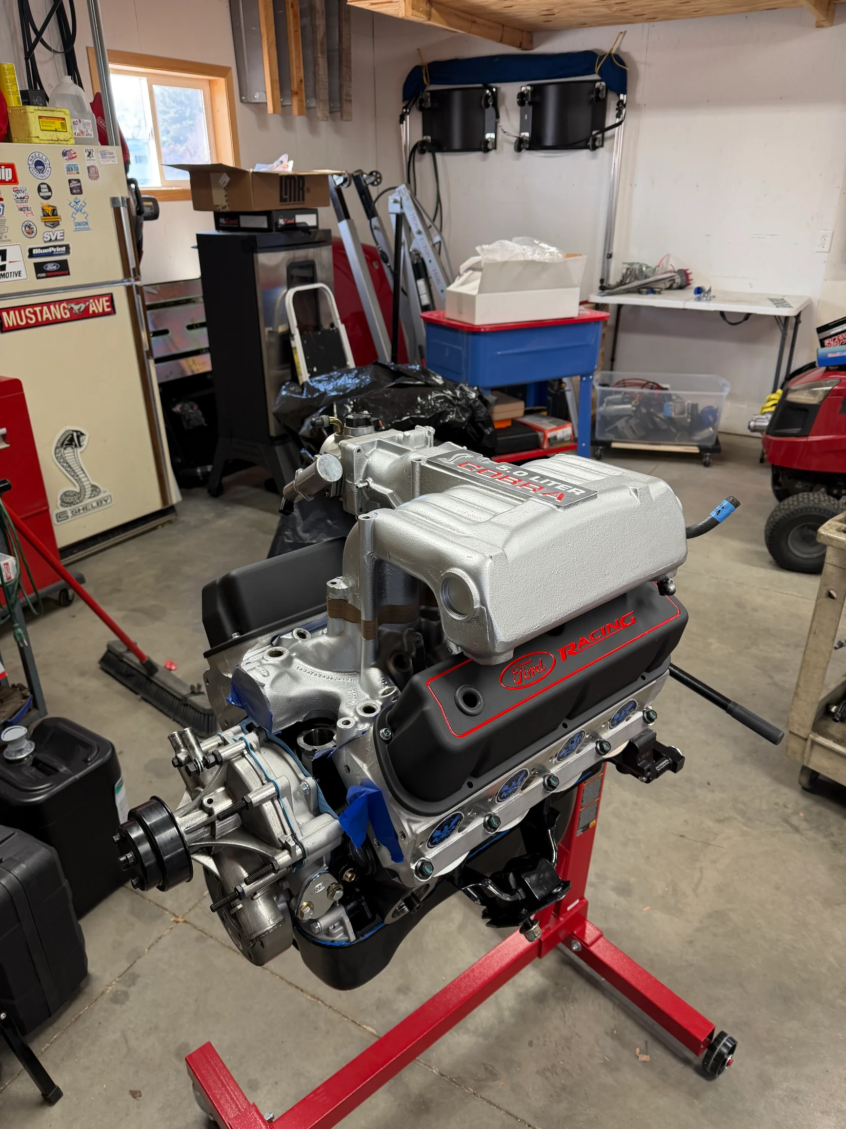

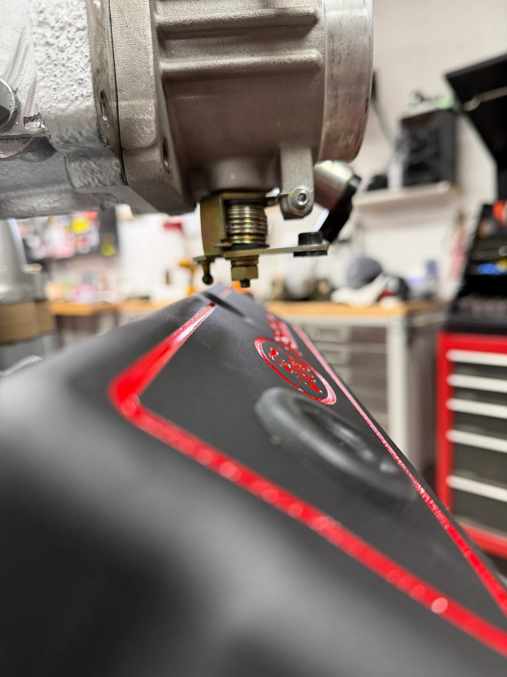

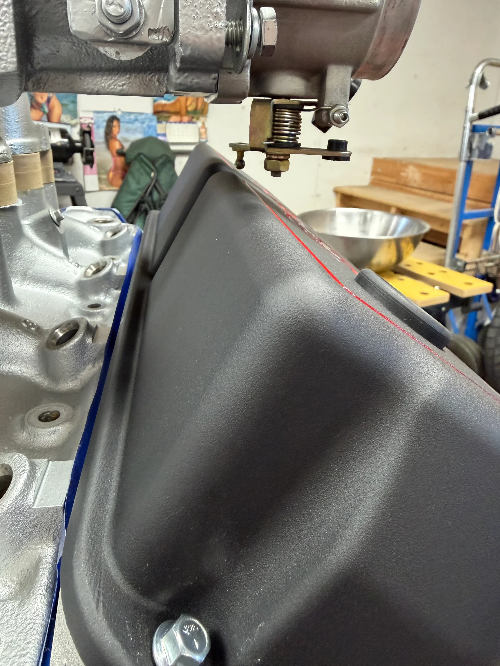

So Santa brought me the valve covers I wanted. I got a 1" spacer because I knew I was probably going to need it. I mocked up the intake with the covers that came with the motor and had a little over an inch of clearance, so I thought these would work just fine. The sheet metal ones that it came with are about 3 1/2" tall on the header side and about 2 1/2" on the intake side. Of course I couldn't find any exact dimensions for the new ones, but they're about 3 1/2" on both sides. There's no gaskets under anything yet, but man is the throttle linkage going to be close. Do I need to go to a slant edge cover? I don't really like where the breather holes are on those. What other aluminum covers have similar dimensions to the sheet metal ones?

I would not worry [too awful much] about the the breather holes...
I would imagine that there are baffles under each of those holes?
If so, you can stuff an elbow in there along a length of hose and put the actual breather into a bracket virtually, anywhere you like.
What throttle body is that? I have a 70mm BBK with the Motorsport valves covers with a 1” spacer and zero issues.
Wanted to add that the upper and lower are Edelbrock Performer RPM II’s.
The holes on these are fine, I was talking about the slant edge version covers. I like these, just wondering about this clearance issue.
It's the 70mm SVE. I think I have a 65mm BBK in my parts box. I'll have to see if it's a little shorter. You don't happen to have any pictures of your setup?

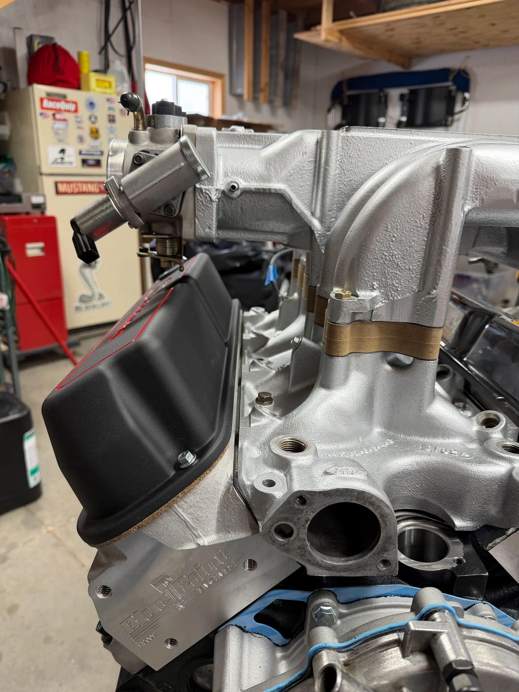

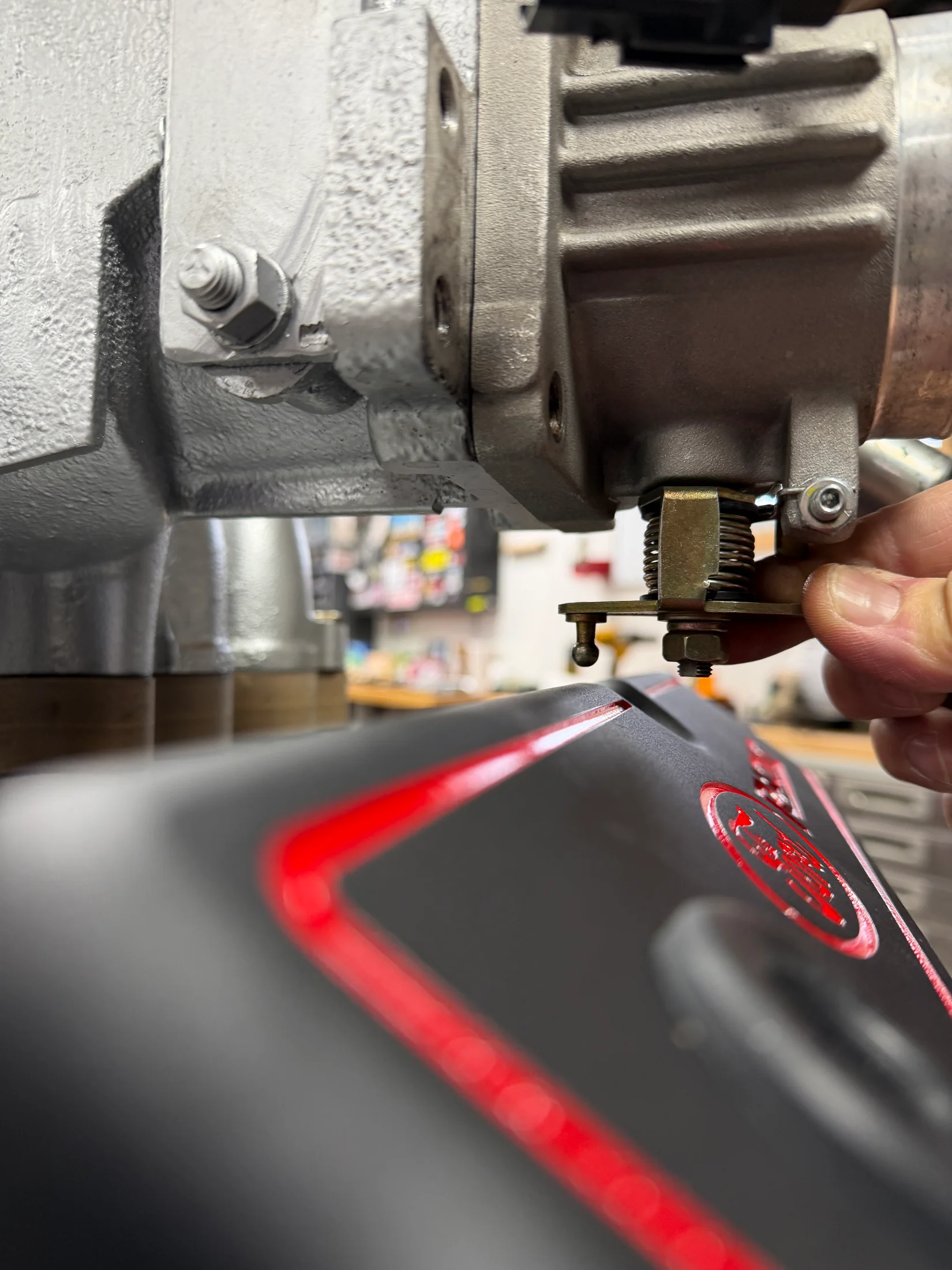

Mocked everything up with all the gaskets underneath and it looks like I can make it work. Friend of mine is an old racecar fabricator. He says he can make me a new throttle cable bracket and we can flip the ball stud to the top side of the bracket if necessary. Clearance does look a little better with all the gaskets in place though.
