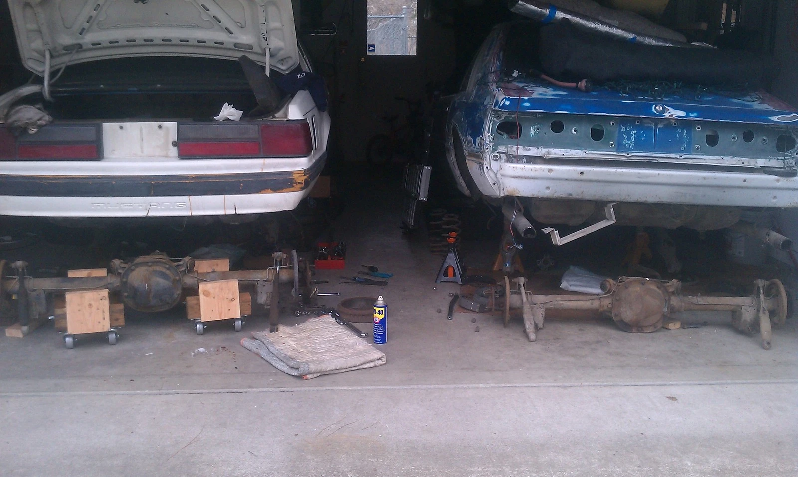

i gotta 89 GT motor and tranny to put in a 90 GT Body, i have both cars, the 90 has no motor or tranny, its an automatic body though. Gonna be my project for a while!
Sounds like the circus I have going on in my garage too!
Started building an 87 T-top and decided it wasn't worth the investment because it was too f*cked up so I bought a 5spd 88 Coupe 5.0 w/ no motor or trans. Swapping parts from one to the other as well.
