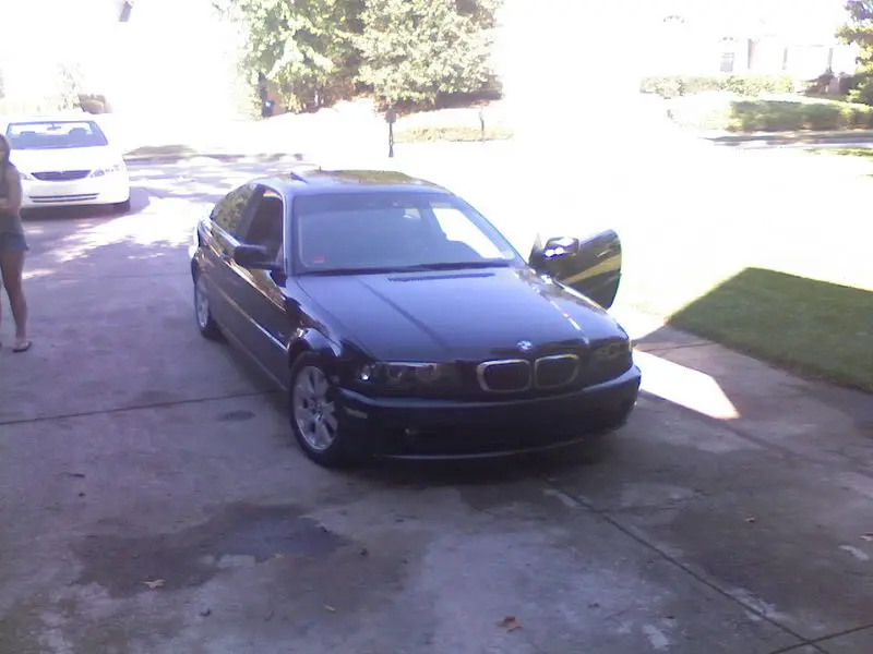

So last night and yesterday we probably spent 3 hours cleaning and waxing my friends 323ci along with removing the 323 emblem. Here are a few cell pics of it then.

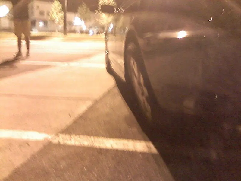

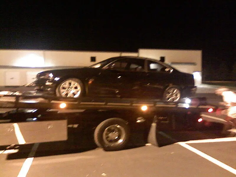

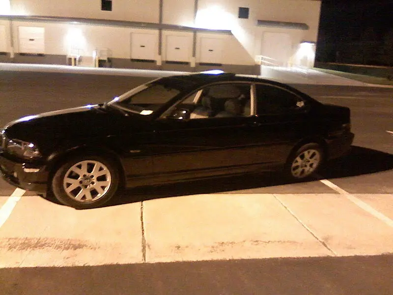

Then last night on the way home from another friends house(who just bought an 02 GT with exhaust!) we decided to cut through an indus. park...bad idea. As soon as my friend saw the gloriousness of empty roads at 11pm on a seldom traveled road he opened it up. We were going about 50 into the turn, he yanked the ebrake for a split second and we were sent into a badass drift/slide and he had control it appeared. Then he cut it too sharp and we headed straight at the curb. He whipped it back the other way and it send the rear end straight into the curb. :doh:
Here is the resulting damage. He accepts full responsibility and knows it was dumb and before anyone says anything about him being spoiled I would just like to say that he paid for the car with insurance money left to him when his dad died years ago, He's not a rich douche or anything like that.

A 323ci is actually a 2.5 straight six not a 4 banger. They aren't particularly fast. And they don't have a limited slip diff in the back, so they can't drift too good. Not to mention that many of them have stability control, and they get pretty funky cutting power and pumping the brakes when you get them crossed up. The lower trailing arms on these are stamped sheetmetal, and bend so easy it's ridiculous. Looks like he might have done more damage than that, but I've seen these cars with camber like that after a ramp truck bends that arm using it to load the car. That arm is only like 80 bucks. On the upside though, if you hit a curb that hard in a solid axle mustang you might have flipped it, and we could be talking about injuries too.
