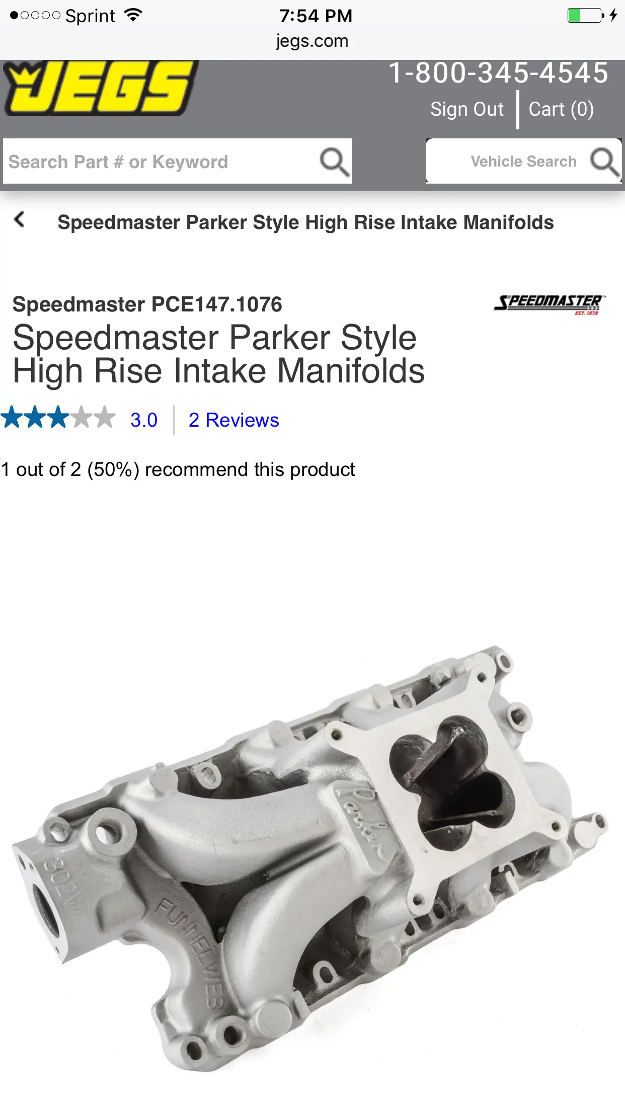

Well, after thinking about it, I wasn't real sure about the pushrods in my car.. So I decided to go ahead and order some hardened SHO-NUFF pushrods:
http://m.summitracing.com/parts/tfs-21406250
I'm also thinking about ditching this enormous rpm II intake and going to a spider intake with a elbow. I'm gravitating toward a vic jr as opposed to a super vic because the torque curve is a little lower and more suited to my needs. The only catch is I'd have to convert it ti efi as they don't sell an efi vic jr. My other choice is the parker funnel web. This is the aussies' version of the vic jr.
For 160 bucks, that leaves money for an elbow.
We'll see.
We'll see.
I have considered this as well. The only issue is drilling the injectors. I can't find a shop willing to do it for a decent price. It does look like the stock fuel rail would mount up though. They sell a bit made just for drilling the injector bungs yourself but it's 130$
We'll see.
a91what said:
I have considered this as well. The only issue is drilling the injectors. I can't find a shop willing to do it for a decent price. It does look like the stock fuel rail would mount up though. They sell a bit made just for drilling the injector bungs yourself but it's 130$[/QUOTE
Get @84Ttop to do the injector bungs for you
You can buy premade bungs you just drop in and weld in place, or you can even use epoxy according to the instructions. (I'm thinking devcon or jb weld)... But with boost, I'd definitely weld them.

That particular intake has the injector pads already. I found an article some time ago where they drilled them out for the injectors and made some brackets for the stock fuel rails to bolt to.
Yeah, I've seen that. The advantage to using the bungs is you don't have to hit the close tolerence bore just right so your oring will seal with a drill bit. The bore is finished for you, and you just have to mock it up and tack it in place before welding. Also, you don't need a mill or expensive fixtures and tooling to drill all the holes and ream them on the same angle, equally spaced, weld in bungs alleviate that problem when mocked up on a rail.

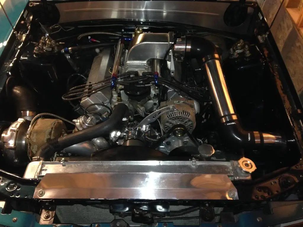

GroverDill
GoldMember
Aug 18, 1999
5,442
1,490
214
Demotte IN 46310
May 24, 2016
#30
  • May 24, 2016
  • #30
Plug changes, rocker inspection both so easy. I full support this idea.
Reactions: stangboy, A5literMan, a91what and 2 others
Boosted92LX
Dec 19, 2010
Hey Grover! Long time no see!
Did you have a victor or vic jr? How's your torque curve below 4k rpm?

Its a Super Vic
I notice no problem with torkz
Reactions: stangboy, skyline247, a91what and 2 others

GroverDill said:
Its a Super Vic
Yeah, I see that, lol.

Torkz holy mackerel @GroverDill what intake, elbow, how did you get the injectors in there, what about vacuum lines. So many questions!
Boosted92LX
Dec 19, 2010
5,721
4,244
224
May 25, 2016
#37
  • May 25, 2016
  • #37
If memory serves, he's got a 363 c.i.d. engine. The super vic comes with an efi option with provisions for injectors.

Correct,all the vac lines are on the back of the elbow. I got the elbow from 6061.com

Was the IAT sensor redrilled into one of the intake runners or was it deleted?
What throttle cable are you using? Making me rethink my charge pipe routing.
