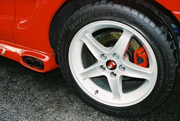

Rio and others, I'm looking at your guys pictures of your cars I have saved and I don't get it??? My skirts look EXACTLY at the same height as yours.
Do they need to cut into the body to make room for the tips? I'm lost here man.
Here are Rio's pics (sorry I'm using as reference) You can see where the tips go through - there's literally no space to get them in so that's where I'm lost.

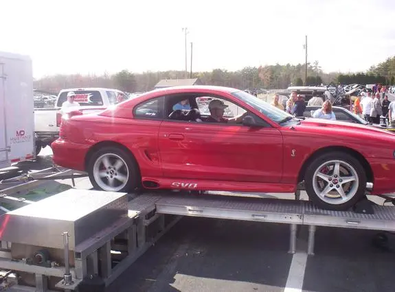

I trimmed the pinch weld some on mine, just where the pipes need to go under the pinch weld. I trimmed about 3/4" off, then sanded it and painted it so it wouldn't rust, you might not need to trim exactly 3/4", just trim what you need to make it fit...I just trimmed 3/4" to avoid the exhaust bouncing up and hitting the pinch weld when I go over bumps.
this is the only pic I have, it sorta shows how everything clears. You can't really see the trimming I was talking about, but the pinch weld is trimmed right over top where the pipe goes under the pinch weld. Sorry I can't take any new pictures because the car is put away back at home 6 hours away for the winter while I'm at school. Maybe one of the other side exhaust guys on here can take a pic?
