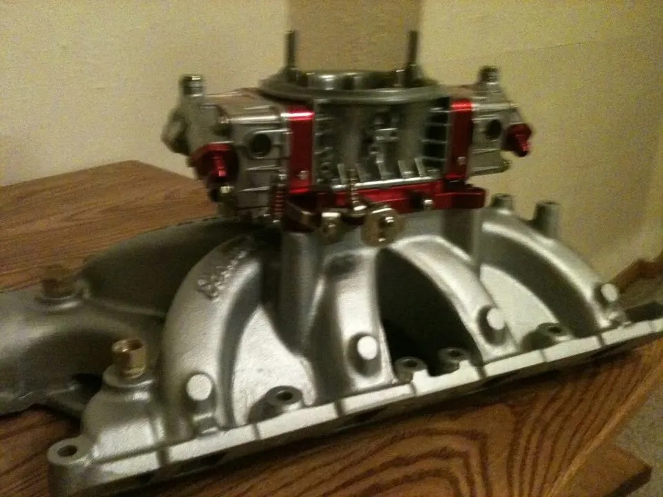

Doesnt really count as progress but it was a pretty slow day so I painted the WP and intake. And to anyone who spots it, i know the carb/accel. pump isnt on right in the pic, i just threw the carb on top to see what it would look like.

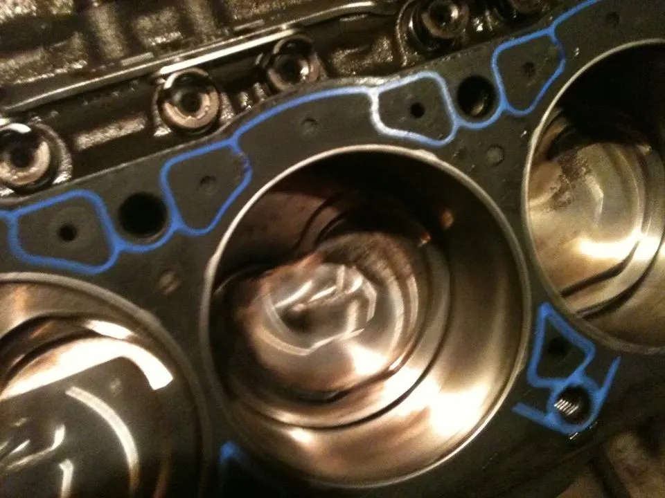

Spent some time working on it tonight. Pulled a head so I could see what kind of pistons were in it (the guy didnt know and all i could see is that they were Probes. Its got 22cc Forged Dishes in it, which puts compression right at around 10:1 compared to 12.8:1 that flat tops would have given it. Also found a part number on the Push Rods (Comp Cams High Energy Pushrods) and saw that it had some Fel-Pro 1011-1 Gaskets on it (everyones got their own opinion on HGs but i wont be using this type of gasket when I put this thing back together) Only thing left is to check the main bearings out and pull the timing cover and look for a number on the Camshaft.

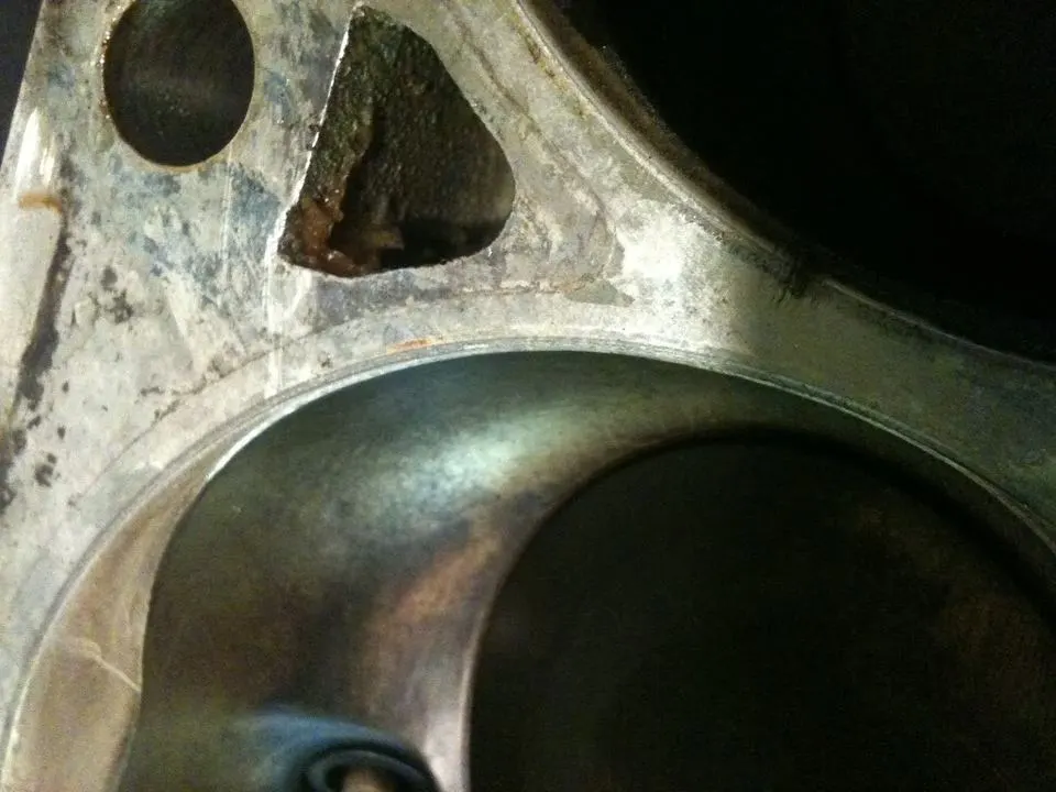

So ive been doing some more reading (imagine that) and I read that the 1011-1 head gaskets aren't meant for iron block/alum head combos and that they can do damage to the heads since the steel ring (compared to copper on the 1011-2s) doesn't play nice with aluminum when the head expands and contrasts. I'm really really OCD sometimes and I'm not sure if these heads need milled or if I'm just reading too much. Took a couple pics of some very small grooves around the combustion chamber from the rings. Probably going to go over them with a straight edge and a feeler gauge.

I'm thinking it's fine, but there's always an Internet horror story for every situation, so i thought I'd ask those wiser than me. And I guess your opinion is welcome too :D
interesting subject, I just ran into this same problem. I took some advice (on here I believe it was) and decided to run the 1011-1's instead of my 9333PT's which popped last summer. Well..............should have done my homework a bit better. After a billion hours later my car is almost 100% back together and my tuner is telling me I should be using the1011-2's with the copper ring. I did lot's of reading on the subject and here is what it seems:
1) 1011-1's can be used with iron blocks and aluminum heads
2) they can cause the rings that you see (but are supposed to be designed for minimum burnelling of the aluminum)
3) every has there opinion - some say they have used them for years like that with no issues, others say they were terrible. a thread on corral supports this and Jay Allen approves of their use
4) I'd have the heads checked anyways, they may need to be resurfaced anyways

What has me confused is that the 9333pt1's have a stainless ring as well as the 1011-1 and I had zero issues with them causing the grooves.
I noticed that that's what they recommended but it didn't look like it was recommended based on block material. I can have them milled for free but I'd like to avoid it if possible.
