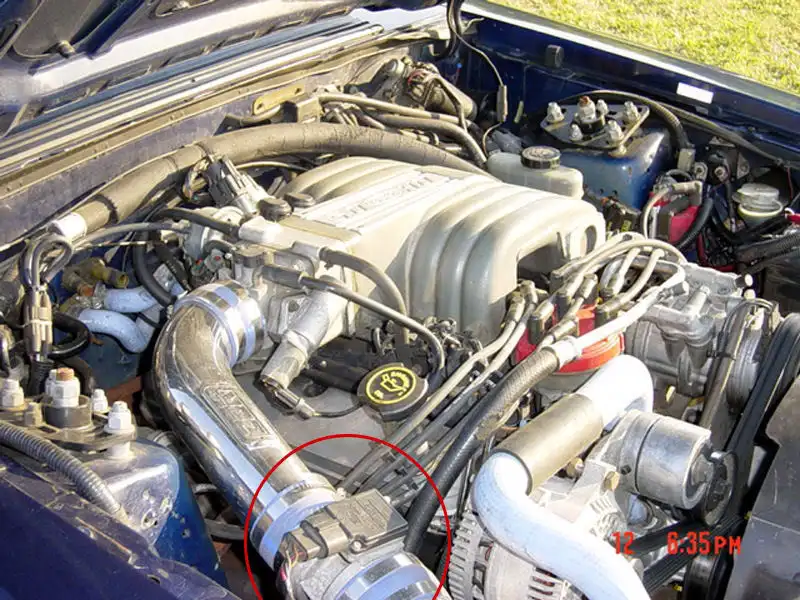

If you still have speed density, there should be a plastic tube that runs from the air box (where the filter is) to the throttle body. If it has been converted to mass air, there should be a cast aluminum peice right after the air box, with a electric sensor bolted to it and a wiring harness attached. I'd post a picture, but I don't have any before my SC install.

1FatPony said:
its has the aftermarket k&n
Here's a picture with the MAF circled in red at the bottom. Ignore the chrome intake pipe and stuff. If you have that sensor between your air filter and engine, then it has been converted to mass air. If you don't have that sensor, you still have speed density.
