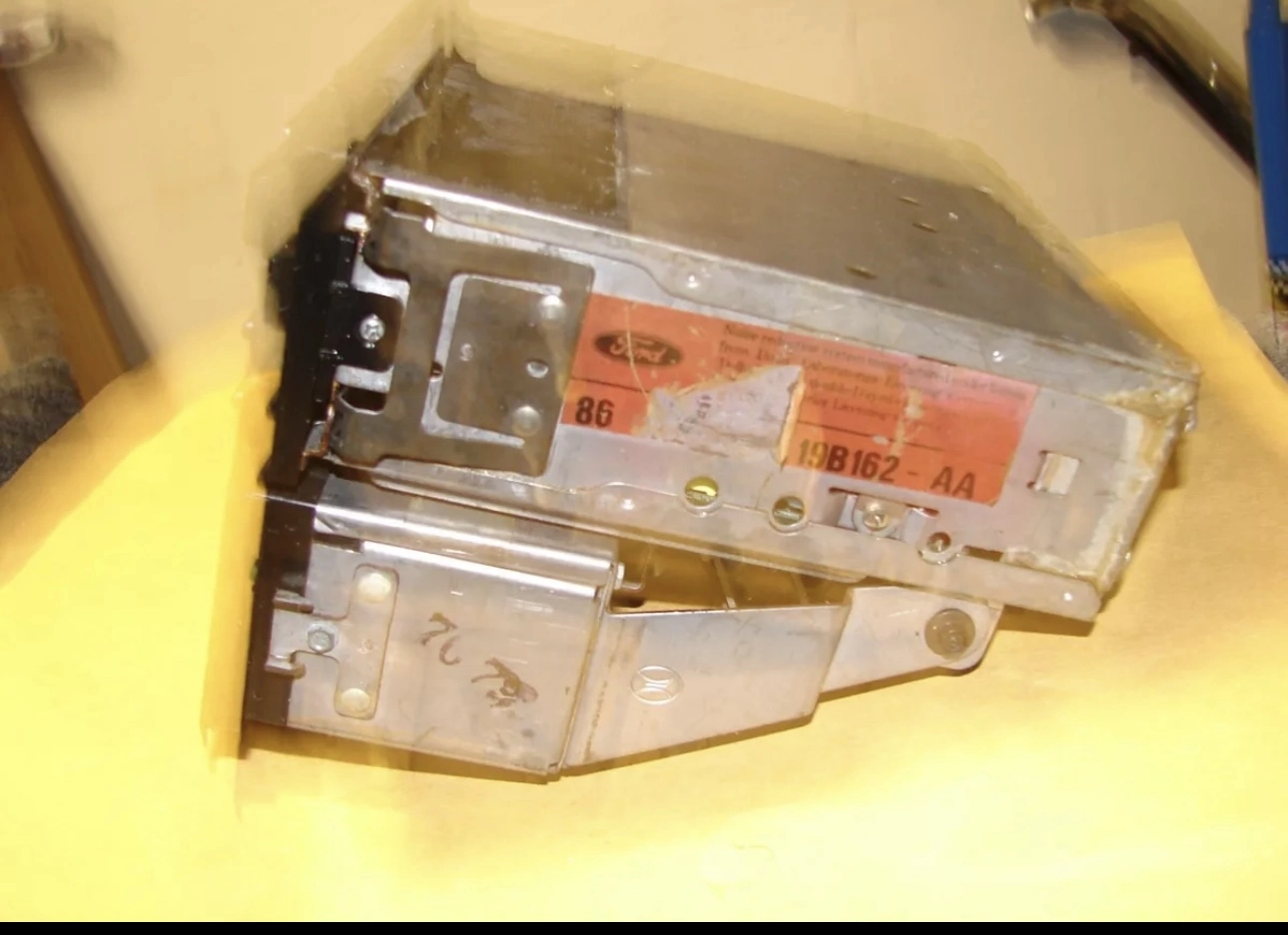

No, the bottom plate and bracket on the EQ radio is unique to itself.
Make one out of flat, plate cut to width and bent into an L shape.
Predrill a couple of holes for self-tap screws to secure it to your existing bracket.

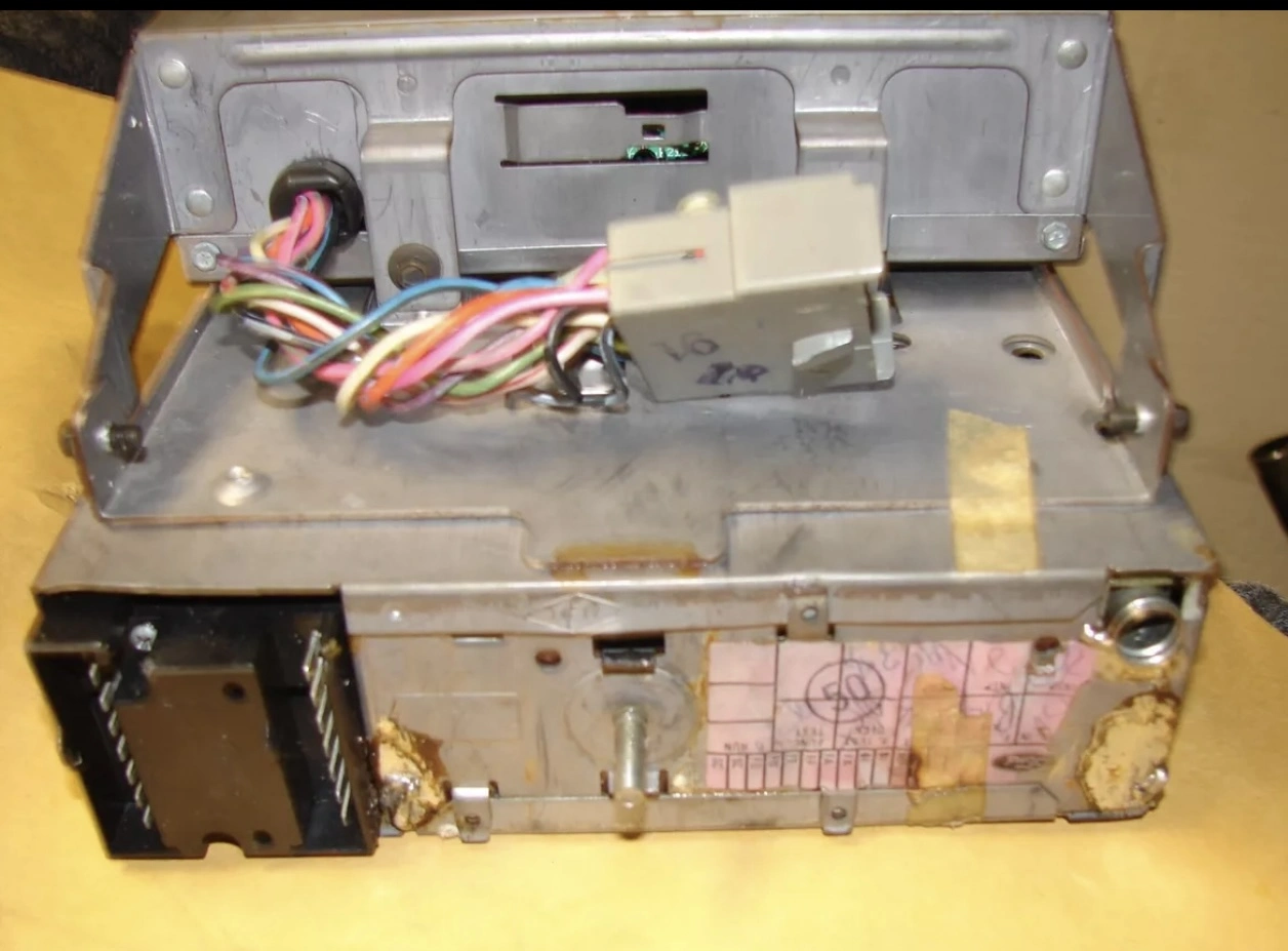

Is the "bottom plate" a separate piece from the bracket?
It's a separate plate that is press rivets to the bottom plate of the radio. It would be difficult to find unless someone has a trashed parts radio and is willing to separate. Better off making your own.

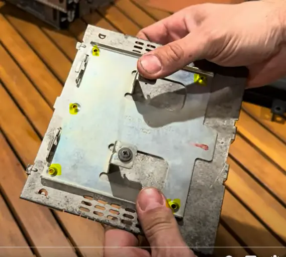

The bracket is different from the non-EQ radio that holds the cubby. Those brackets connect to the radio plate via 5 small rivets. Highlighted here
You can carefuly drill these out to remove this bracket, and then you can fab a bracket and use these 5 holes to rivet it back onto the plate. I think i've used low-profile 1/8" rivets to do this.
You'll just have to get a thin peice of metal and carefully bend it similar to above to make a support.
