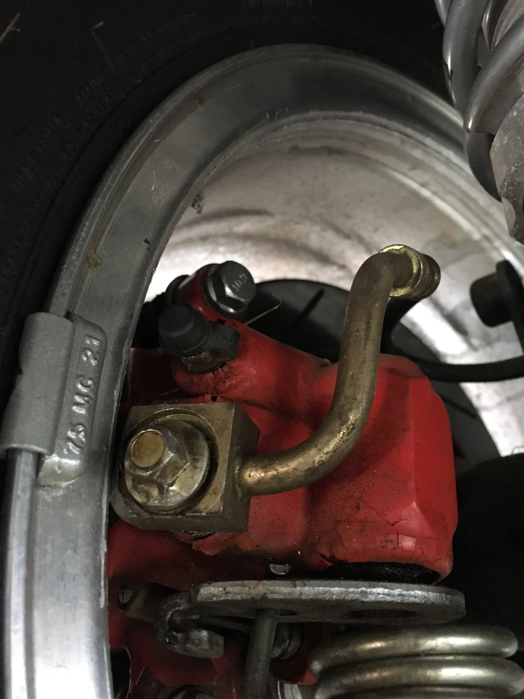

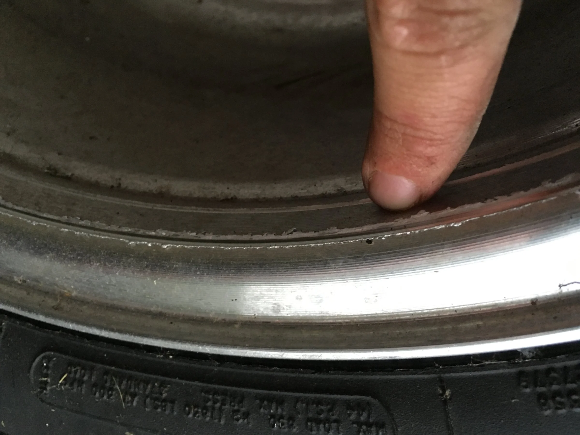

I have quite the conundrum here guys I put 99-04 gt style rear brakes on my 91 they have 11.65" rotors in the rear. When I have my 17" cobra r wheels they weren't an issue at all. Now that I have swapped to a set of race star 15x10 wheels the banjo bolt and brake line grind the inside lip. I've had to put a whopping 9/16" spacer in order for it to not touch the wheel. I tried searching the interwebs to see a remedy or if there is a smaller rear brake setup I can put in the back. I have a couple of pics of what I'm talking about. Hopefully someone can help me out @84Ttop and @TOOLOW91 have both seen what I'm talking about.

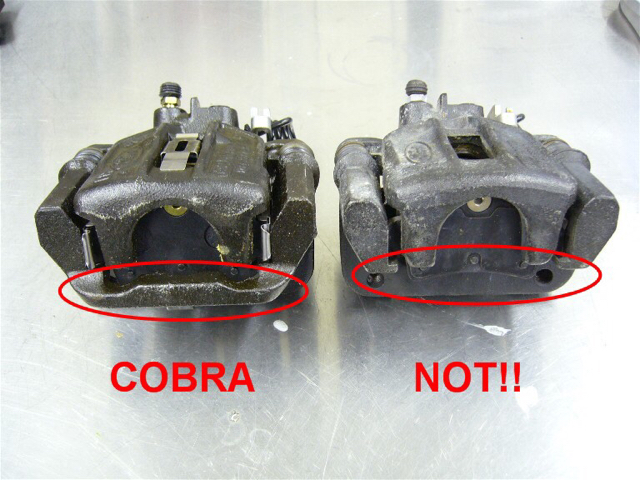

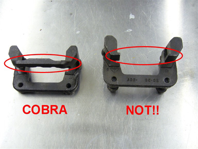

Take a look at this pic
Main difference between GT rear calipers and cobra is the extra support bar on the cobra calipers and a wider rotor groove to clear the wider 11.65" rotor. Also, cobra pads are thinner as well due to the wider rotor
So you can run the cobra calipers on a GT rotor. What changes the diameter are the axles brackets you'll need to pull the axles out to install

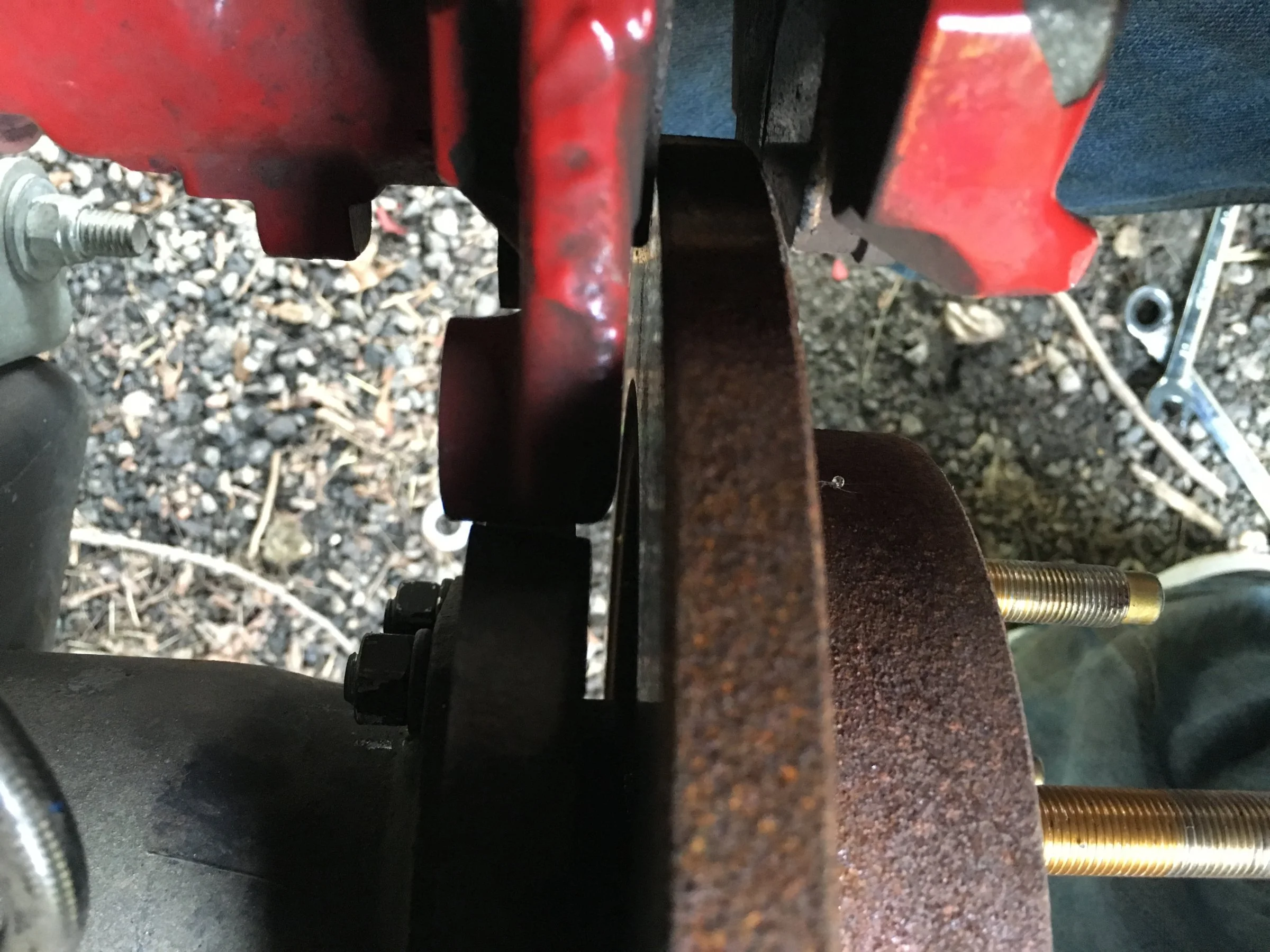

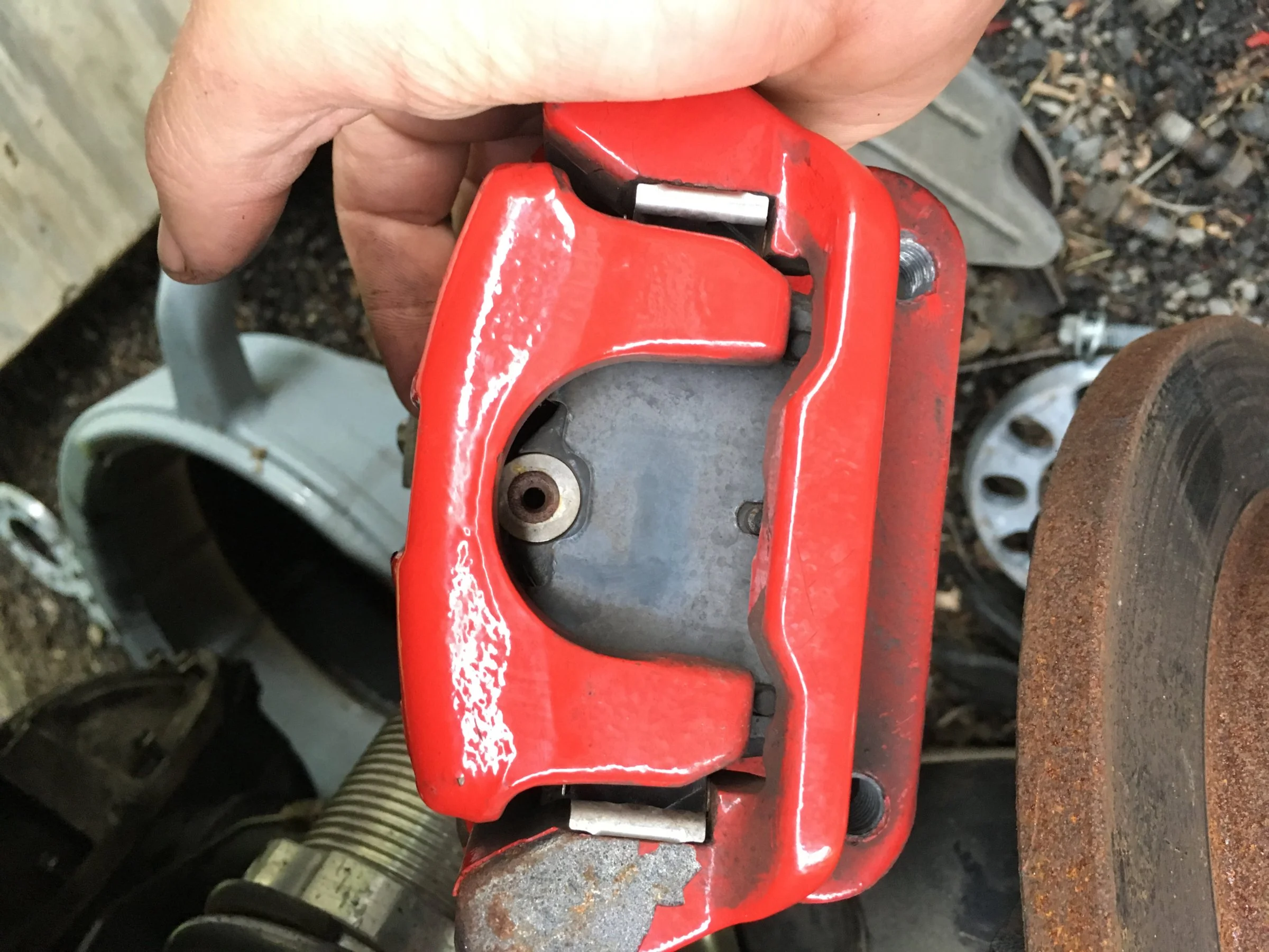

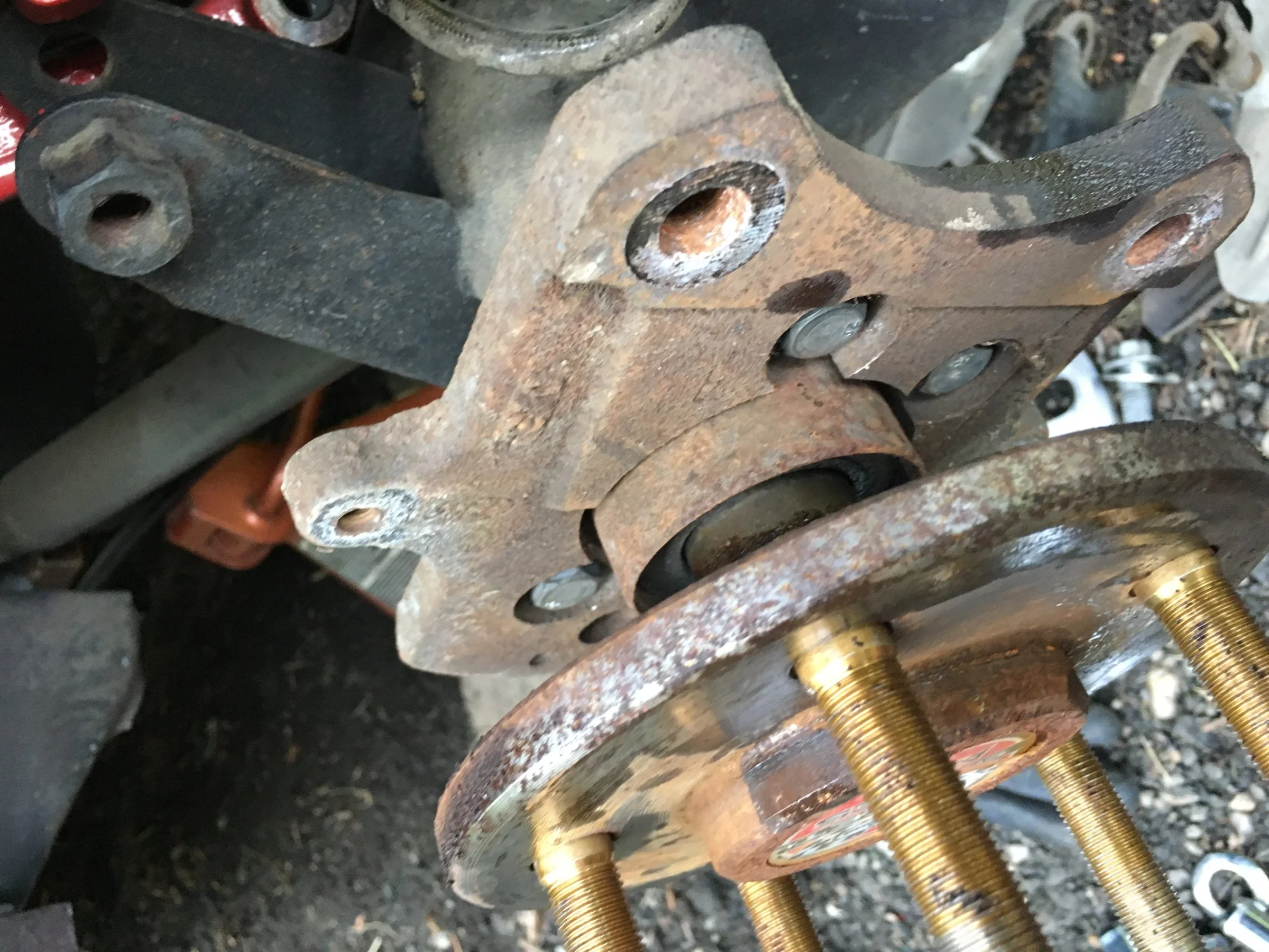

Ok so I had a set of gt rotors and brackets and anti moans. New problem my calipers will not fit the new brackets.

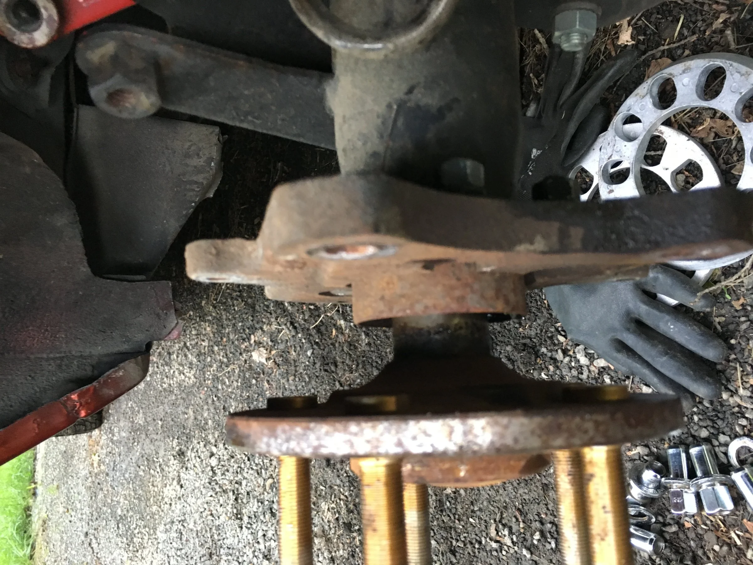

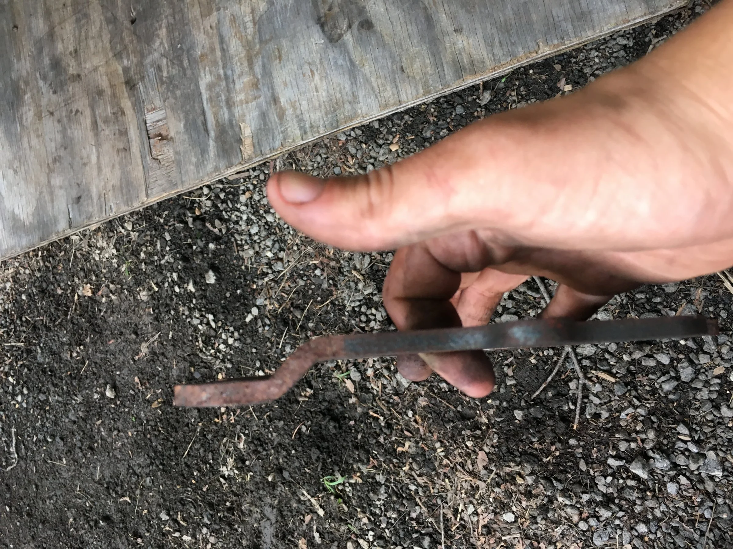

The second picture is the offset that the cobra brackets had.
The brackets with the offset are aftermarket. Probably north cobra brackets.
I'm confused on your series of photos. Are those the GT brackets bolted up? Or what you had on there to begin with?
If you were running those offset brackets with an 11.65" rotor, then you had fox lengt axles with the north race car brackets that allow you to run the 11.65" rotor.
Is that what you had? If so, you'll need to buy the GT rotor version now.

Yeah as soon as posted all of this I searched it up found that 99-04 axles are 1.75" wider. So that is where I need the north race cars brackets so thanks for your help friend!!!
