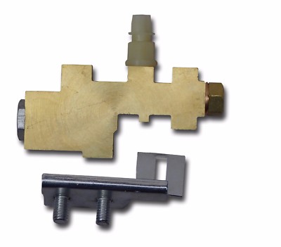

85GTStangGuy said:
Read the description... the last sentence... it refers to the bracket coming on either side. Hopefully you get one with it on the correct side.... if not, I'm sure it could be made to work by somehow affixing the bracket (or another fabricated bracket) to the other side (jb weld?).
I will look at that again... I had my valve held up to the screen while looking at it and it looked to me like it would still be pointing in the wrong direction on the other side.....
I found this on EBAY and it even had what the thread counts were.....
Looked like the only thing to change is getting a 7/16-20 M to a 3/8-24 F adapter on the bottom port..
OR take out the brake line and cut and reflare it with the correct connector....
At this point it looks like my new/old valve is going to work....
Another option was buying an 87-93 valve and some new lines to fit it.....
Here is the EBAY valve...
1960-1970 Ford Mustang Fairlane Comet proportioning valve for disc drum | eBay
This is a new in the box front disc brake rear drum brake ford type proportioning valve. This is used on factory disc brake cars as well as disc brake conversions. This fits 60-70 ford passenger cars.
www.ebay.com

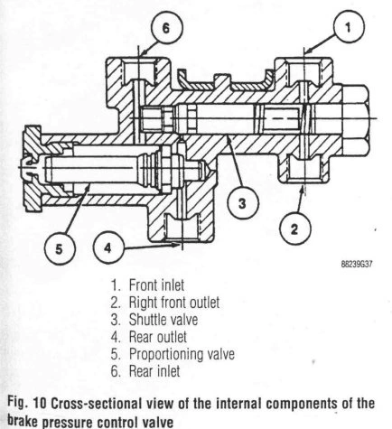

I think it will work but I would want to confirm brake line sizes. These are the brake line sizes according to NPD:
Searched through a lot of trash and found that the 79-93 cars all have the same brake line fittings sizes on the brake pressure control valve which are what is above. If you are concerned with brake bias then gut the proportioning side of the combination valve (left end of the above picture) and install a manual proportioning valve which will solve that problem.
Just to be clear this block is a brake pressure control valve as it houses a shuttle valve (behind the outlet to front brake at the rear of the block) and the proportioning valve (behind the plug on the left of the block).
Cut away view of the brake pressure control valve:
Reactions: General karthief
