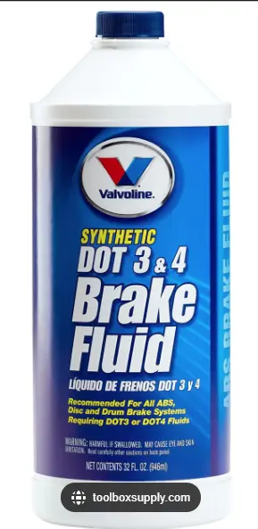

Dot 4 can be substituted for Dot 3. They are both glycol based and the only difference is Dot 4 has a higher wet and dry boiling point than Dot 3. They can be mixed.
Dot 4 shouldn't change any performance characteristics of the brakes. Not sure what exactly is meant by "aggressive".
I've always run this in all my cars, unless a particular brake fluid is specified (like Motorcraft Low Viscosity brake fluid for Torque Vectoring vehicles)
