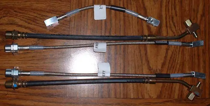

Here's a pic of the Russel 693030 kit intended for 94-95 Cobra along with the 2 front hoses I received with the $399 Cobra front brake kit I purchased from PPI. The are the same length, have matching thread ends, and the caliper ends look fine.
Rick

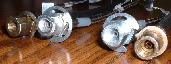

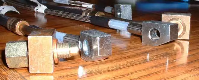

Here are some close-ups of the ends of the lines.
Notice that the left side and right side have a different thread size. I'm assuming that these will match up with the threads on my 94GT - Killer95Stang was this a problem? I wonder because the threads on the master cylinder are different between GT and Cobra and maybe the lines too???
The bolts that are on the rubber hoses are the ones I need, but I may get new ones if they are not too much. The bolts don't want to easily come out of the hoses since the washers ID is very tight on the threads. I'm concerned that unscrewing the washers off the threads might gall the threads. I could always cut them off with a Dremel, though. I think that the washers are copper, would they not hurt the threads then?
Rick
