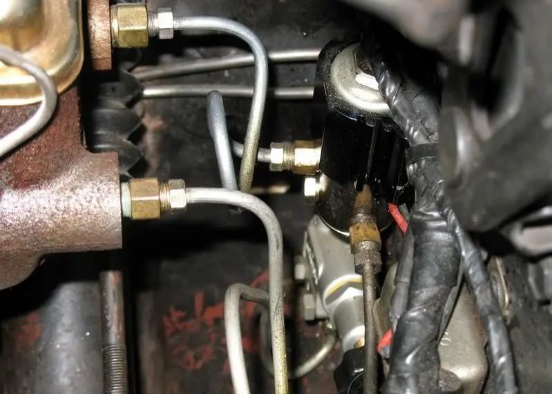

Here is a pic of the adapters needed for my 65' which has disc brakes and uses a 78' Granada MC for manual brakes:

I'm fairly certain the Granada MC has a 7/16"-24 secondary fitting and the primary port has a 9/16"-18 inverted flare fitting.
