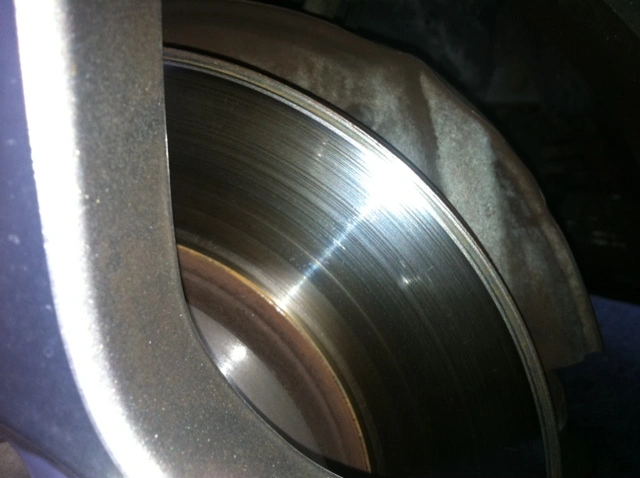

It appears that there in a ring being ground into the outside of my rotor... whats causing this?

The ring is a portion of the rotor that the pads don't touch, that's normal. You need to take your car to a mechanic and have him go through the entire brake system. It sounds like you and your buddy didn't know what you were doing and the brake system is pretty important

The only thing that's causing a "problem" is the ring I didn't know what it was. The brakes are working fine. I didn't finish them I got my dad to help me.

Those don't look new rotors. If they aren't new then it looks to me like they weren't turned or if they were turned the guy didn't let the cutter run all the way off the rotor. Some don't and leave a lip.
