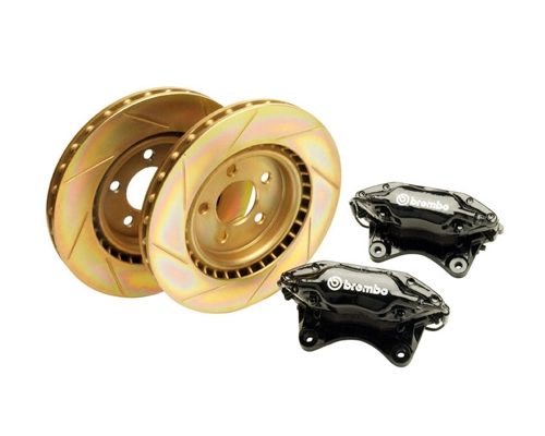

The 2000 R front Brembo setup is awesome
Part# M-2300-X (even the part# sounds cool)
Ford Racing Parts MSRP is $1150 but there are deals...
http://www.fordracingparts.com/parts/part_details.asp?PartKeyField=5819

ya, its a lot cheaper at buyfordracing.com a lot cheaper
Man I want those so bad!

as an added bonus, when you change the pads on the cobra R/ Brembo setup, you dont ahve to remove the caliper. you jsut pull the pins on the top and drop the new pads in.

ya, if you watch some endurance races you can see them swap them out in pit stops. ive seen the mechanics on an Aussie V8 Supercar team swap them out in about 10 seconds.

you can get the cobra R kit from buyfordracing for about $900. i got mine for $825 because i opted to not get the slotted rotors, just plain face brembos.
if you think thats bad, go look up how much the Wilwood 6 piston front, 4 piston rear w/ drum parking brake. you are looking at about $4k-5k for brakes alone.
