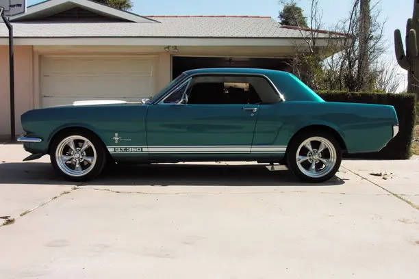

First, Problem - Car pulls to the left when braking. This showed up after getting the car aligned.
Second, Things we have tried in order - idler arm, new calipers, new master cylinder, cleaned out proportioning valve, swapped rotors & pads side-to-side.
This is a 65 Mustang coupe with approx 1976 granada front spindles/brakes.
We cannot figure out why this thing continues to pull. It even pulls after swapping the rotors & pads from one side to the other. Still pulls to the left. Any ideas would be appreciated, thank you.
