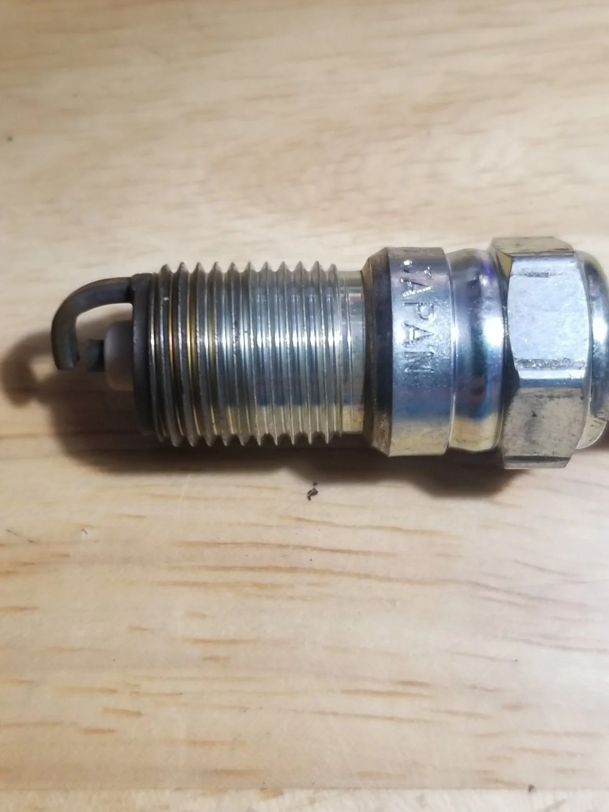

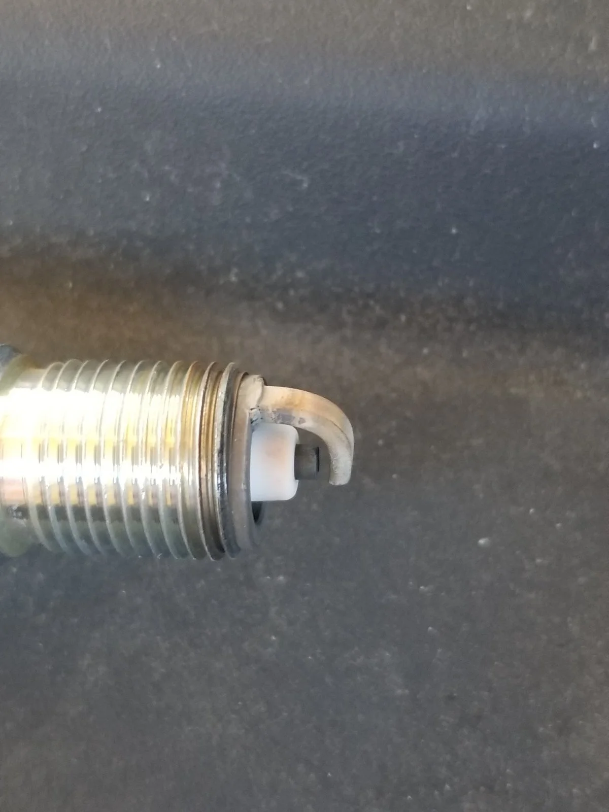

The plugs are much Darker now (Im not sure if the engine shop ran the car and how long if any. Also I can get the exact miles tomorrow and tally it out), but I pulled cylinder 5 plug 10/21 at 800~ miles on the engine, but cylinder 5 (and all cylinders are dark now). The car only had 200~ miles in between those pictures, so something happened there. The plugs were all hard as **** to get out, I took video of removing two of them, and its the hardest ive ever had to remove spark plugs.

Cylinder 5 plug at around 1000~ miles ( this was hours before the car gave out, not even 20~ miles for a short drive later that night where all kinds of knocking, misfiring, loose of power) I parked the car and towed it to the engine shop without ever starting it again:
Cylinder 5 plug at around 1000 miles~ (I pulled this after I towed the car back from the engine shop, not sure if they started/had the car running, but something failed dramatically for the plugs to change like that with so few miles.):
