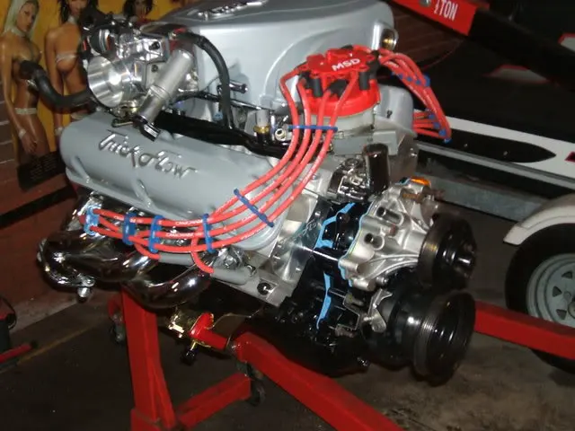

I had to put a space on my trick flow stuff when i did my h/c/i ONLY becuase of my fuel pressure regulator i bought. other than that, you wont need a spacer. here is what my setup looked like after the install WITHOUT the spacer. And if you do use a spacer, you might a taller hood becuase when i closed my hood for the first time, my throttle body vent put i small pop knot in the hood. But as you can see, there is plenty of room without a spacer
