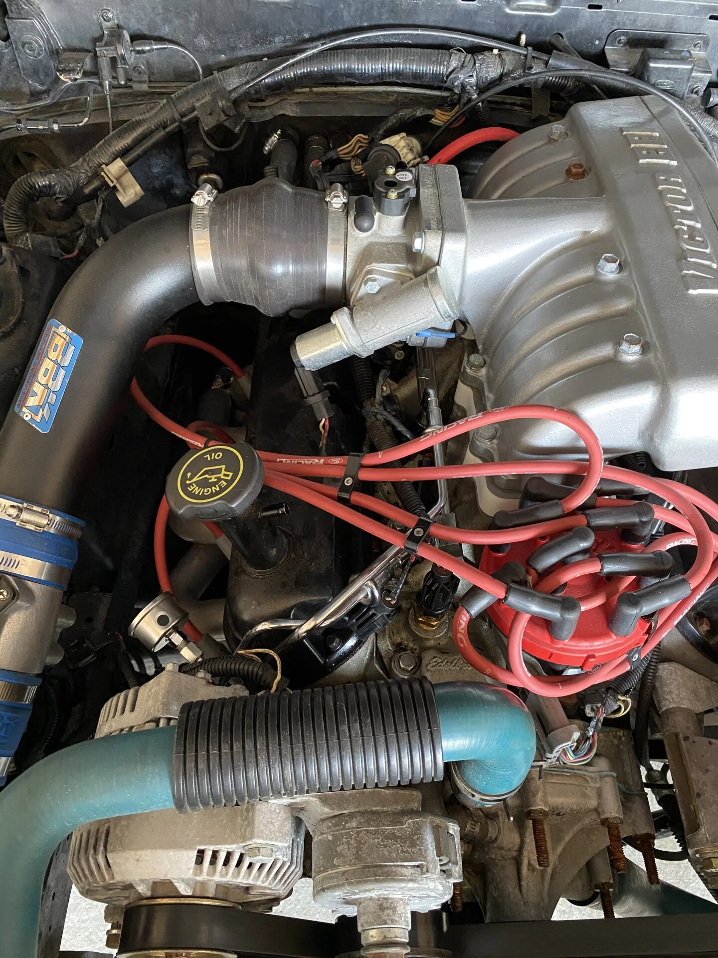

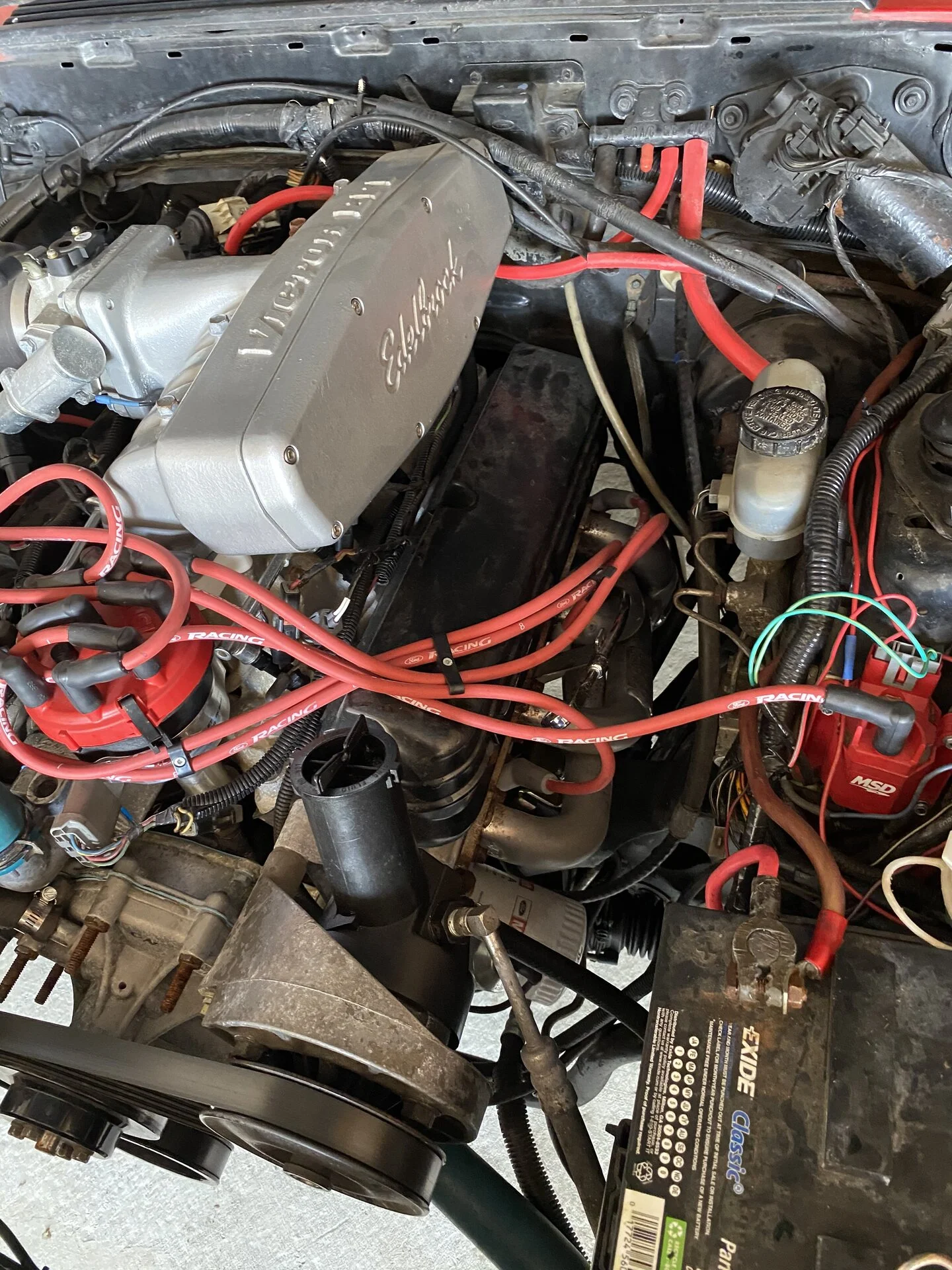

So just got this 347 Foxbody. New build
I don’t think it has a Pcv. Oil is spits out the filler neck. Should I just get a screw in breather and plug the filler neck spicket. Or should i run a tube to somewhere. The eldebrok intake has two plugs underneath that I could use.

Then look behind the intake to see if a hose is back there pointing down to a rubber grommet, that should be your pcv valve at the end of that hose and stuck into the grommet. You need to run a hose from the nipple on the filler neck to that capped port on the throttle body.

So went and looked again it doesnt seem to have a PCV valve behind the intake like a stock motor or intake has. Like i said its an eldebrock one. It does have two pluged holes underneath the head part of the intake on the right side.
Back of the intake has one house that runs to the S port on the vacum tree or source
More I am looking it will need a breather on both valve covers. only thing left to answer is the port on the filler neck plug it or send it to the intake will contract edlebrock.
No PCV provisions on a Victor EFI intake, you could remove and drill the lower to accept one.
I run a Victor EFI on my 393w with lines from each valve cover to a catch can, not saying that's the best
way to do it but works for me.
Reactions: silverlx50
But should there be some way to pull the contaminated fumes from inside the engine? I know the efi engine is designed to have a 'closed' intake system partly because of emissions and partly to meter air intake. I would think adding a pcv possibly in a valve cover, then adding a hose from the oil fill tube to the throttle body similar to a stock setup.
The filter on the filler tube will keep crank case pressure from building.
Ideally? Yes.
If you want to get complicated and EPA-compliant about it you could run a strainer inline ahead of a Hyundai PCV valve that was factory-mounted inline in a piece of rubber hose and then connect that to a vacuum port or the air intake tube.
Or you can just put a breather filter on the nipple because this engine already isn't EPA-compliant, so what's one more little violation really going to hurt?
well emailed edelbrock their stance is to put a breather on the valve cover with the filler neck and a pcv on the other valve cover. Still leaves me with the spicket on the filler neck, which Id have to take a look at the valve covers again they are ford racing, the filler neck cover had a baffle in it but not sure if the neck was built into the cover or can be removed, if it can be removed then Ill just run a screw in breather, if not do i plug that spicket or run it to the manifold as well
Also tracked down the builder of the engine. He said just one breather was ok but for street use would probably add a breather on the one side and a pcv to the other valve cover.
Thought of this after but the spicket or barb on the filler neck should run to the throttle body which has a port but is capped.
Should I do as the builder and edelbrock says and run that line from the neck to the TB
issue I think I’m having is the engine was built as a a race engine with bigger ideas down the line so how and what to run might be different then regular use
I looked at a picture of the Victor EFI on Edelbrock’s site and it looks like it has 3 vacuum ports on the back and what could possibly be 2 larger ports underneath. If so could you install a PCV in the driver side valve cover and connect it to a vacuum port on the intake. The connect the filler neck port to the TB like the factory does. I’ve seen it done this way in the past and it worked OK.
Does it hurt anything or increase oil consumption to have the crank case under vacuum?
In the days of an air breather and carb, one valve cover was usually hooked up by a hose to the air filter housing (with a fiber filter inside), and the other side had the PCV valve with a hose that went to a big port at the base of the carb. So there was a path for fresh air through the enginr for the PCV system.
If there is no filtered air input,!there may be a vacuum in the crank case. Some racers use a pump to do that, but what about on street cars?
