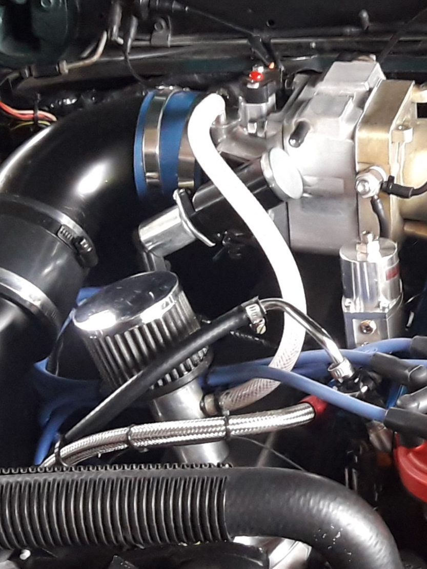

hahahahahaha ..... is that so ?? lean conditions .... ok ok ...and what for, you have the Oxygen Sensors and the ECU for ?? if it causes any lean conditions ..sensors will detect and sending info to the ECU ...ECU reacts inmediately and sprays a little more gasoline into the Engine to get the right AFR ... If I understand right ...thats why engines have O2 Sensors and ECUs.....??? and if you run a 347 with Victor Intake..then your willing to rev up +6k and that can cause a lot of other reasons leaning out the Engine ...should run a AFR gauge anyways..
This routing will cause a lean condition. The engine is calculating air volume from the MAF sensor. Air is entering the breather in the oil fill location and going through the hose to the throttle body. This is not the correct way to do that. The oil fill tube should be capped off. That will allow the already metered air in the engine to flow into the throttle body under acceleration ( when pressure builds )...when cruising or idling the PCV would pull vapors into the intake allowing flow to come from the hose at the throttle body...into the engine...and out the pcv....to the intake.
So...yes....Marcelo...that way is wrong.
It can be tuned around...but is still not right. Air must flow...kinda like water. If you have an open breather then you shouldn't have that hose to the TB....or the hose hooked up from the PCV to the intake.
On our PCV system theres a clean and a dirty side. There should be a breather can on one side and a catch can on the other especially if boosted. Open filters do work with the PCV system deleted but will smell like fumes and will make messes of the valve covers over time. If you use open breathers and the factory PCV valve it will cause lean idle conditions unless you have a chip or tune that gets around that issue.
Vehicles fueling adaption strategy is limited. O2 sensors help the car stay in the operating range. Too lean or rich and the computer can not compensate for it.
Reactions: marcelo

hell of a game ??!!! with that air stuff....hahaha I also use a PCV ..from the back of the intake (original) but not that much oil on it ..had a catch can installed but never a drop of oil in it ..so its not in use anymore...i forgot that my engine is Speed Density ... if that makes a difference ..almost shure it does ??? :chin :chin :chin :chin :chin

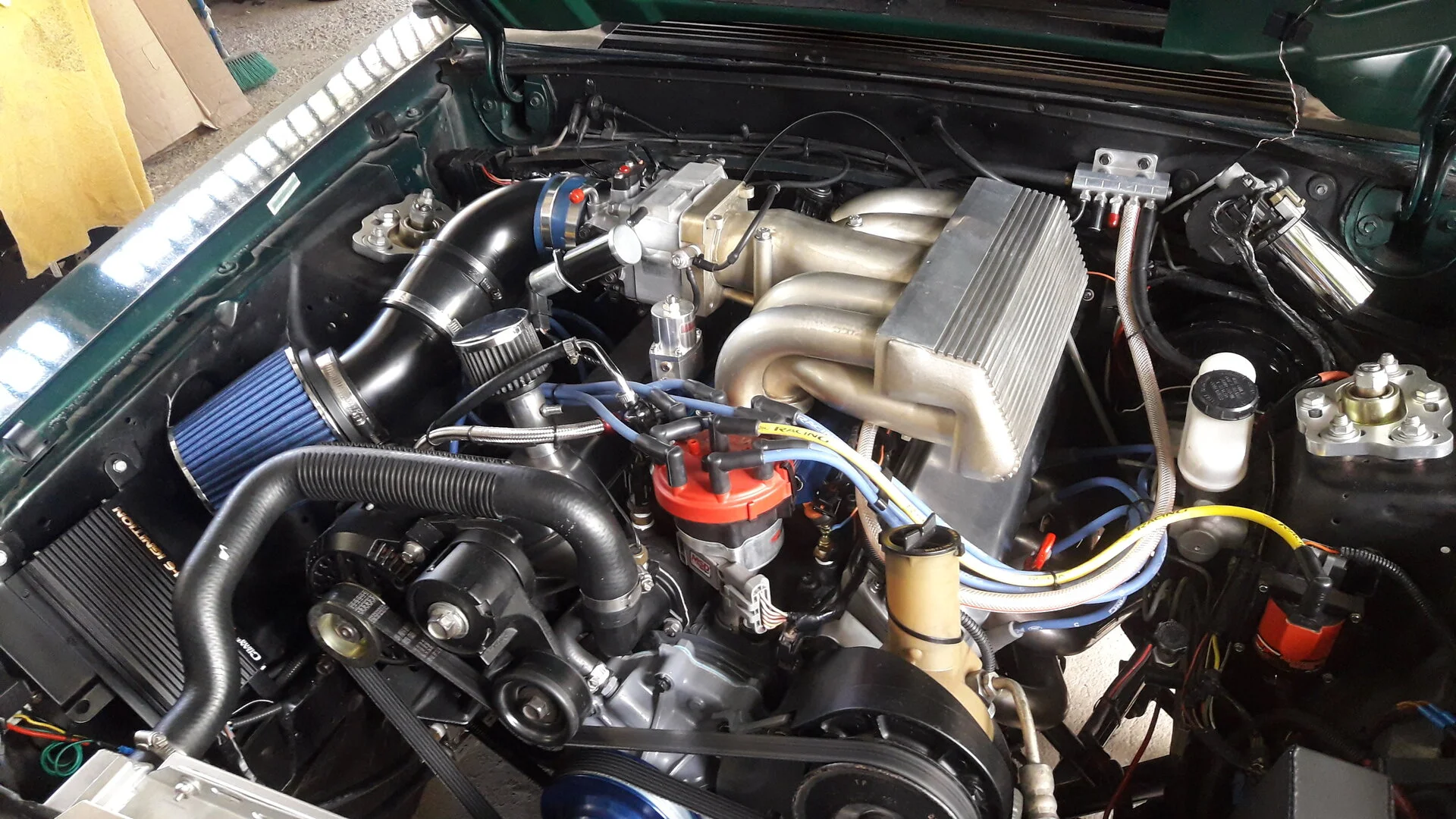

ok ... ..with different setup ... datalog does not show any changes in AFR readings at all ... changes must be that small cant be detected or there are no changes at all ... sorry guys .. you all might be right .. but my engine gives a sh...t if tube is on or off or oil filler is closed or open etc... 331cu Tubular Gt intake, F cam, Aluheads, LT Headers .. nothing special ok engine is new ..less then 1000miles

:shrug: speed density does not measure incoming air flow (I think it does not on stock setups ?)
How does your computer measure air flow?
I'm thinking you have an aftermarket controller and an afr gauge, just trying to educate myself here.
I know all about that magic gnome. And I know how speed density works, just trying to point out the correct way efi needs to be configured, a properly configured pcv system will help keep the inside of the engine clean, oil and moisture vapors are sucked into the intake and burned off in the combustion process.
Post #35 explains it very well.
@7991LXnSHO and @90sickfox I think will agree with me when I say remove the pcv and stick a breather on the valve cover then come back here after 50k miles and I would be surprised if that engine is not seeping oil from the oil pan, valve covers, rear main leaving the engine and engine compartment a stinky oily mess.
