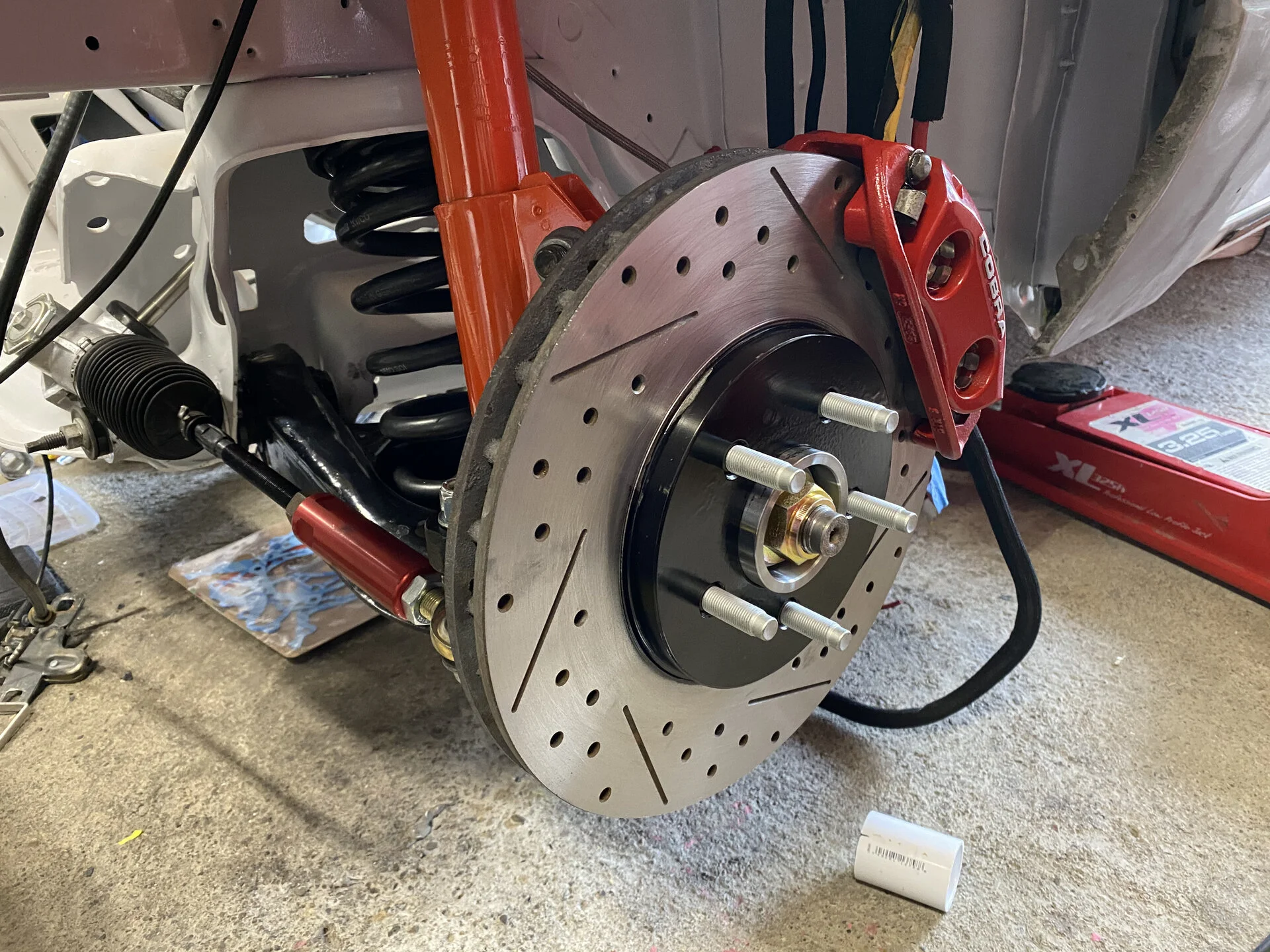

My current setup already has the 5-lug swap with 94-95 spindles up front, 13" rotors with the 2 piston calipers, 18" FR500 wheels.
Question:
Has anyone on here done the Brembo swap and found the stopping performance made any difference?
Are these 4 piston calipers too aggressive for a non ABS car?
I am more of a weekend warrior when it comes to track time and or back road aggressive driving, so I would say they are more for look then performance, but still am looking for a little bump in stopping power.
I purchased the install kit from S&S Engineering the brake lines, calipers, pads from Amazon.

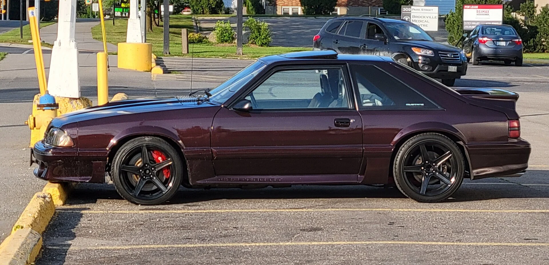

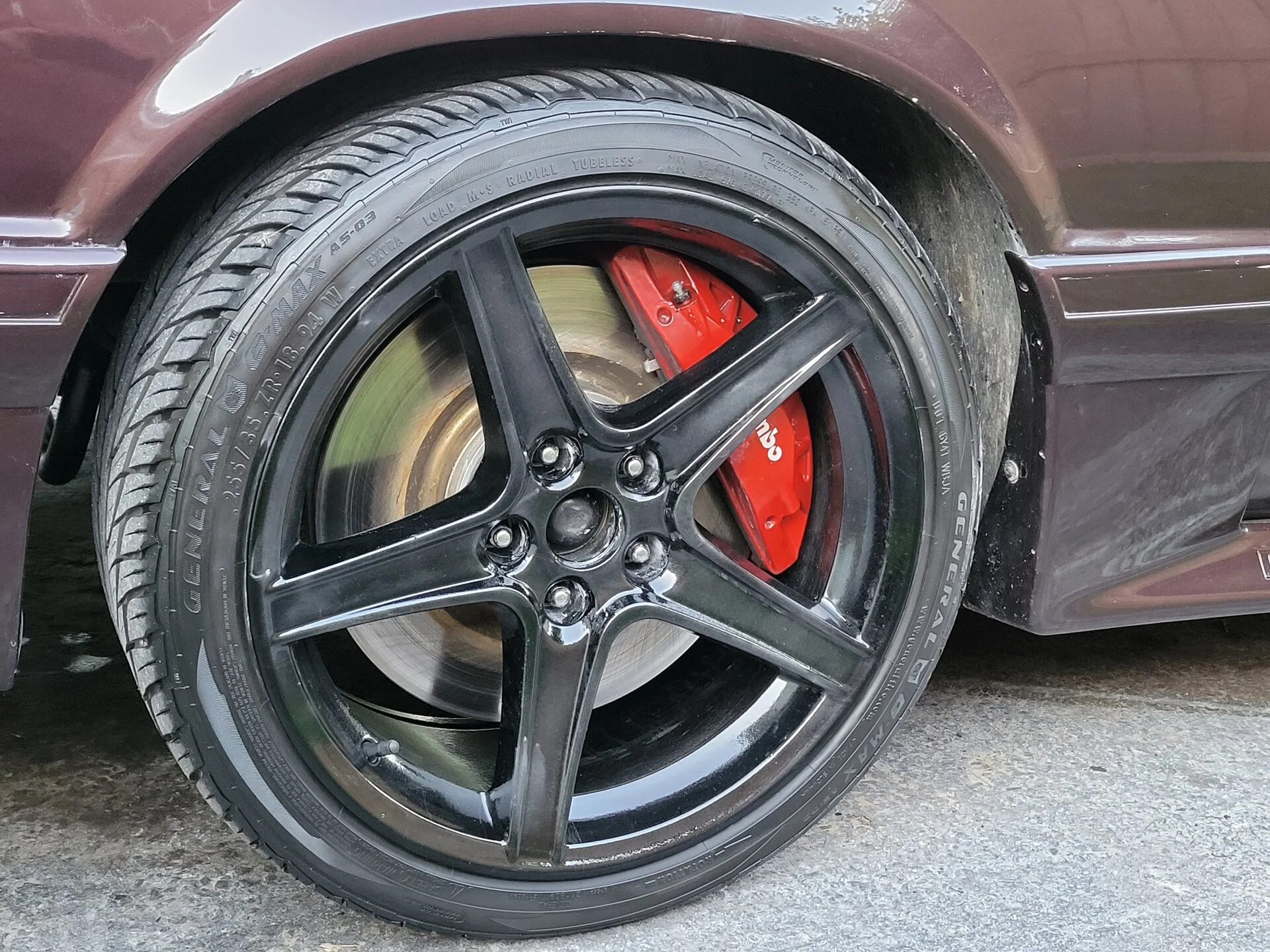

I did the XTS Brembos and 14" rotors. I didn't have a Cobra setup before to compare preformance. I have no complaints, they work great.

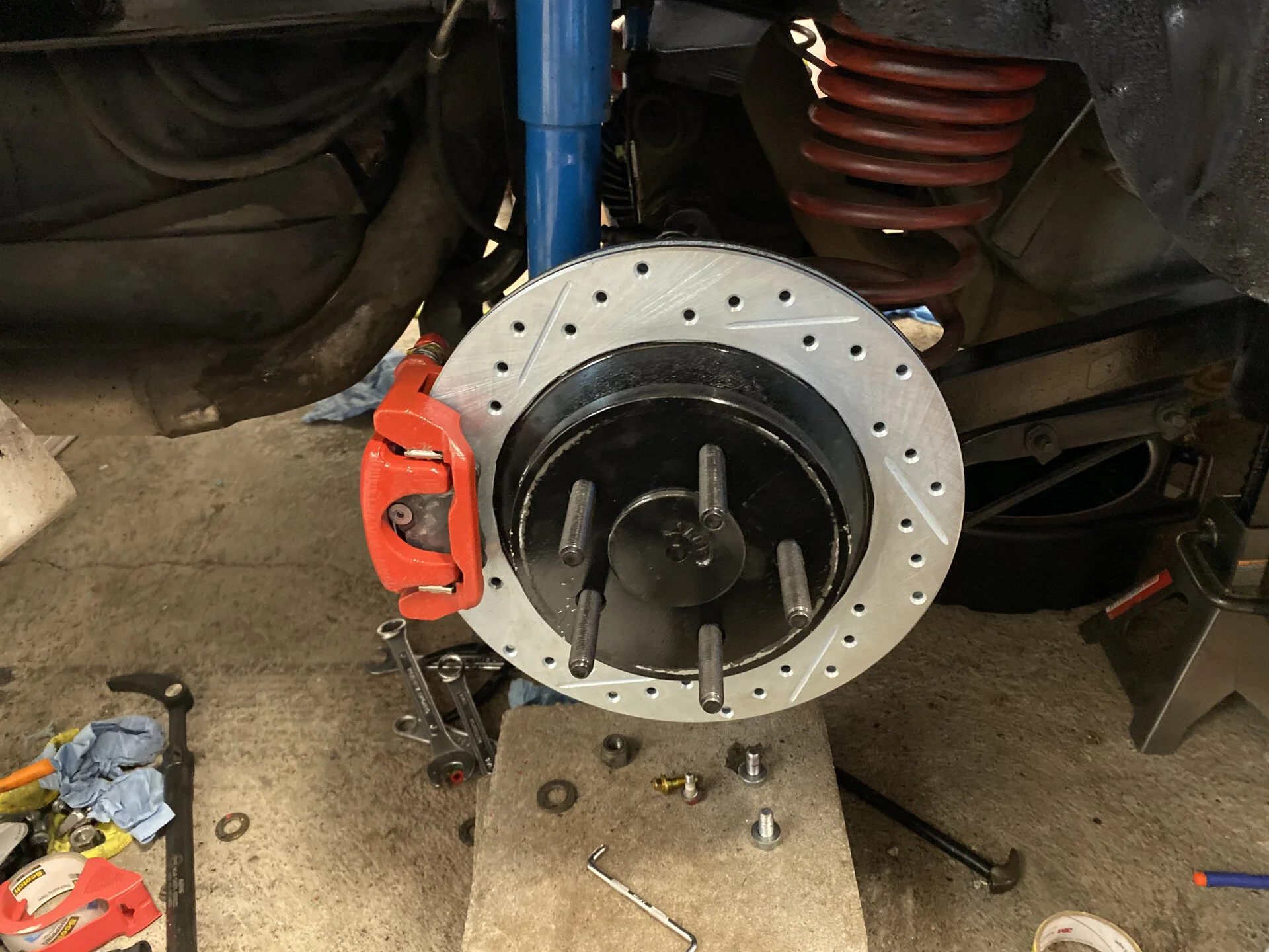

I am running the cobra disk brakes for the rears, and I believe the rotors are 11.65".

The Taurus rear calipers are larger then the GT/Cobra calipers?
Here's what I found on Amazon:
Rear Caliper
Rear Caliper
I assume these calipers will bolt right up to the 11.65" rear rotor?
Have any suggestions on ceramic pads?
I assume SS brake lines and banjo bolt will still work with these rear calipers?
Calipers are so cheap that it's worth the 100 dollar upgrade, plus it's worth doing it right. Nothing worse then a half as$ job.
Yes, they are 43MM pistons vs the GT/Cobra's 38mm pistons. Both are made by VARGA. They are a direct swap so your parking brakes and the pads will work in them. SS brake lines will be the same. The only issue might be banjo bolts but that's because Ford used 10mm and 3/8" in the rear calipers depending on the year, so it will be a 50/50 shot if the banjo bolts on your current calipers will work on them or if you will need to buy new ones.
You definitely will need to upside the MC to the 94-95 GT 1 1/16" MC if you use the 43mm rears. The 1" bore MC will give you a soft pedal with a long stroke and be more sensitive.

Primarily doing it for the look as I think the cobra calipers look like crap when mounted on a 13" rotor. I think upgrading to the Ford Taurus calipers in the rear will do better then the standard GT calipers.
