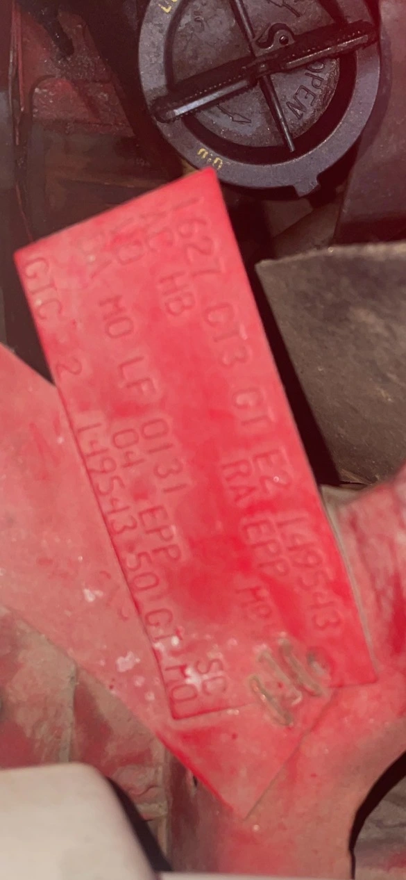

HI all! I'm looking for more info on this car. The vin tag is missing on the dash pad but the buck tag is on the rad support. Is it possible to get the complete vin from the buck tag as well as decipher the cars specs?

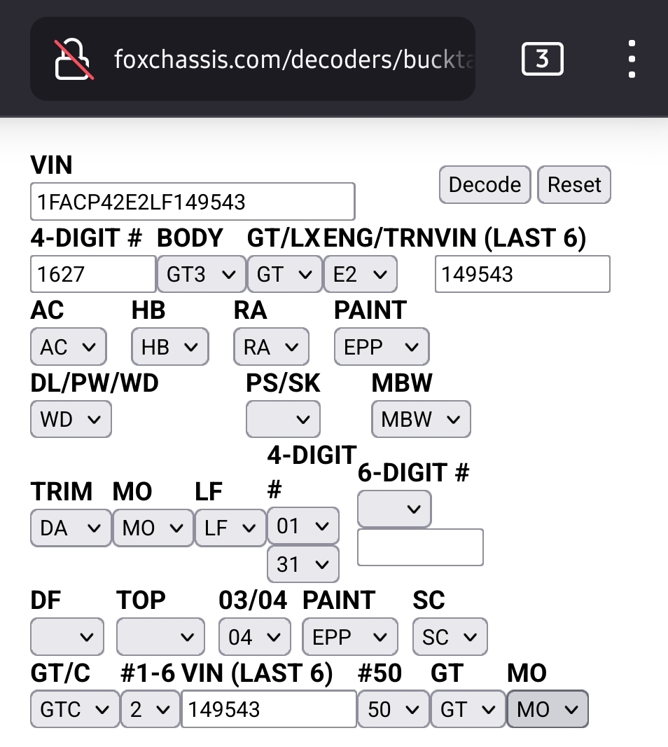

1627 = body & paint rotations #1627
GT3 = Mustang GT 2-door hatchback
GT = GT model/trim level
E2 = SEFI H.O. 5.0L engine (E), Borg Warner T-5 5-speed manual transmission (2)
149543 = 49,543rd 1990 Ford scheduled for production at Dearborn Assembly
AC = manual air conditioner
HB = heated backlite (rear defrost)
RA = road abrasion coating (lower bodyside protection)
EPP = Bright Red exterior paint color
WD = power side windows (W), power door locks (D)
MBW = manual Borg Warner (T-5 5-speed manual transmission)
DA = cloth Articulated Sport seating, low-back front buckets (D), Titanium interior trim color (A)
MO = moonroof (sunroof)
LF = 1990 model year (L), Dearborn Assembly (F)
0131 = January 31st scheduled buck date
04
SC = speed control (cruise control)
GTC = Cobra GT model/trim level
50 = 5.0L engine
Reactions: 91AOD5.0LX

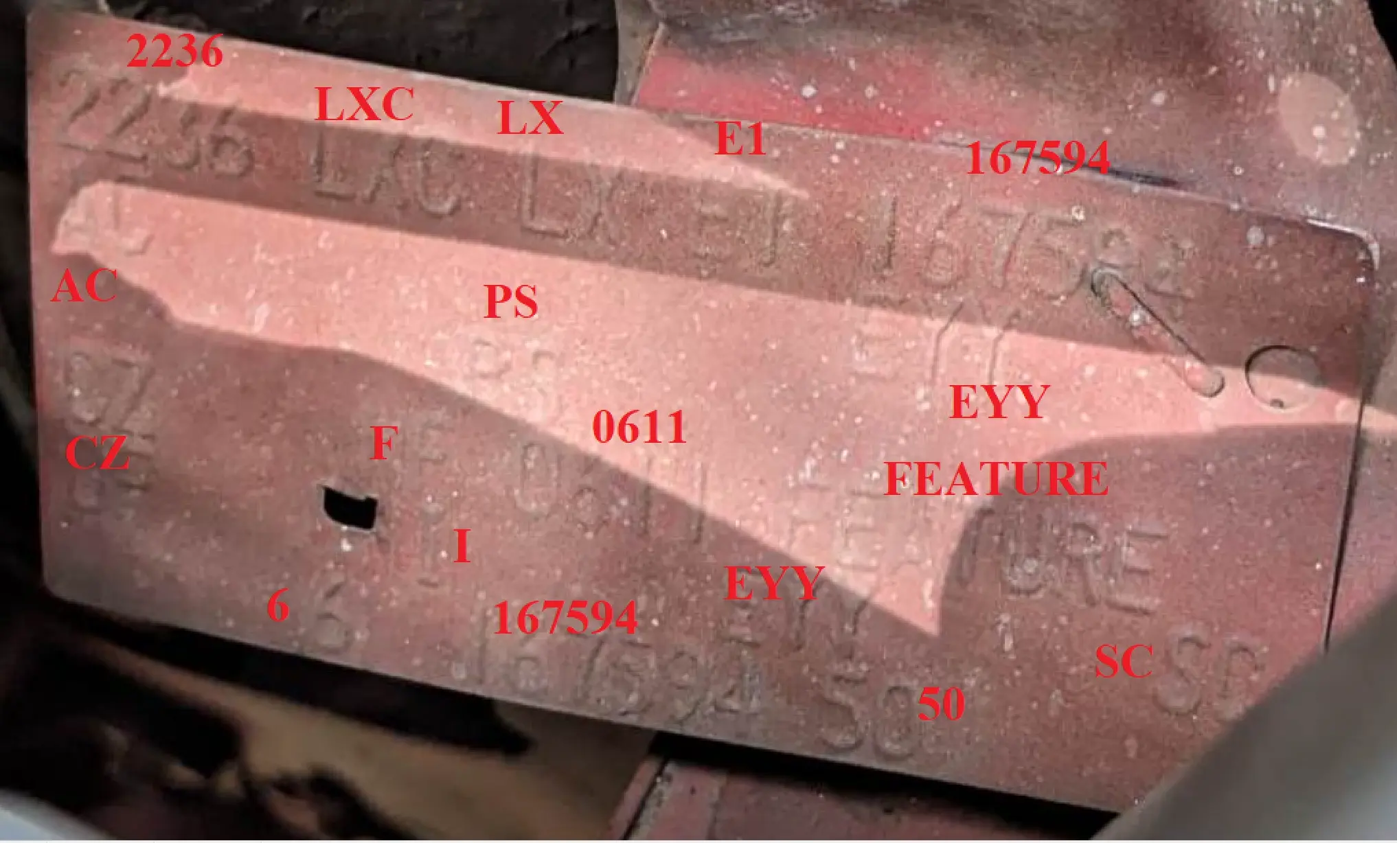

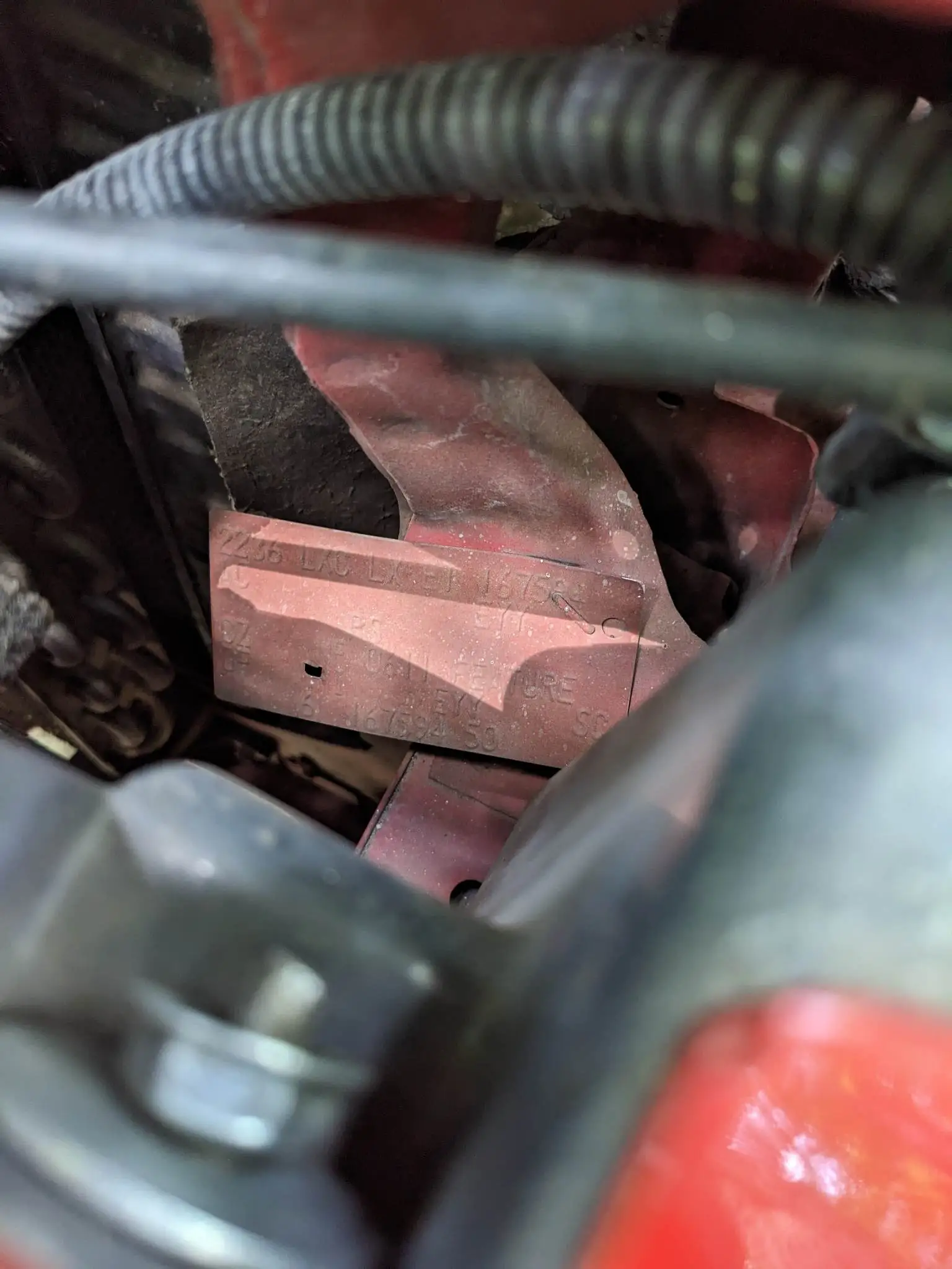

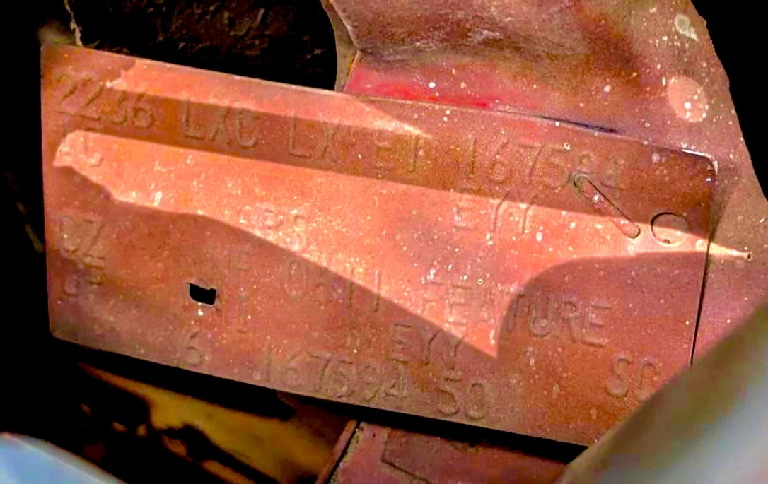

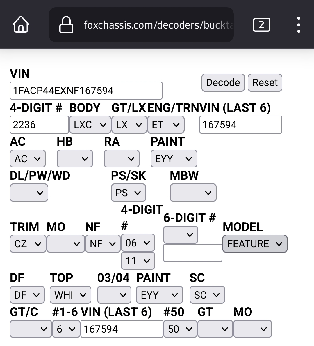

2236 = body & paint assembly line rotations #2236
LXC = Mustang LX 2-door convertible
LX = LX model/trim level
ET = SEFI H.O. 5.0L engine (E), AOD automatic transmission (T)
167594 = 67,594th 1992 Ford scheduled for production at Dearborn Assembly
EYY = Vibrant Red exterior paint color
PS
CZ = leather Articulated Sport seating, low-back front buckets (C), White interior trim color (Z)
NF = 1992 model year (N), Dearborn Assembly (F)
0611 = June 11th scheduled buck date
FEATURE = LX 5.0L Convertible Feature Car
DF
WHI = White convertible top color
50 = 5.0L engine
