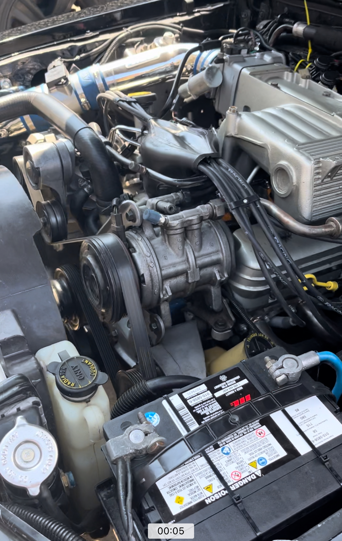

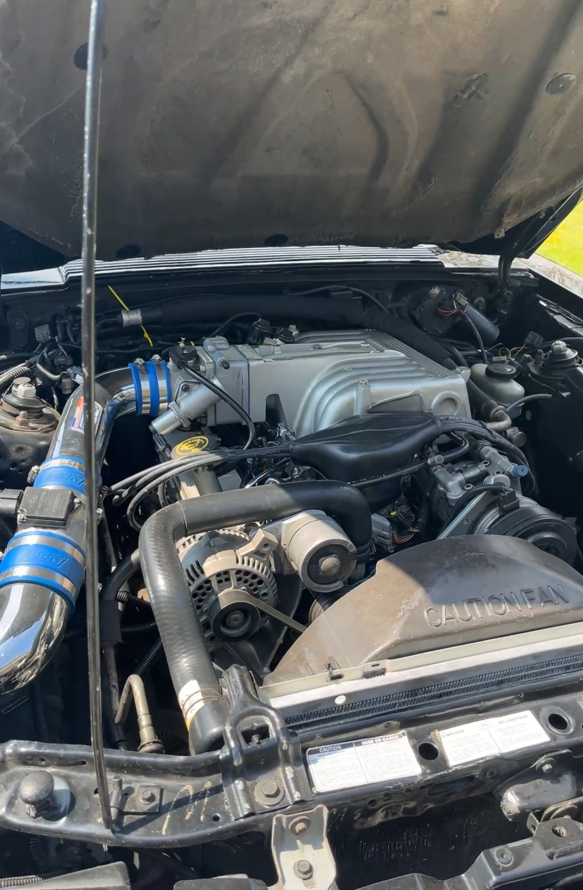

So I have an 88 LX mustang. I bought it last year and have been fighting to get it running properly from day 1. I have learned a lot. The previous owner did a ton of mods to the car. Great guy, fairly meticulous with his work. Car has gt 40 heads,B cam, bbk CAI, headers ect. Pretty much every bolt on mod you can do. Car ran rough when I bought it so I tracked down some issues. There were some vacuum lines that needed to be closed off, I had to buy an EGR simulator, relocate ACT, did time and idle reset, changed fuel filter…and got it running like a dream….for 1 day. The car now acts like it is possessed. It will idle perfect but when I go to drive it, the rpm’s spike and the cars lurches hard. Not safe to drive at all. I bought a code reader and the only code it’s really giving me is 95o which is the fuel system relay. A friend had suggested that the sock on the fuel sending unit may be full of debris and could cause issues but fuel pressure gauge at idle is reading 40psi. I love this car. It’s loud and obnoxious, it’s a Mustang! Any advice would be greatly appreciated.
Answer a couple questions; injector size,have you checked the TPS, reset the computer, ahh..lets see a pic of the engine compartment (dog house)...
keep in mind that a B cam may need to idle a little higher which requires some stuff to be reset, at least mine did, 800-900rpms, mine also bucked at low speed like shelp'n around a parking lot, but lets see what you got going on.

I did a base idle reset. Battery off for half hour, step by step. TPS is set at 9.6v and no timing advance ect. Idle is at 750-800. I changed out the fuel filter because I was getting hesitation when cruising. After I replaced the fuel filter the car ran beautiful. Next day I hop in to go for a tour and the gremlins were back.

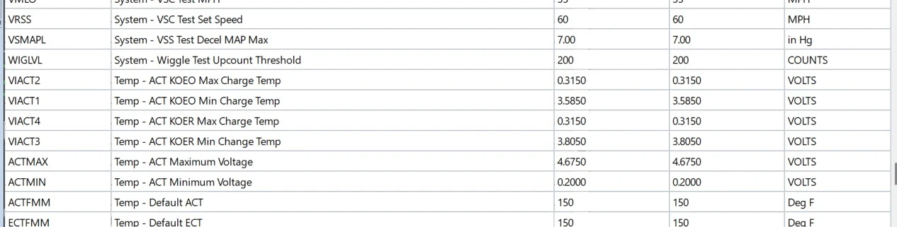

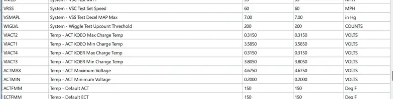

By relocating the ACT to the airtube you have changed the ACT settings harshly.....Id either get a tuning chip or put the ACT sensor back in the stock location.
Theres just too many factors that are controlled by the ACT sensor especially melded with the ECT sensor in some settings too..

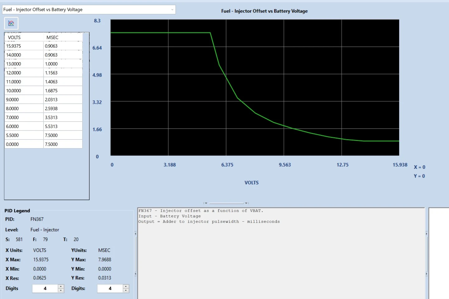

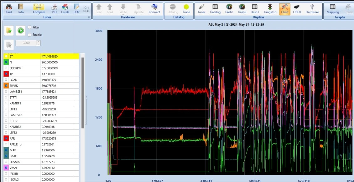

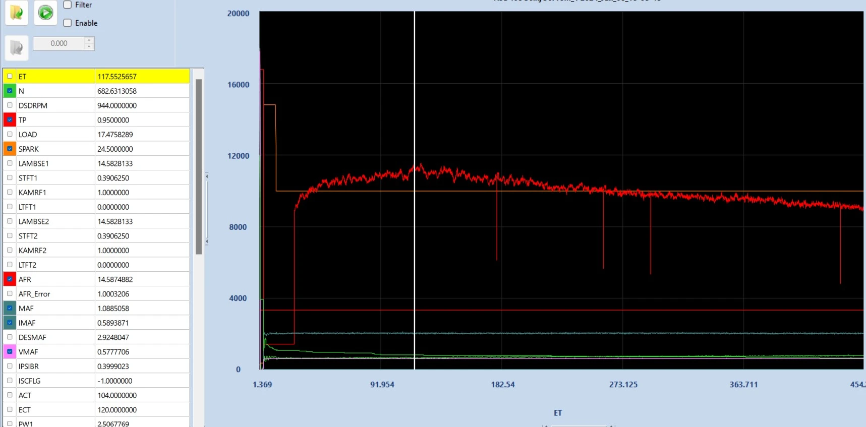

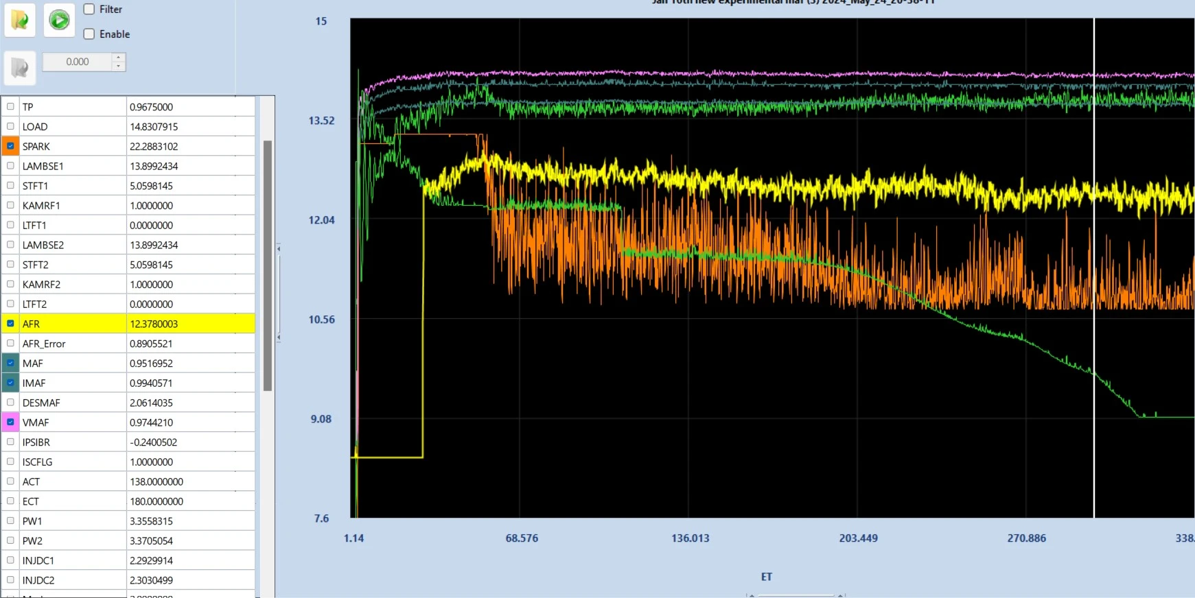

My buddy built an 84 T-Bird with a 351w out of a F150 plus wiring harness also ECU out of an 89 Mustang and first used a 70mm MAF to match the twin 35mm TB that turned out to be for a 95 T-Bird instead of a Cobra and despite the mix-match still got the tune pretty good but not spectacular so he got a 75mm Pro-M MAF Bullet that was calibrated for the 351w plus decided he wanted to relocate the ACT to the intake tube and calls me saying all hells breaking loose so he brought the car over and I popped in the chip and did a quick around the block logfile..
This was the logfile after fixing the initial 70mm MAF mixmatch issues but neglected to check the fuel pressure as my buddy said he had it covered via the internet yet he actually didnt and it took quite a bit of finagelling to get the stoich to 14 then try more mods and a different MAF and muck it up badly......LOL

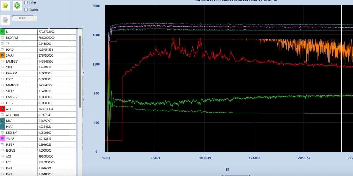

If you look at the logfile below at where the timing was at-at just 960rpm's driving around the block with initial timing set to 12* and the fuel pressure set to 43psi with the hose disconnected and 39psi with it connected instead of 39psi with line disconnected and 35.4psi with vacuum line connected............
Whats oddly funny is this T-Bird was bucking like a Bronco too plus he was lucky to still have the headgaskets with the timing spiking to almost 60 degrees advanced and the AFR at over 17 stoich.....LOL

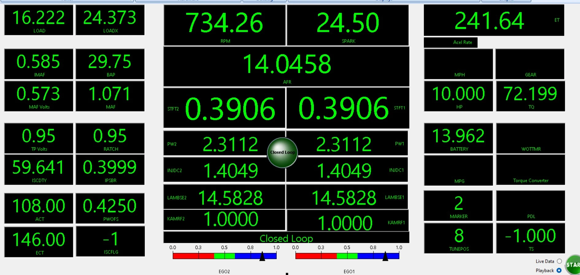

Thats what basically happens when you put aftermarket goodies also do aftermarket mods and dont have a way to datalog to know what was going on...
After clearing up a whole bunch of stuff via my chip I used a Star tool to burn the updated tune direct to the ECU...

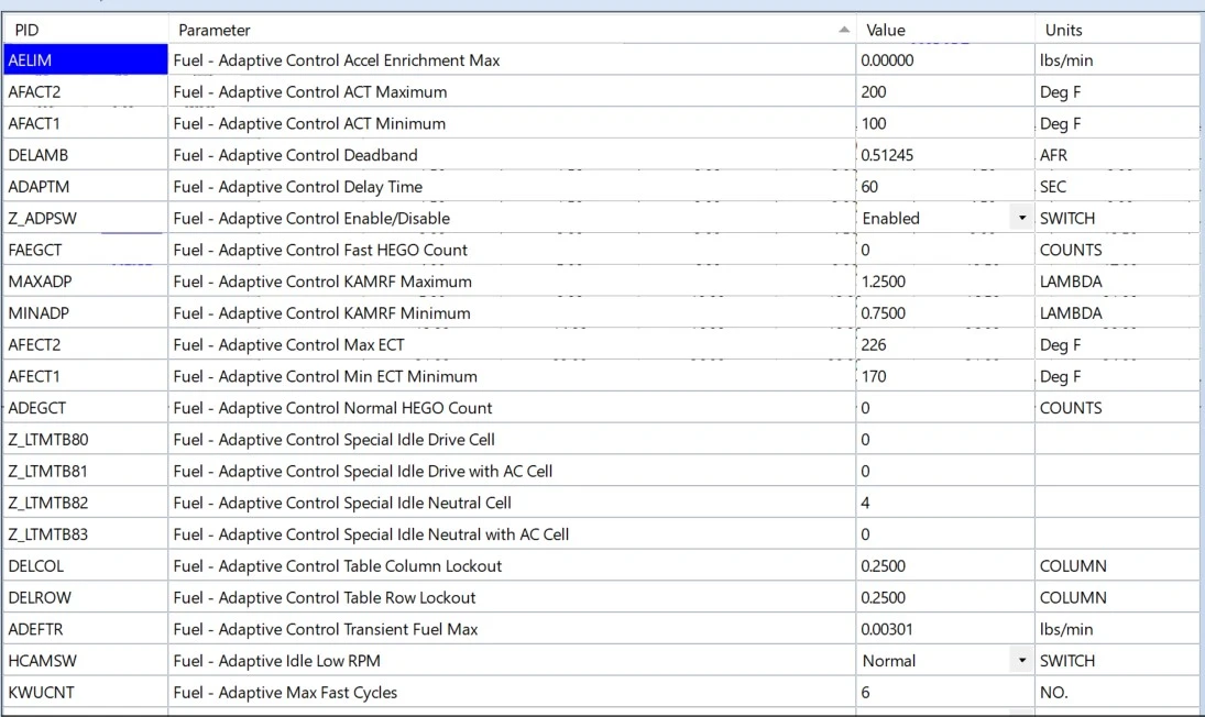

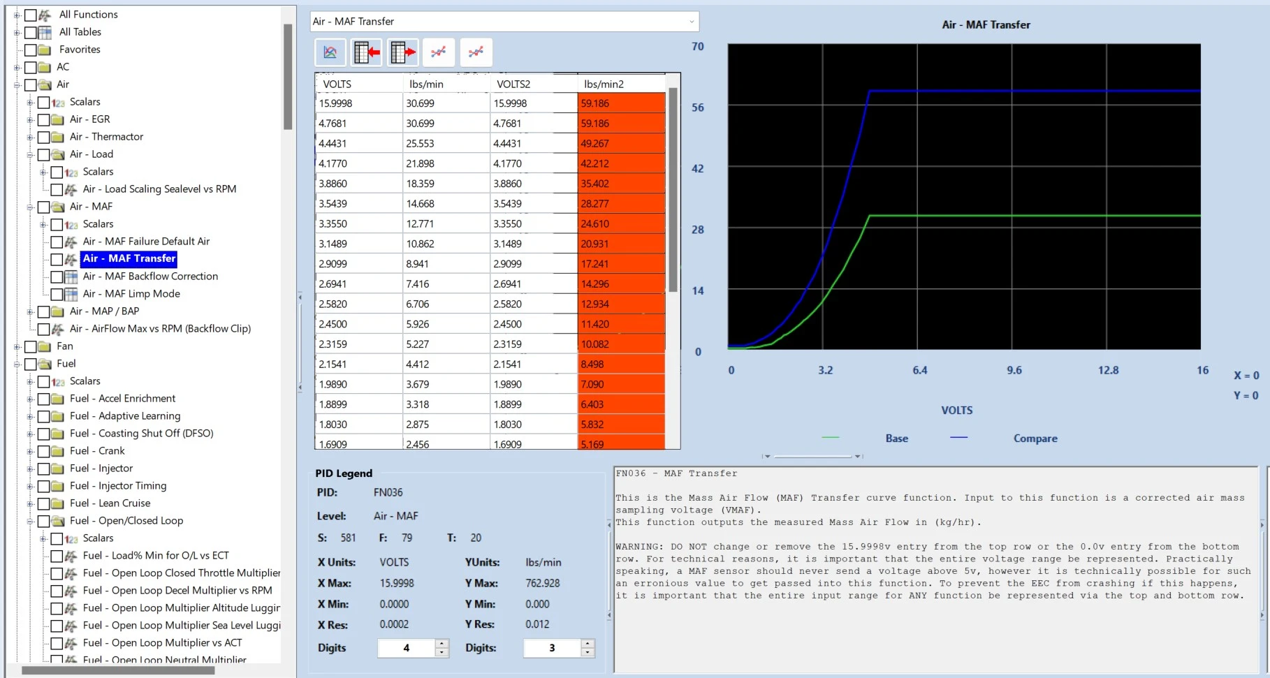

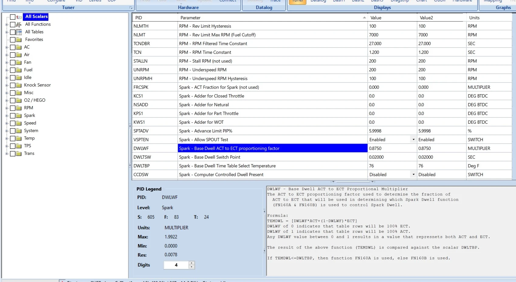

You may still also need to adjust your MAF transfer function............The ProM 75mm Bullet came calibrated and the calibration numbers that came on the sheet was 15% too much.....Its the same deal for all calibrated MAFs not being dead on because all engines arent exactly the same nor do they flow the same. so unless the guy calibrating the MAF is using your car the chances of having an exact match is a longshot.....
As you can see below that the ProM 75mm Bullet transfer is alot taller than a stock A9L and had to be manually added ..If you dont get the flow to voltage numbers smoothly entered the injectors will squirt the wrong amount of fuel also to mention will max out quickly..

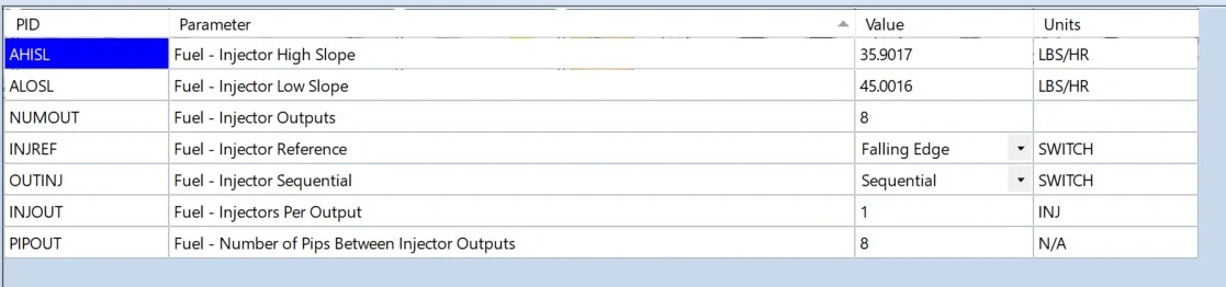

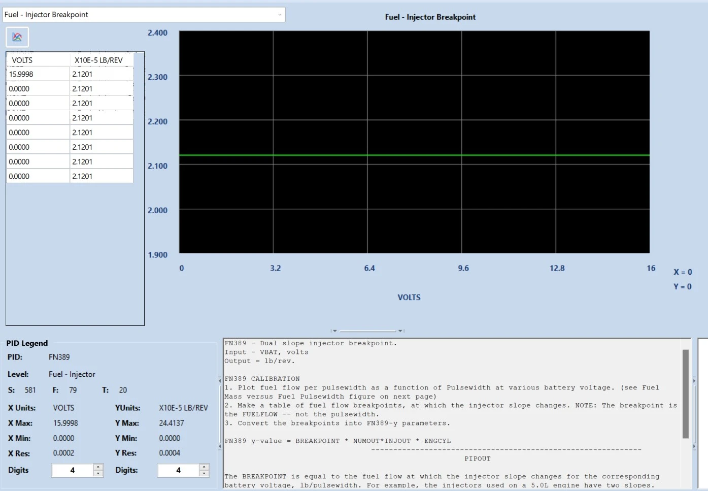

If youre using bigger injectors you must match the high and low slope aswell as breakpoint numbers or youll overheat the injectors...

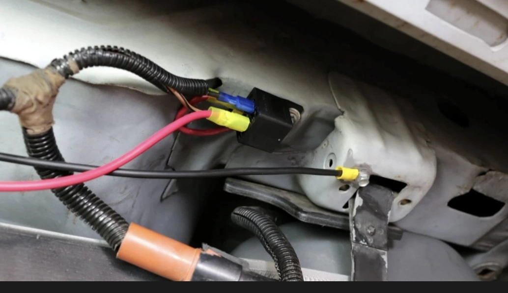

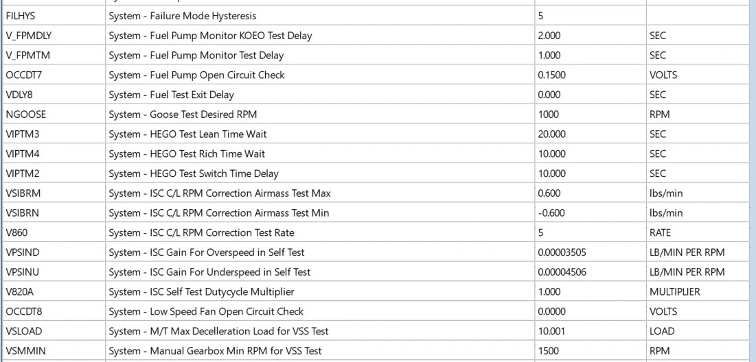

When most upgrade the fuelpump they rewire the fuelpump and separate it from the ECU and thats wrong if you dont have a chip to adjust the voltage to injector deal as the pink wire adjusts the fuel pump voltage to the fuelpump monitoring pin on the ECU plug....
One time I added a 255lph pump plus separated the fuel pump monitoring wire from my wiring and wired in a very good relay....
I noticed that on my fuel pressure gauge on the dash that when my voltage changed so did my fuel pressure and when my voltage fluxuated wildly from the upgraded G3 alternator my fuel pressure raised from the stock setting up to 42-45psi ..
With the ECU not being able to slow the fuelpump made my engine sound like it had a lumpy camshaft installed at redlights and smelled pretty heavily of gas due to not being able to slow the pump then it cooked my injectors by overdriving them against their will causing them to leak fuel pressure as they sat also to mention messed with my closed loop calculations forcing me to run always in Open Loop or always reset the computer daily..
What made me notice the issue with the excessive voltage to fuelpump speed increase was when I was running the two 600watt self powered subs and the 1500 watt amp pretty loudly while driving around the car ran pretty smoothly..
Once I put the stock fuelpump wiring back to the 255lph pump and changed out the injectors my fueling issues stopped....
