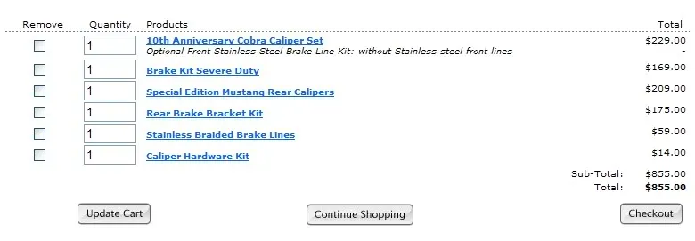

+1. i wish i had some coin. i would have bought everything in the shoping cart in that picture i uploaded. :)

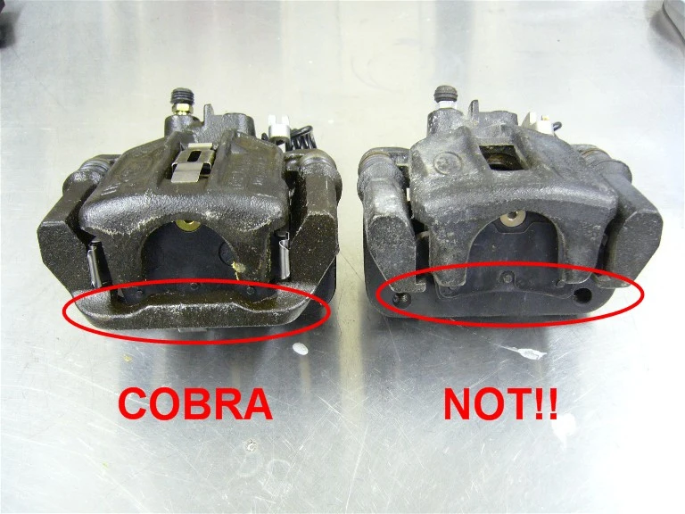

You are right. GT is 10.5" solid and Cobra is 11.65" vented.
The caliper is exactly the same. The part the brake hose connects to, that clamps on the pads is the same between a 1994 V6 and a 2004 Cobra.
The difference in rotor height is made up by the axle brackets. The larger Cobra brackets are included in the M-2300-M kit.
Another difference in the caliper is the U-shaped bracket which supports the pads. On the GT and v6 it is the same open face bracket. On the cobra, it's reinforced and has a wider slot for the rotor. But the actual caliper is the same.
That's why i suggested either modifying the GT bracket to fit the cobra rotor, or reuse your GT calipers and just purchase the Cobra u-brackets for $80 from Ford.
Also, the pads are different. The Cobra pads are thinner. If you use GT pads (new...worn pads may work) they won't fit over the rotor.
