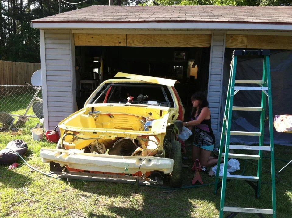

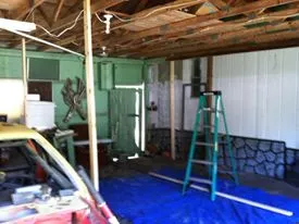

Built a Paint booth in my garage and painted the car myelf.

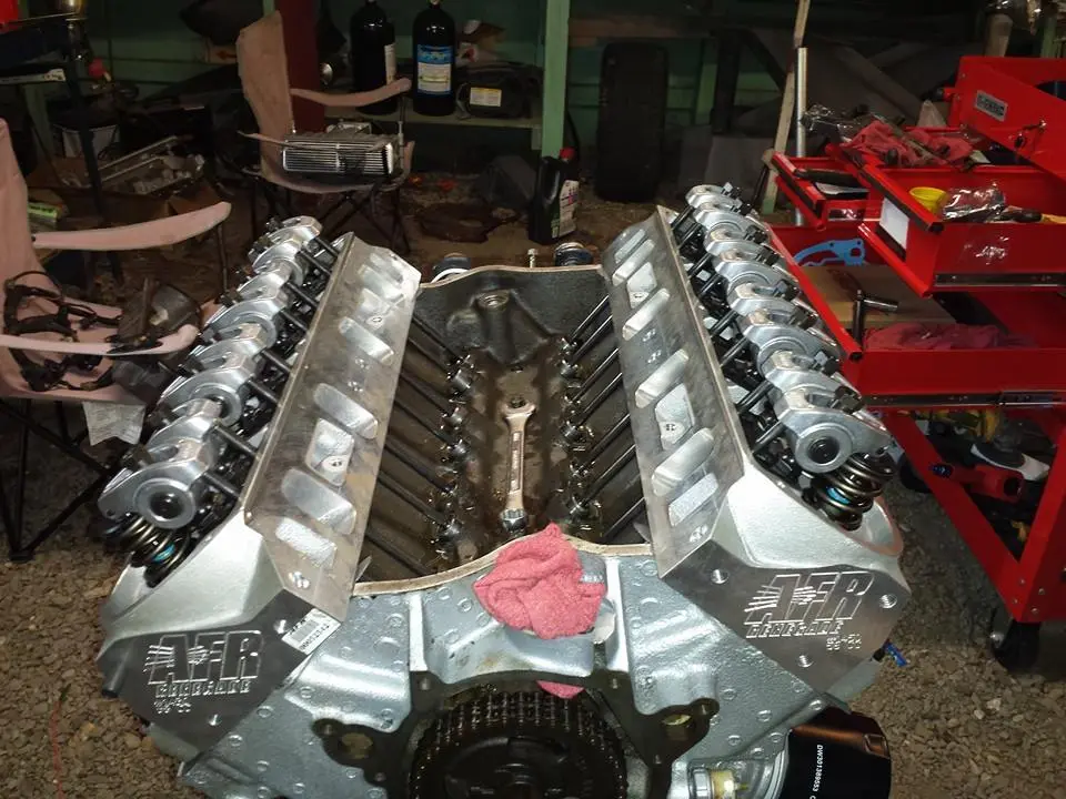

Me being me, I'm never happy. Screwing around on ebay one day I put in a best offer for a 351w with 300k miles on it and won the bid. (somthing like $300 shipped) Sold the 302 to my dad. And started gathering parts for the 351w. Afr 205 58cc heads. BBK Long tube headers. Anderson PMS tuner. 42lb injectors. Victor jr intake (drilled for injectors) And A comp cam. Didnt even freshen the motor up. Infact My piston to valve clearance wouldnt work with the stock pistons. So I did some reading as I was broke from buying everything up to the point. Read about a tool you could rent to notch the pistons yourself. Very expensive, but I also came across someone who talked about taking one of the valves and gluing sandpaper to it and notching it himself. So thats what I did! And it worked very well!

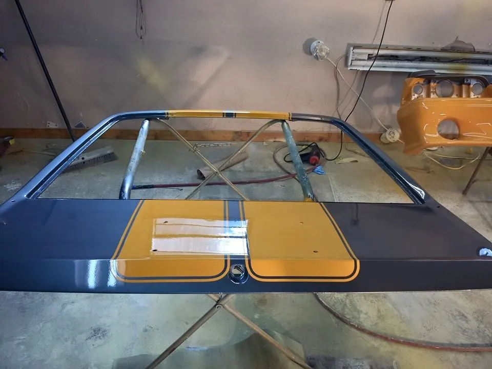

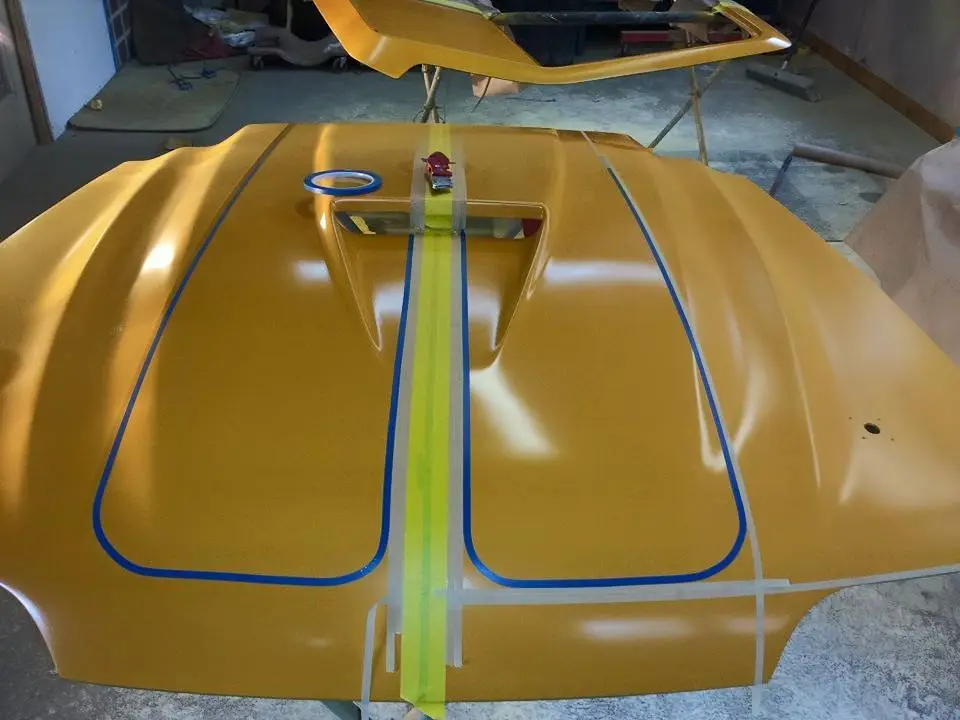

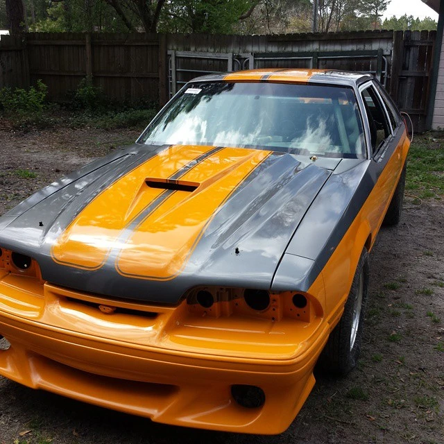

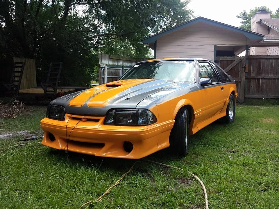

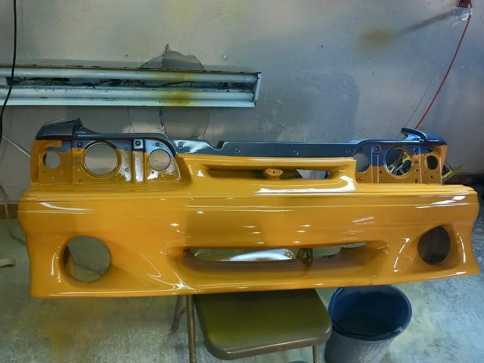

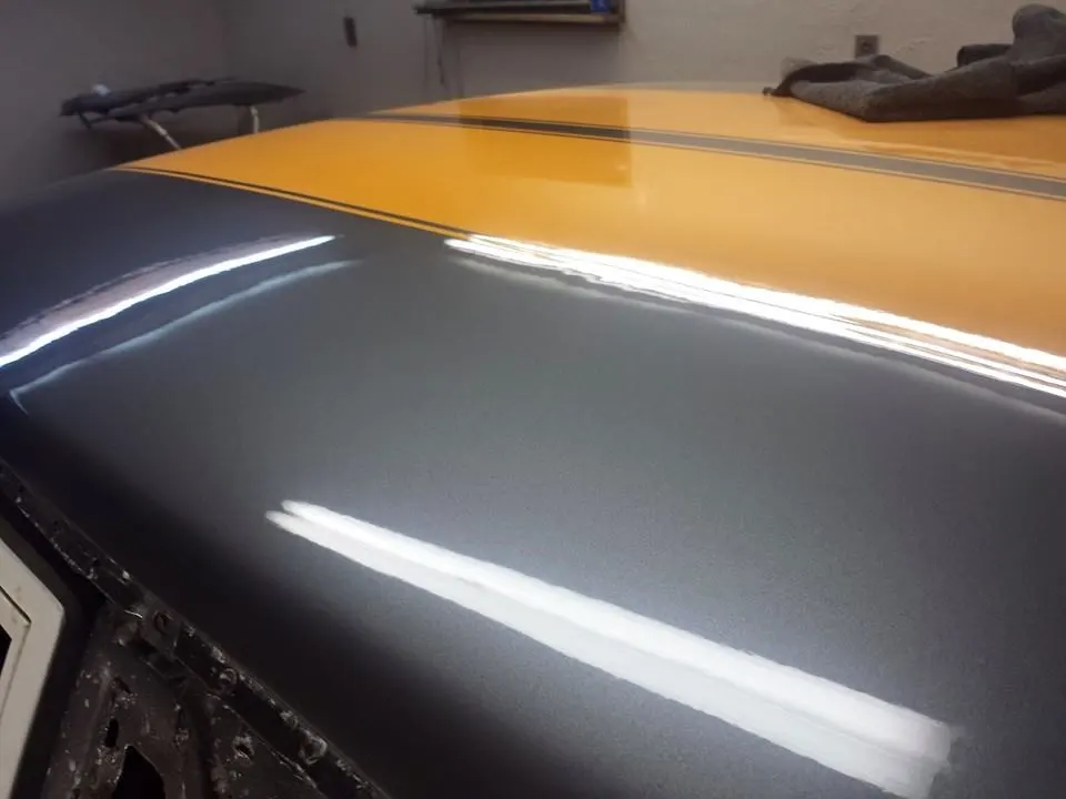

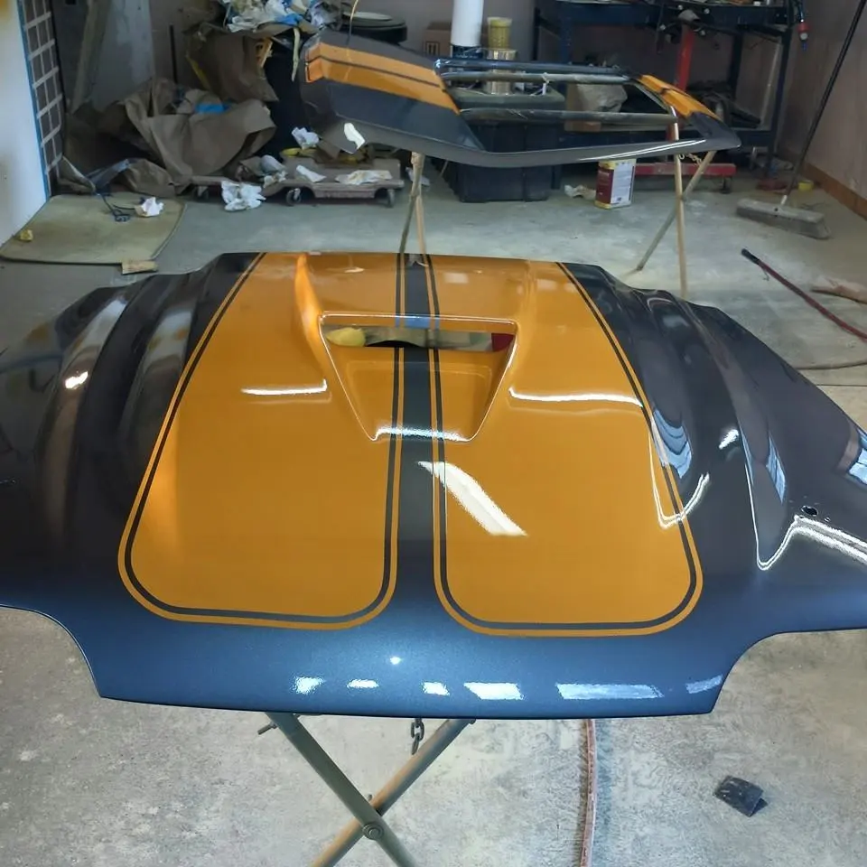

And started all over. End up moving out of the house we were in and buying one. Engine ended up being fine. Drained the oil, drained the gas tank. Aired out the car. painted the car ended up changing a few things. Didnt come out as clean as the first time because I didnt take the time to hang all the plastic up in the new garage.
11065612_997301116961662_6694456227427847160_n.webp 11159562_997301160294991_8617905236102419250_n.webp 10653332_997301006961673_669144636140160694_n.webp 11148700_997300893628351_5930465557624967854_n.webp
Reactions: Davedacarpainter
10406531_997300563628384_6645579768704994034_n.webp 11071931_997301366961637_6660244640748214634_n.webp 11156266_997300740295033_5819576921271747756_n.webp 10987740_961486240543150_4010681877114946057_n.webp 11041715_973552102669897_6189648111146902399_n.webp 11173400_997300163628424_2388213779459837580_n.webp 11146260_997300400295067_5488980816988931394_n.webp
Btw the is only the second time ever painting a car. The first time was when it was all orange. 1780914_1016786061679834_995749225385290849_n.webp

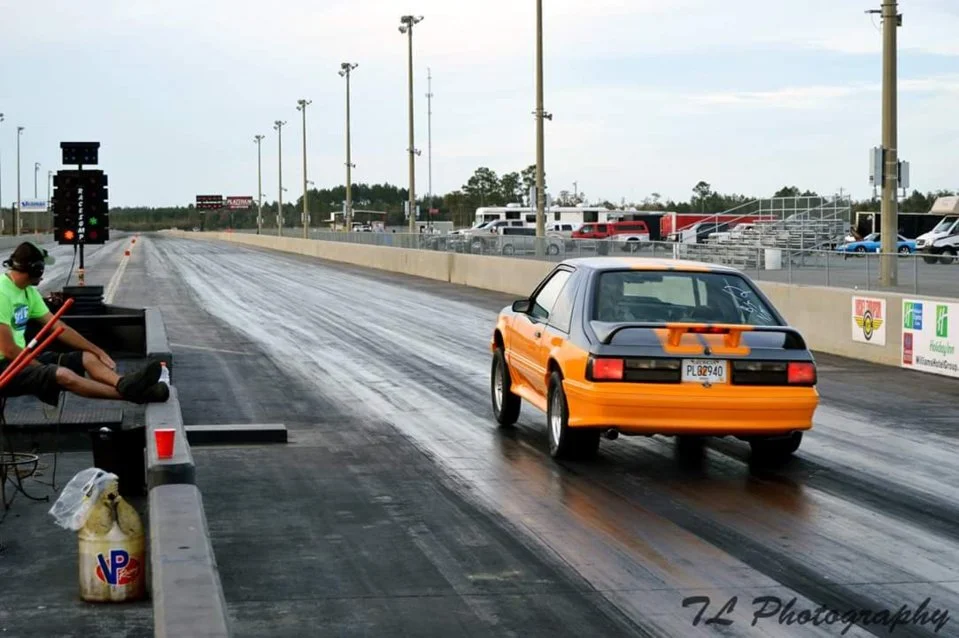

Take the car to the track finally and bust off a 11.9 third pass. 12186514_1118335001524939_1184178752712833482_o.webp

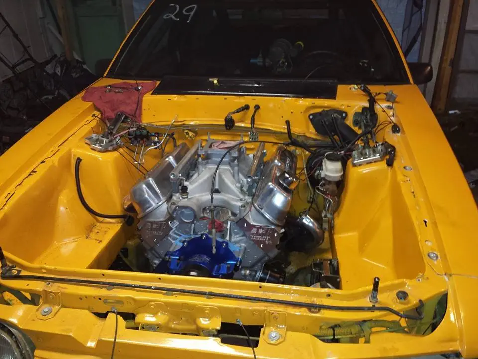

So I find a kit on ebay at a decent price. Buy the kit. And start tearing the car down 12991073_1236065729751865_2723940687374449312_n.webp .
I will be ordering a dart block 408. Thinking 11-1 compression. But I will be putting the turbo kit on the junk yard 351w just to get a feel for tuning a turbo car. Kit should be here tomorrow. I will try to take lots of pictures and keep you updated!

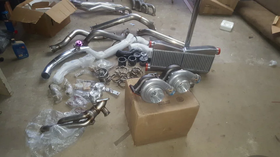

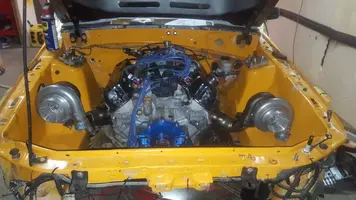

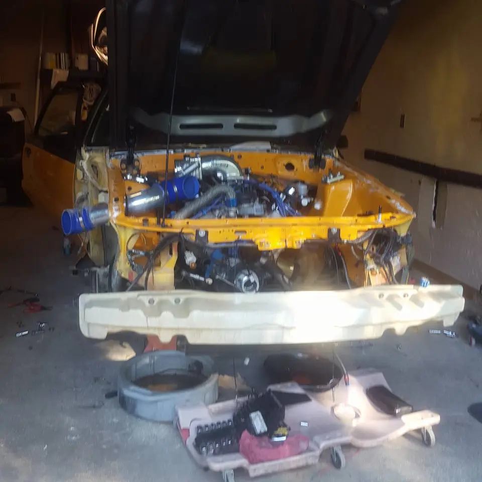

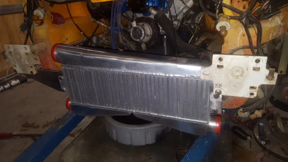

Got off work late. Didn't have much time to mess with it. Got the intercooler mounted. Bolt holes don't really line up like you would think they would. 20160412_211703.webp

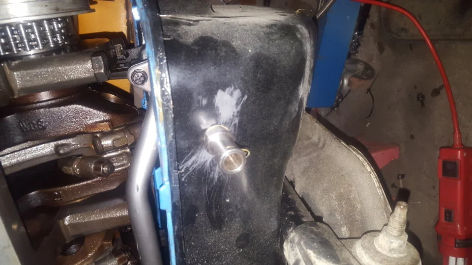

And I'm gonna have to relocate my tranny cooler as it was in the way. Drilled the holes in the oil pan for the oil return bungs. And got those installed. 20160412_222622.webp one on each side. After using my step bit it left some burs on the inside and out. So had to file those down a bit. Which is why you see the scratches around it.

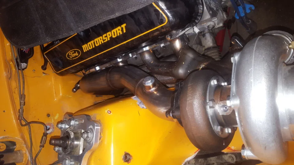

Mocked up the header to see how those were gonna work. Now remember this kit is for a 302 and not a 351. So I'm not sure if you would have these same issues. Alternator will have to be moved to the driver side. 20160412_222612.webp

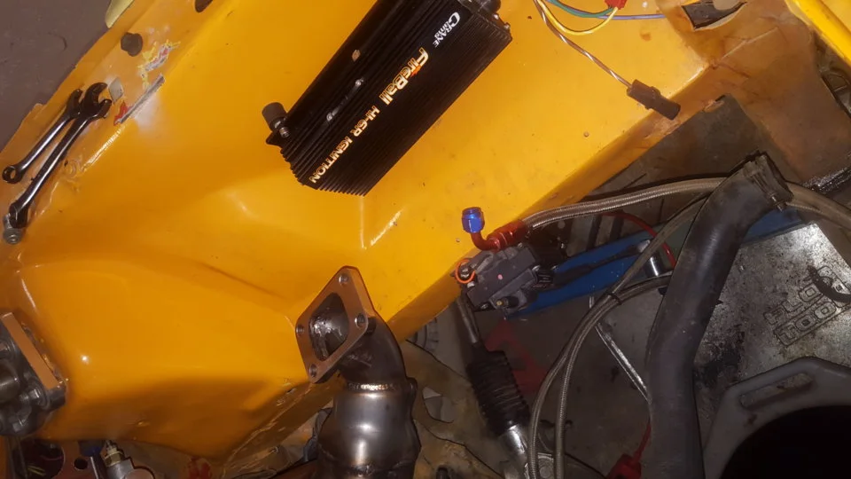

And I'm gonna have to move my coil and ignition box. 20160412_211718.webp as I'm sure if the turbo doesn't hit them. They will at least get melted.

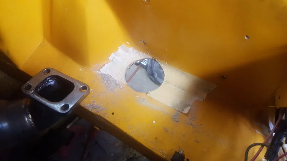

Little update. In one of the magazines they mentioned in order to add the oil drain plugs to the oil pan, you can jack up the engine enough to drop the pan and drill the holes. And still be able to clean out the pan. I spent 3-4 hours trying to get the pan back on as the gasket kept falling back into the pan. I tried apply a thick grease to the pan so the gasket would stick. But by the time i would hold the pan up to start the bolts the gasket would fall again. 20160413_200830.webp mocked the turbos up. This kit comes with 0 instructions. And as I wrote the company to ask for some, their reply was find some picture of it installed on the internet. So from the pictures I found the driver side turbo would go straight down into the inner fender. 20160414_120029.webp and the passenger would pass just by it. 20160414_121928.webp .

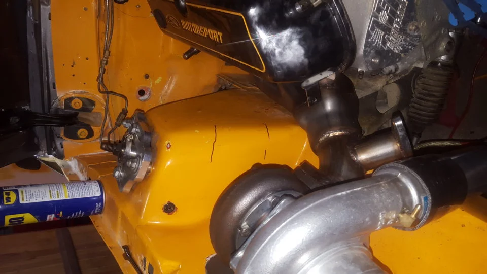

But then the wastegate hits the pressure tubing. So I took it down into the inner fender as well. 20160414_143132.webp
In doing so I had to cut one of the tubes and add a coupler to allow me to turn it 90 degrees. And order a 45 degree coupler 20160414_143123.webp .

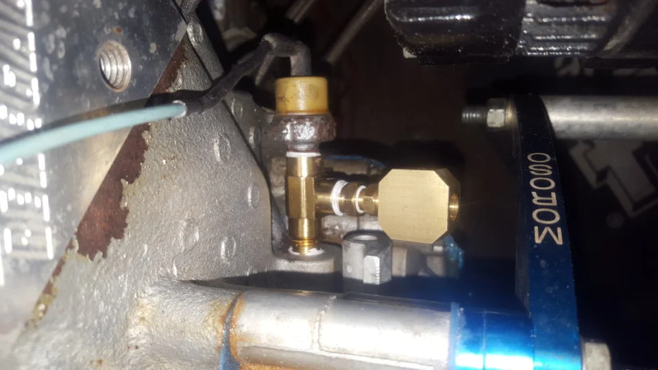

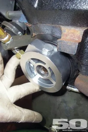

Some of the kits come with a oil cooler style fitting 1984-ford-mustang-driver-side-waste-gate.webp and some do not. I'm thinking the older kits came with it because i read you would need to run a shorter filter or relocate due to the driver side wastegate. Other kits come with a T they comes from the oil pressure sensor hole. 20160414_145024.webp

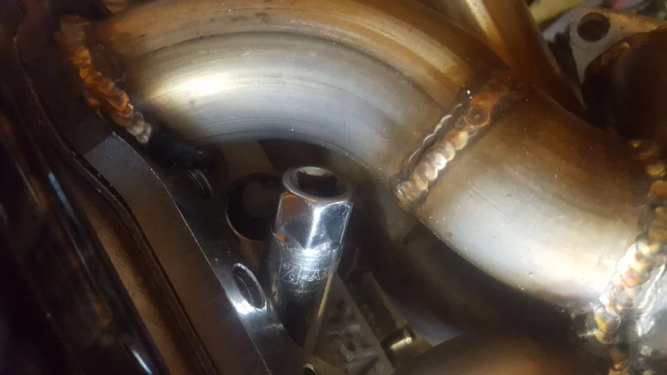

As for the headers a few of the tubes are turned so sharp that it was difficult to thread the header bolts in. And one of the tubes on driver side will be a pita to change plugs. 20160414_121009.webp When I install the 408 I will order some stainless header flanges with the 3" bolt spacing for my AFR heads to take advantage of the easier header bolt install.

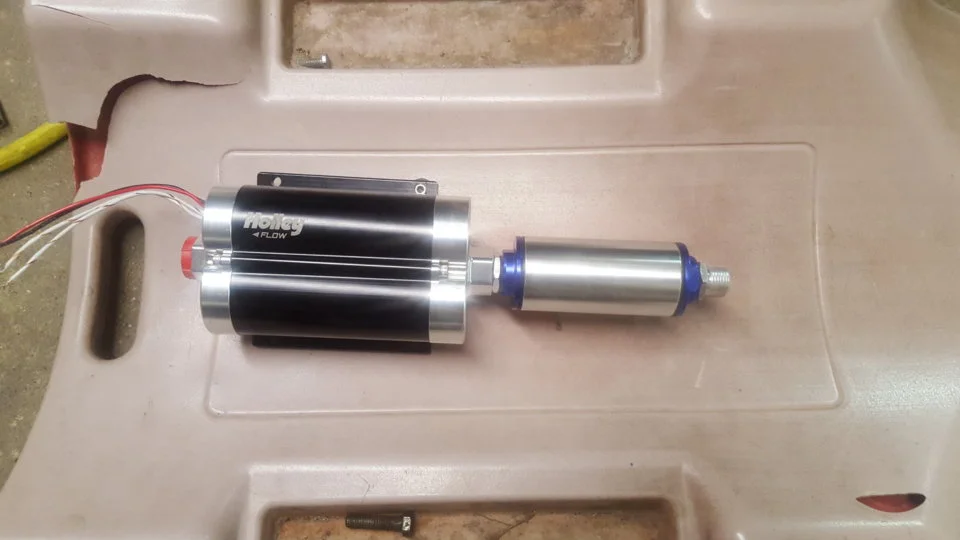

Some of my fuel system showed up. Was going to weld in a sump but decided against it. Instead ordered a fuel pick up tube from granatelli. Has a 10an feed and a 6an return.http://www.brotherswcBformance.com/...vPO3VqnzYpIg2LPbyzXDHVk2MKcaPSrkWrBoCEezw_wcB.
The pump is a holley 12-1800. As I'm running e85 it supports up to 1800hp efi -30% for e85 puts it around 1,260. 20160416_194240.webp

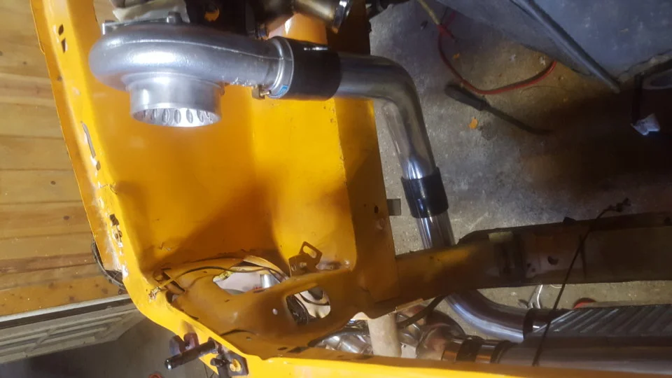

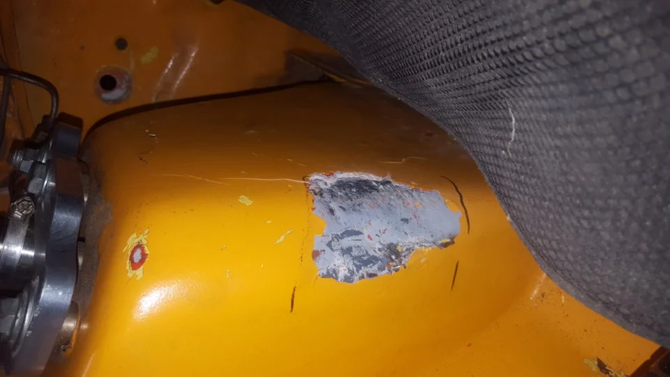

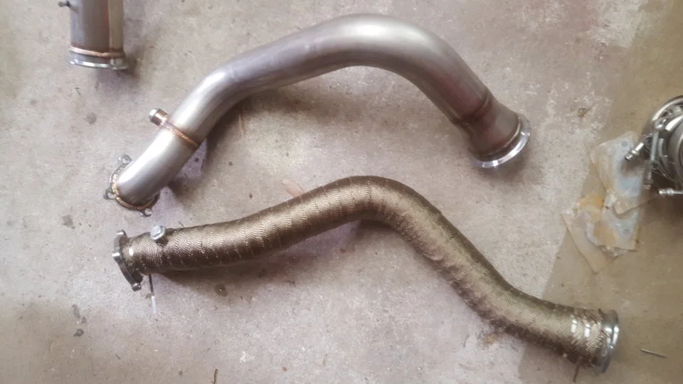

Also got the down pipes wrapped 20160416_170320.webp . Passenger side down pipe was hitting the shock tower and had to be massaged. 20160413_215832.webp 20160413_221154.webp 20160413_220625.webp . I will probably work it some more before installing the 408 as I plan to fill in some holes and repainting the bay.

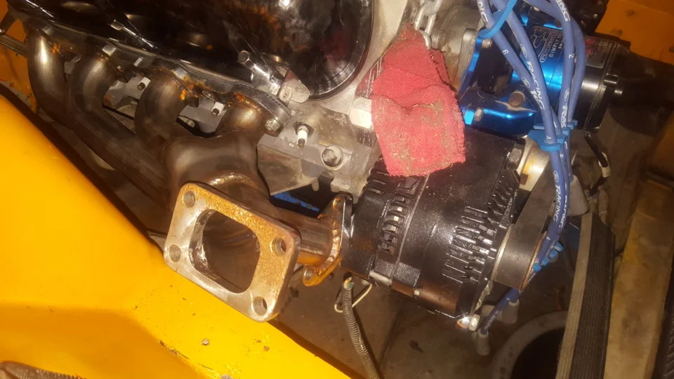

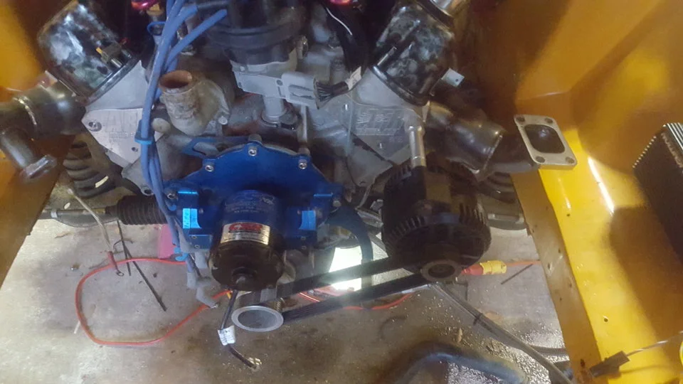

The passenger side turbo was hitting the alternator so it had to be moved to the driver side. It was then I found out the passenger side head sticks out about 3/4 of an inch more then the driver side. As I had to fabricate the mount. 20160413_193411.webp
As well as reroute the wires.
