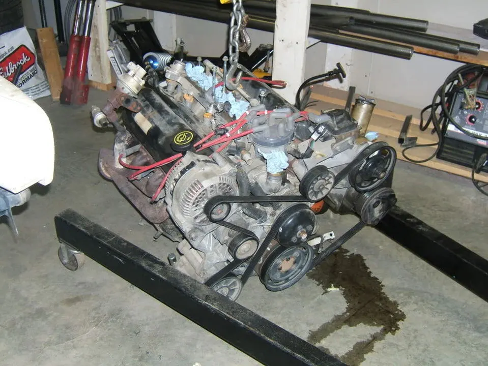

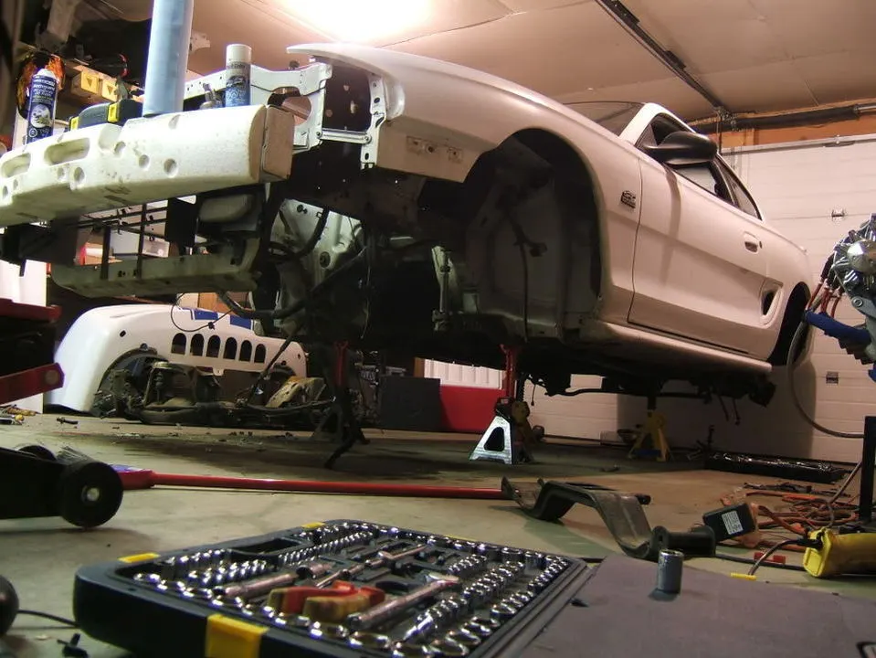

THIS IS THE MUSTANG POST 5.0L EXTRACTION
THE TIRED 5.0L SITS TO THE SIDE FOR A FUTURE PROJECT
STOCK K MEMBER REMOVED...WHAT A PIECE OF CRAP

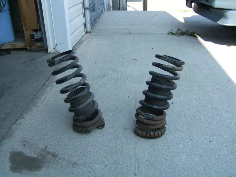

TO MY DELIGHT I FIND THE SPRING HAS BE PROFESSIONALLY LOWERED. LOL

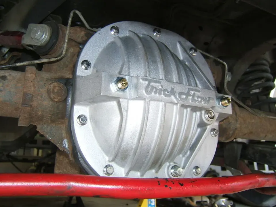

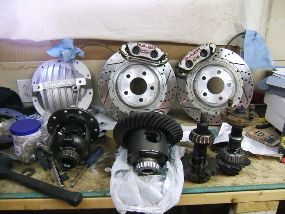

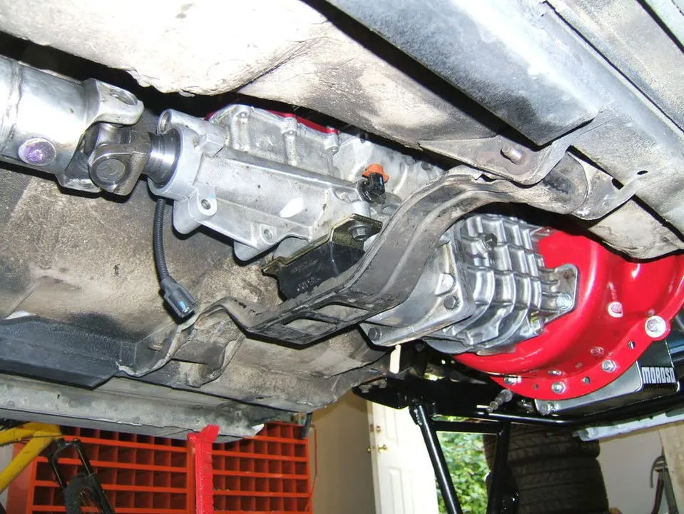

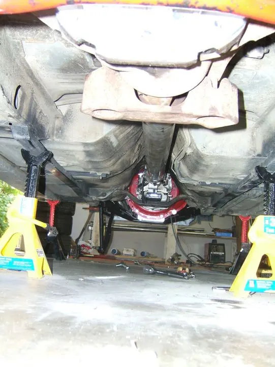

DETROIT TRUETRAC DIFF BESIDE STOCK. 3.73 GEARS. BAER BRAKES. DIFF COVER.

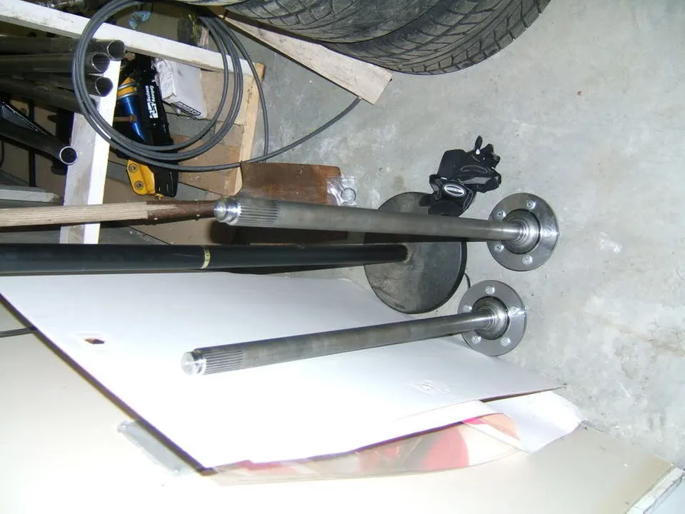

NEW 31 SPLISE MOSE AXLES

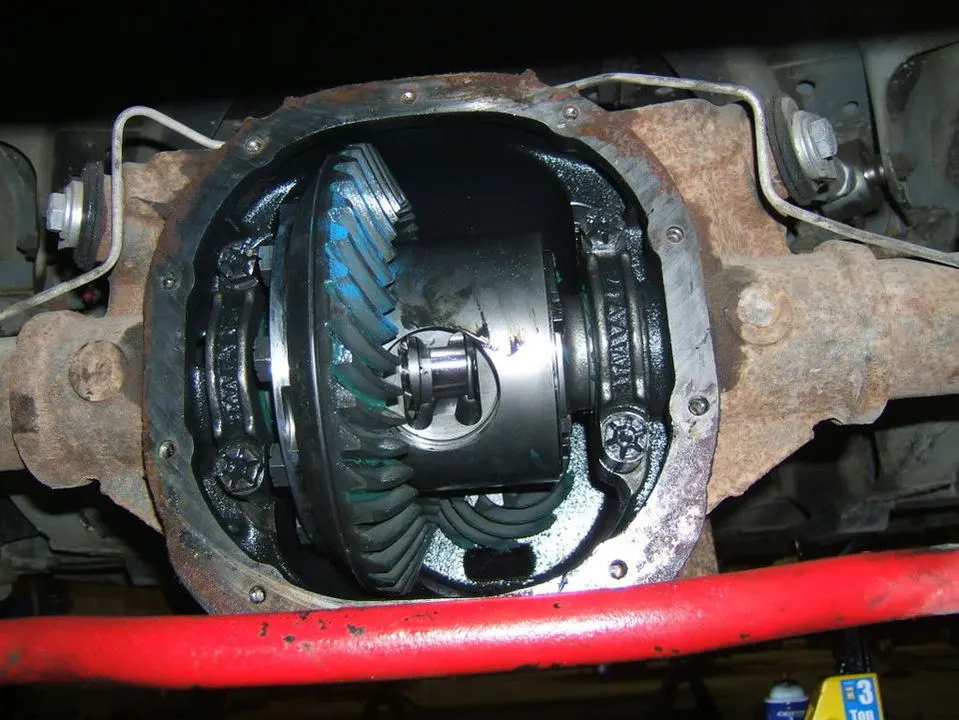

DIFF INSTALLED. DON'T MIND THE BLUE...I WOULD RATHER NOT TALK ABOUT IT. LOL.
DROOL...
REAR END COMPLETED

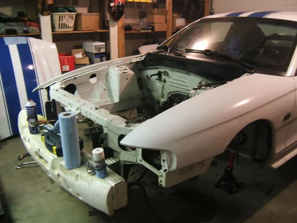

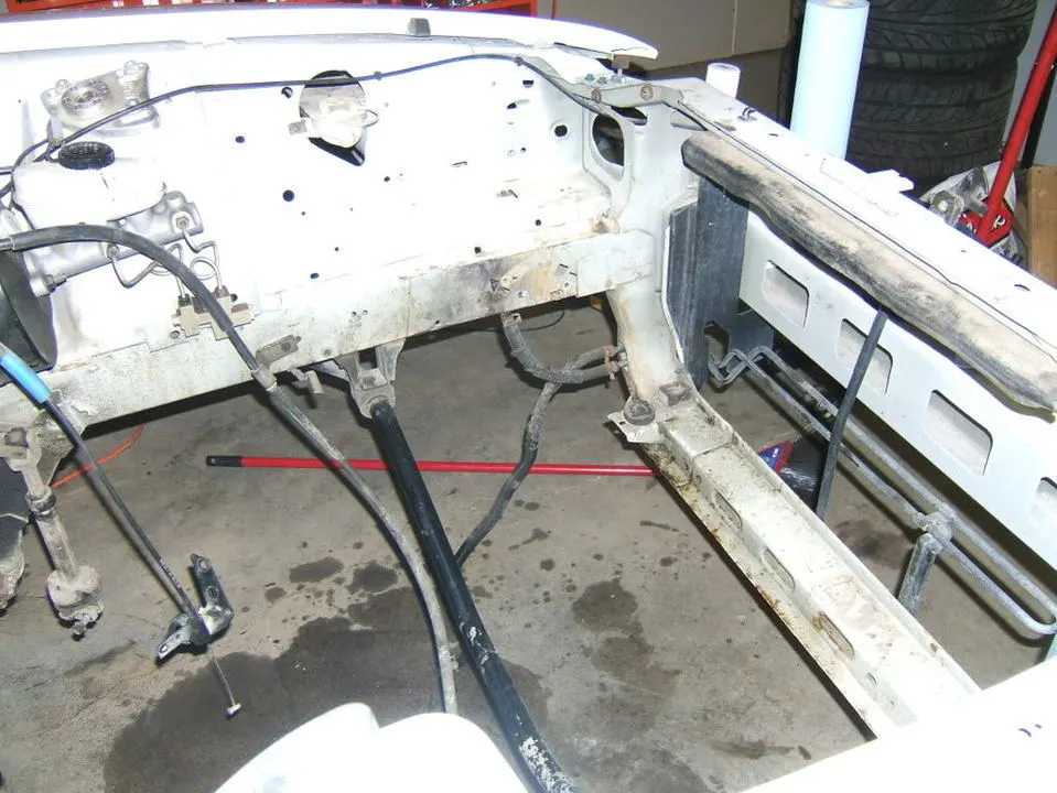

AN EMPTY WIPED DOWN ENGINE BAY
TIME FOR A SMOKE. WHAT DID I GET MYSELF INTO!

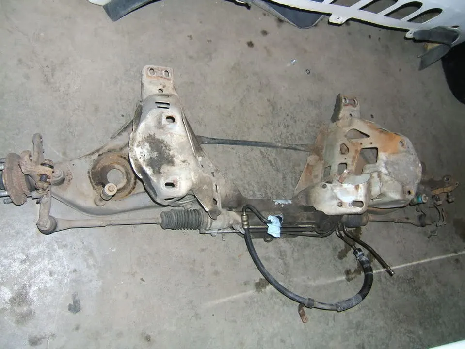

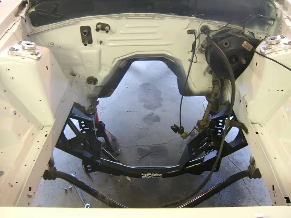

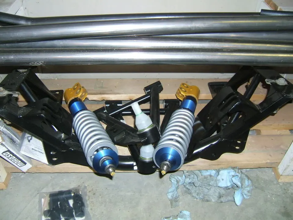

NEW MM K MEMBER, ARMS, AND KONI COIL OVERS
SPRAY BOMBED. UNIVERSAL WHITE WAS A MATCH. LOL.

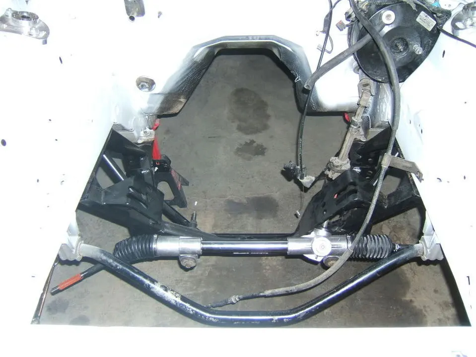

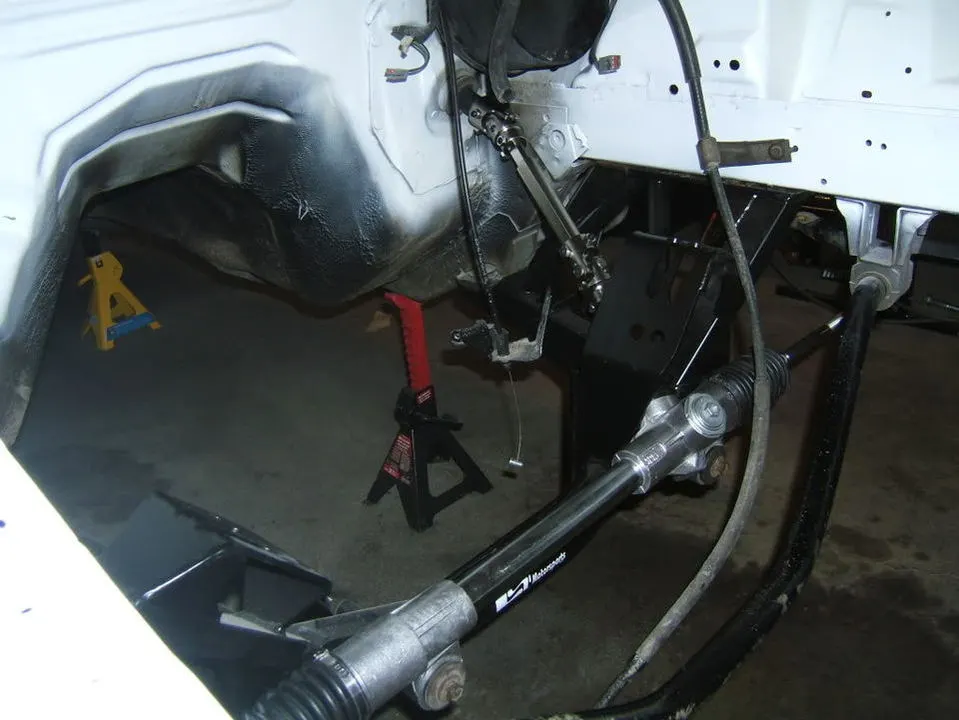

K MEMBER AND FLAMING RIVER MANUAL RACK INSTALLED
STEERING COLUMN ATTACHED

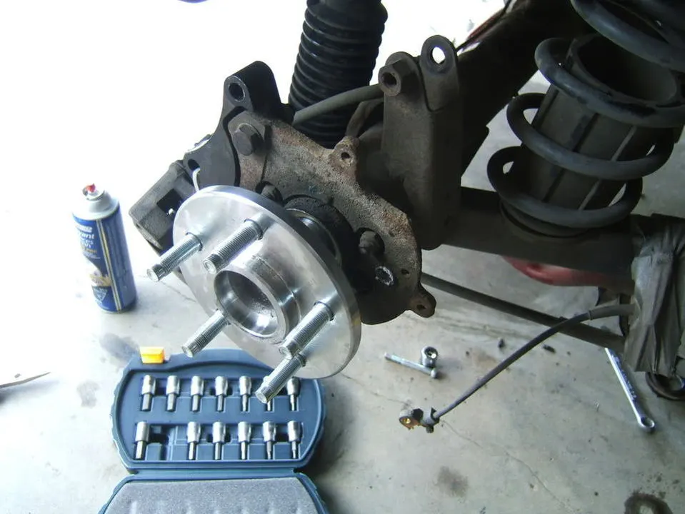

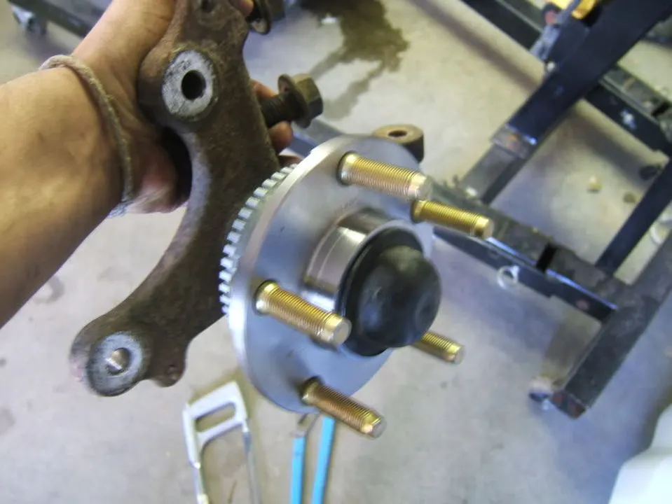

REPLACED FRONT BEARINGS

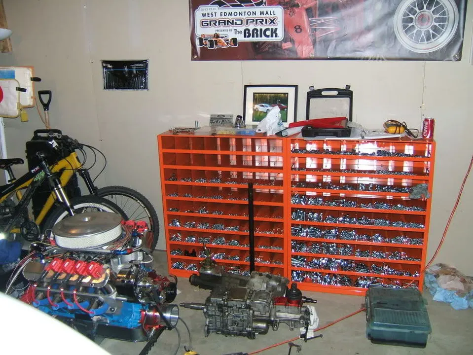

BOLTS!!! I LOVE BOLTS!!!

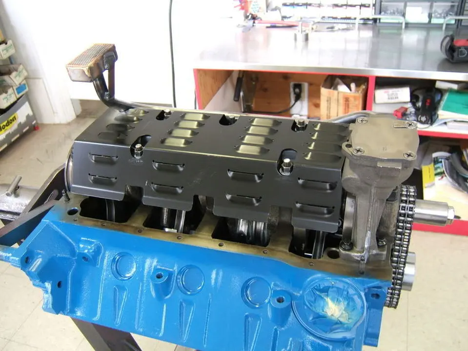

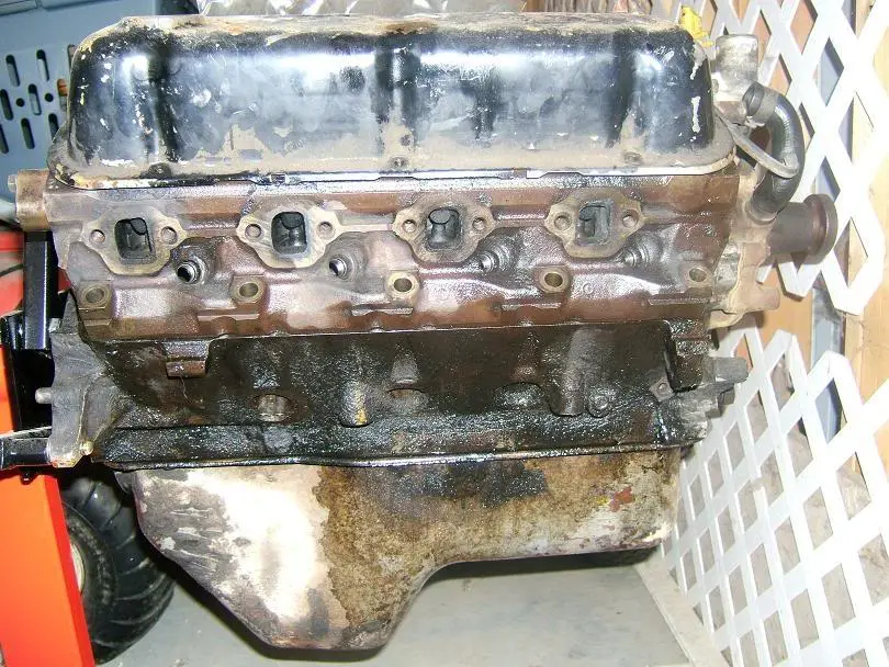

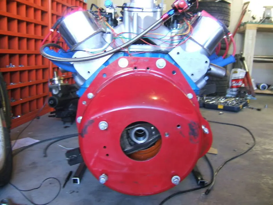

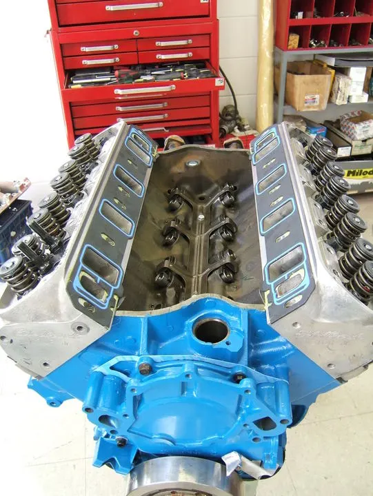

THE OLD 351W BLOCK I PULLED A FEW YEARS AGO FROM A TRUCK
NEARING THE END OF THE ENGINE BUILD ABOUT A YEAR AGO

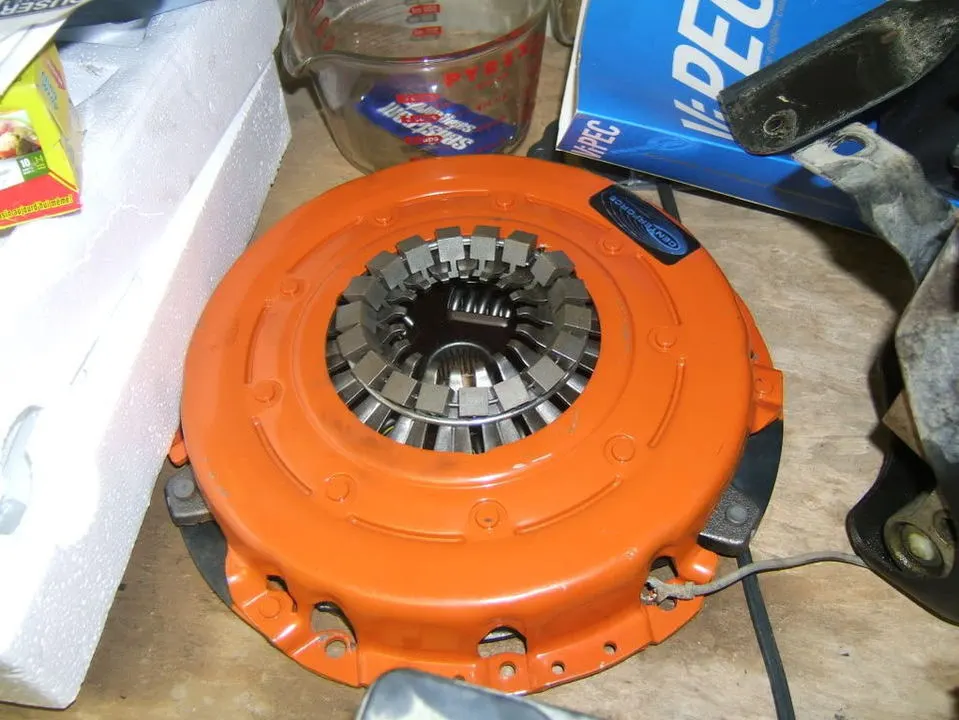

NEW CENTERFORCE CLUTCH
HAD TO INSTALL OFFSET DOWELS BUT SHE IS DEAD ON NOW. WAS ABLE TO REUSE MY CLUTCH FORK.

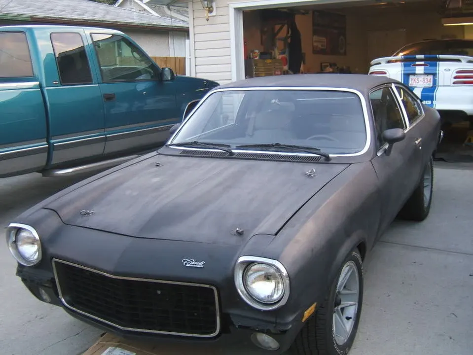

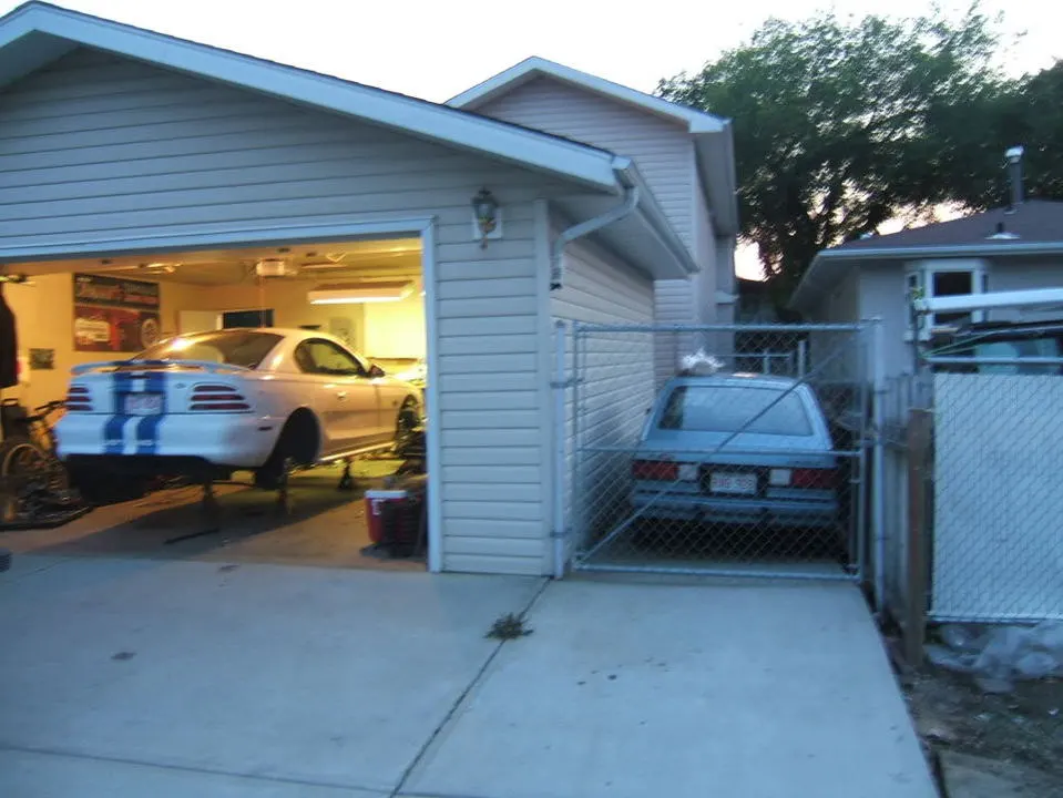

MY GARAGE WITH MY 1985 CHEVETTE PARKED ON THE SIDEWALK. LOL
MY BUDDIES 71 VEGA WITH CAMARO FRONT CLIP, 400CI, AND FOR 9"REAR
MY CHEVETTE AGAIN.

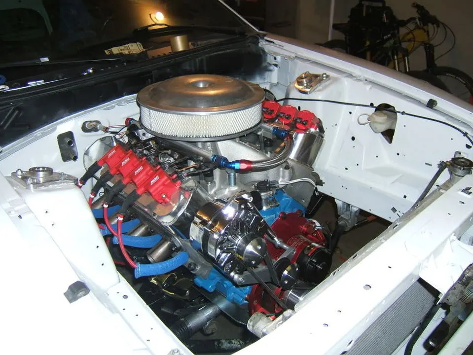

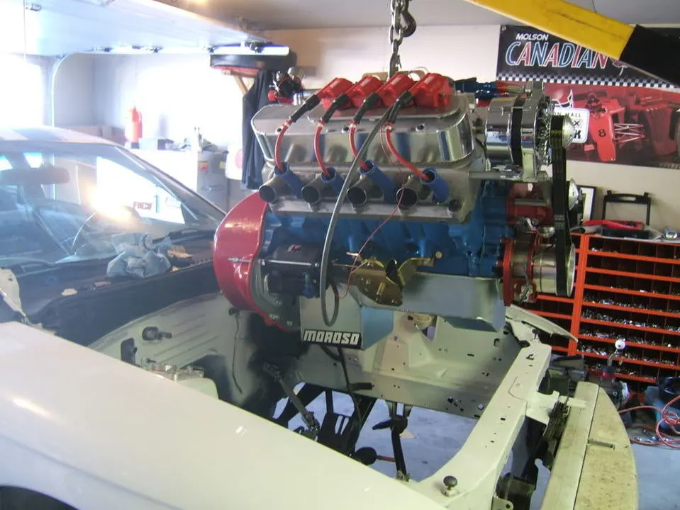

GETTING THE ENGINE LINED UP FOR LANDING
ENGINE IN AND ON THE 1" SET BACK OPTION ON THE MM K MEMBER

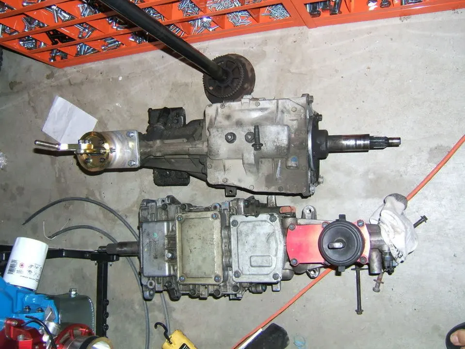

THE OLD T5 SITTING BESIDE MY TK0600
I STILL NEED TO PUT A SPACER IN CROSS MEMBER. IT SITS TOO LOW RIGHT NOW
DRIVETRAIN TOGETHER. ALUM DRIVE SHAFT FITS NICE.

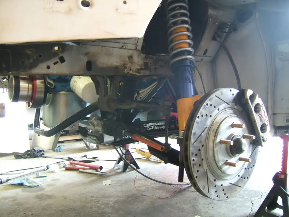

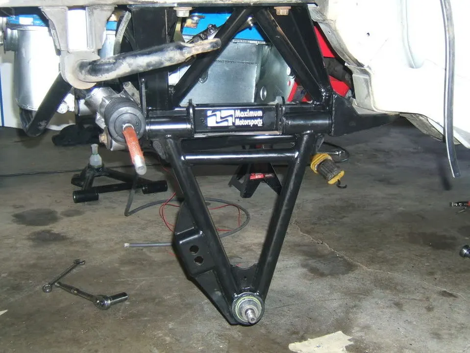

GETING THE ARMS ON

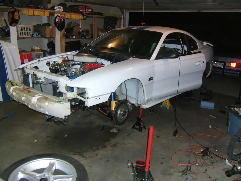

FRONT SUSPENSION TOGETHER.

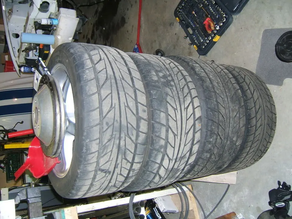

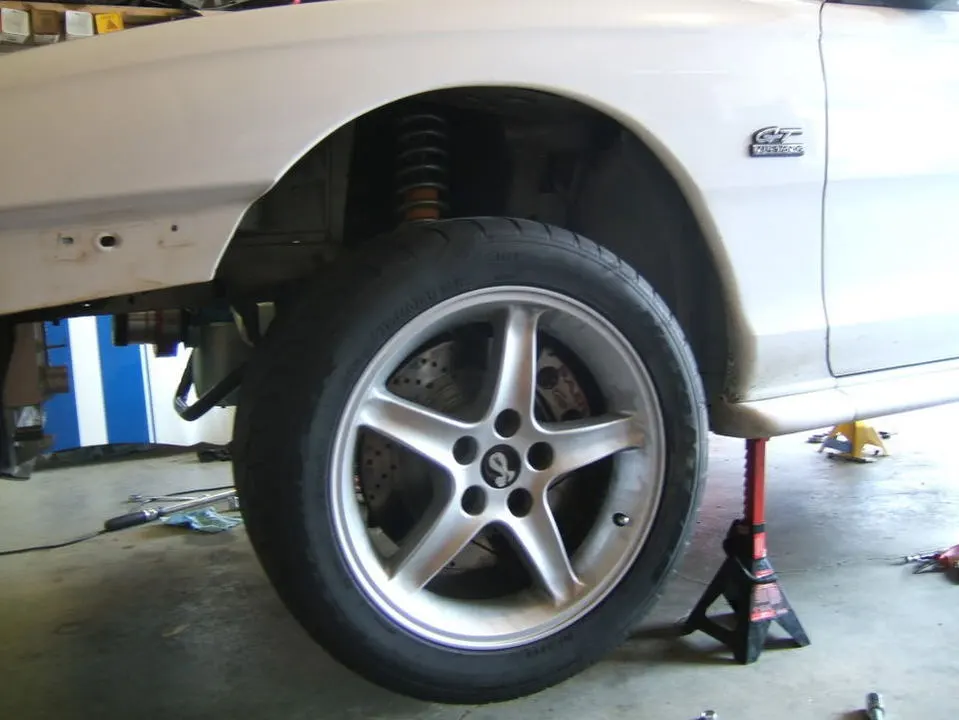

MY COBRA R RIMS WITH NITTO 555'S. HOPEFULLY ENOUGH RUBBER...
MY FRONT TIRE HAS ABOUT 1/8' OF CLEARANCE TO COIL OVER. SPACE WILL BE REQUIRED

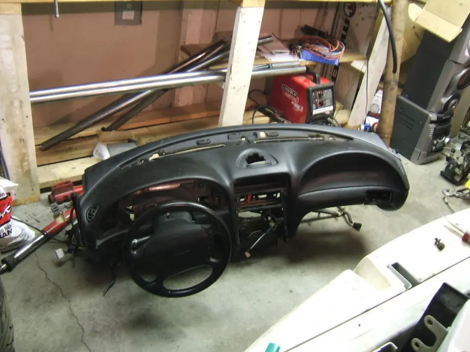

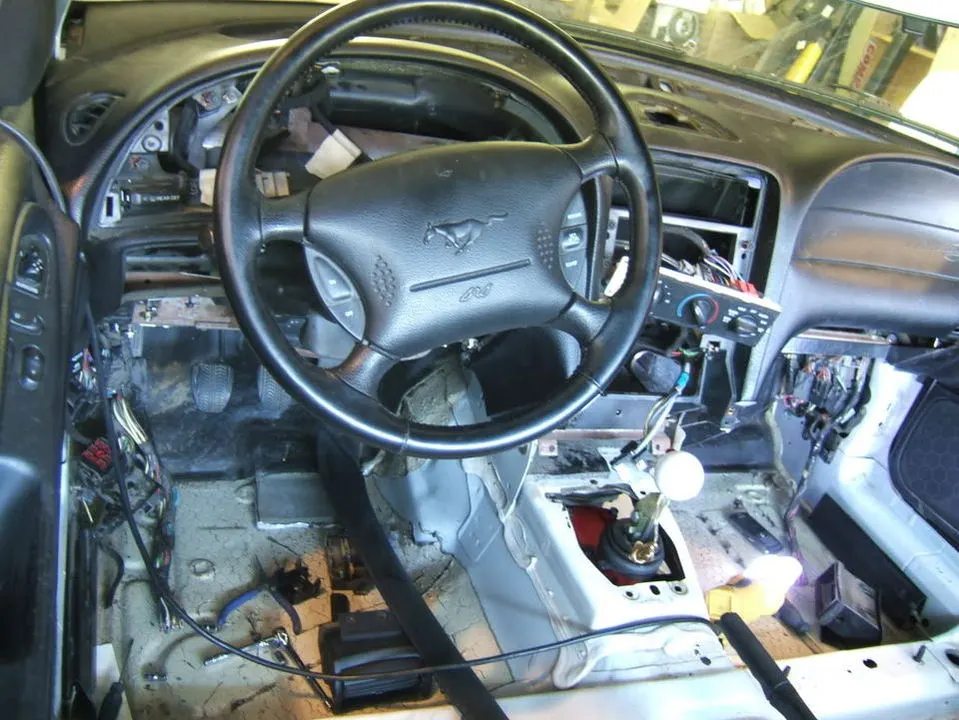

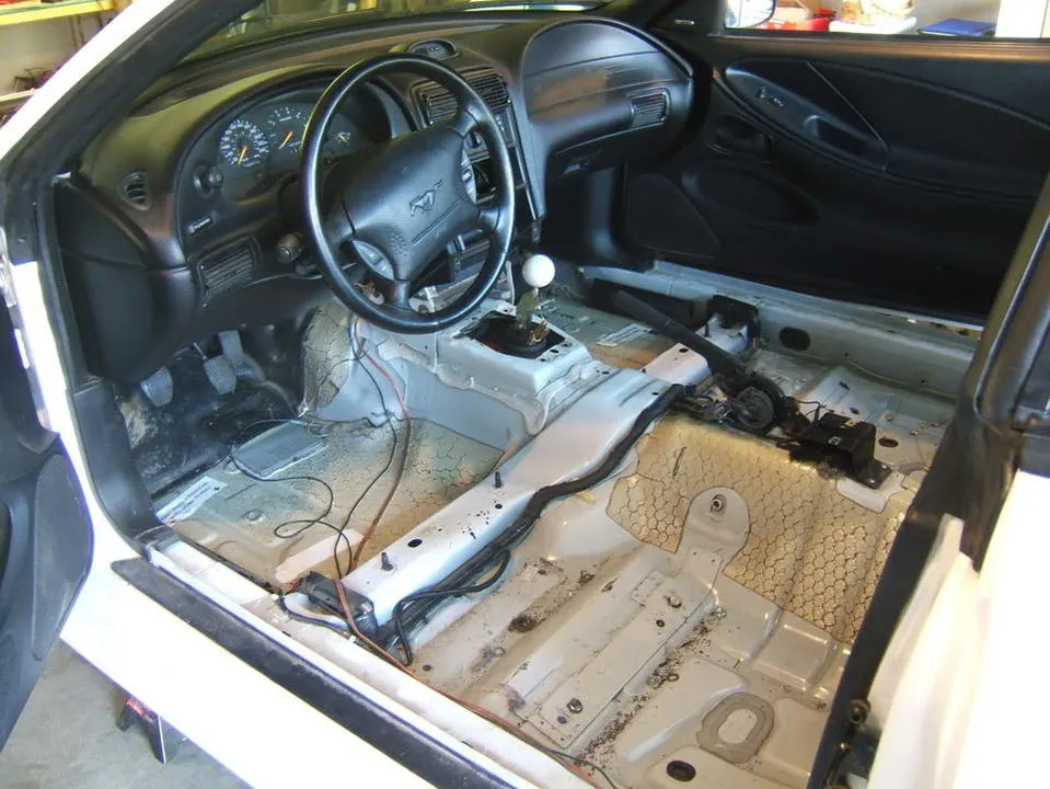

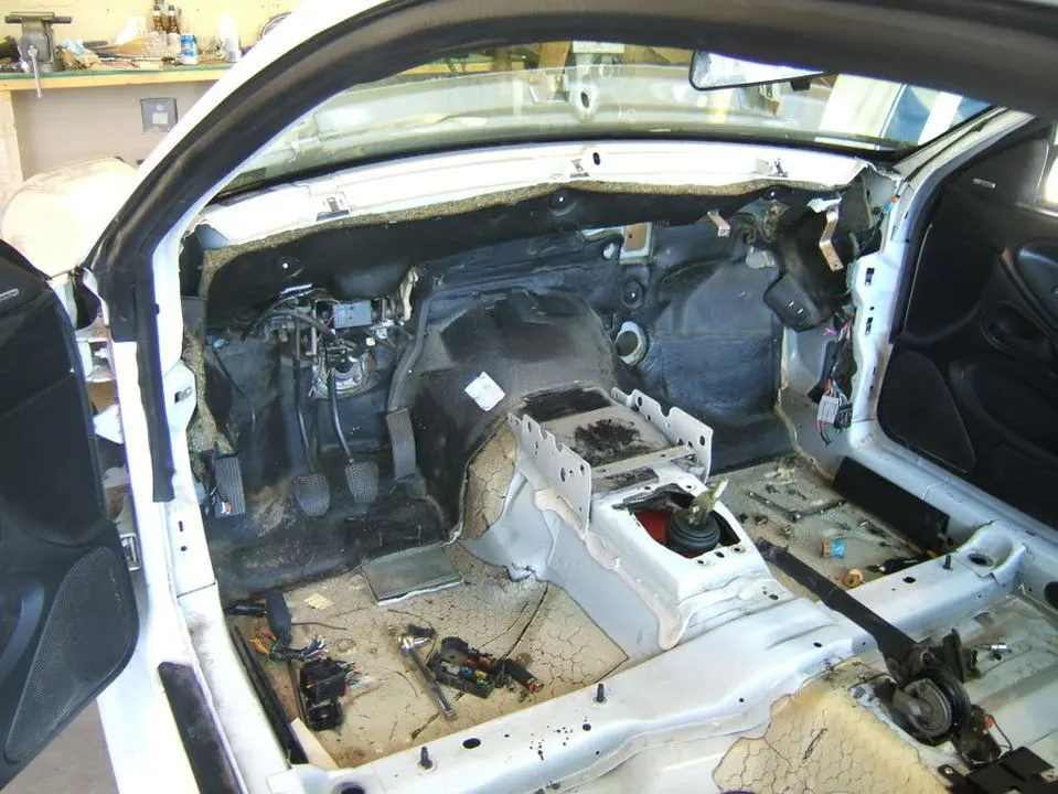

INTERIOR IS BEING PULLED FOR A BETTER LOOK.
IT COMES APART BIT BY BIT
AND POP IT IS OUT

As for the tire clearance, a trick I used was to open the holes a little on the strut and pull the top of the tire out away from the strut when you tighten the bolts down. This will take away some camber, but if you run the MM CC plates in the reverse rotation you will still be able to get at least 1.8-2.0*. I'm running 275's all around on 17X9 anniversary wheels and I don't have any clearance issues with the coil-overs.

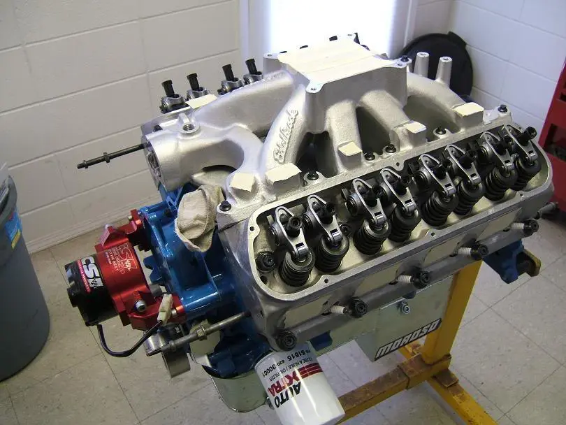

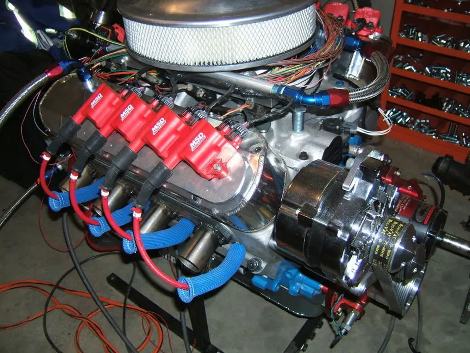

The ignition was fun. I have a buddy with a small cnc machine so he machined the mounts and I did a few stand off to bolt it to the valve covers. The coils are ls1 coil pack from msd. For the distributor I found an oil plug from msd with a hall effect sensor. Then I added an msd crank trigger. So the triggers run my ecu which run my coils. I am an electronics perfectionist so I have cad drawings of all my wiring if you are interested. I tell you though. It isn't cheap! The blue is a brainfart and would rather not let anyone know for now what happened. Just leave it to the imagination. I can tell you it included an explosion. lol

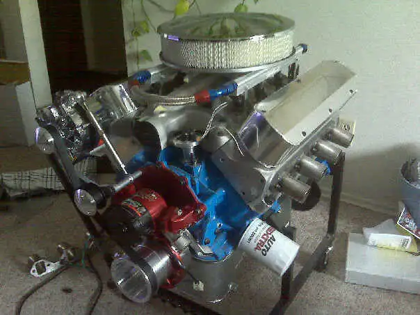

That engine was fun to build. I can't wait to hear it either. I was going to have it run on the engine dyno but I choose not to so I didn't have to build two different wire harness, find headers for the dyno(I am building my own), and I want to have this completed before the snow flies. I thought I would put down some details of the engine and check out what that engine started as and a couple of the build pics. It started as a budget build...lol
****ty 351w truck block (machined by Bel Engines .030"over)
scat 9000 stroker crank 4"
Eagle h beam rods 6.2"
probe flat top pistons yielding 11:1 CR
high flow pump
windage tray
custom cut hr comp cam (close to the Xtreme Energy series)
comp cam pro magnum roller rockers and lifters
manley push rods
Victor Jr. heads (ported to 295cfm on intake)
Super Victor EFI intake manifold
accel dfi 1250cfm throttle body
60lb injectors
ls1 coil packs
custom valve covers
vipec v44 ecu
msd hall sense oil plug
msd crank sensor
ati harmonic balancer
csi elec water pump
march pulley set
power master alternator and starter
fidanza alum flywheel
.......and a large part of my life..lol
