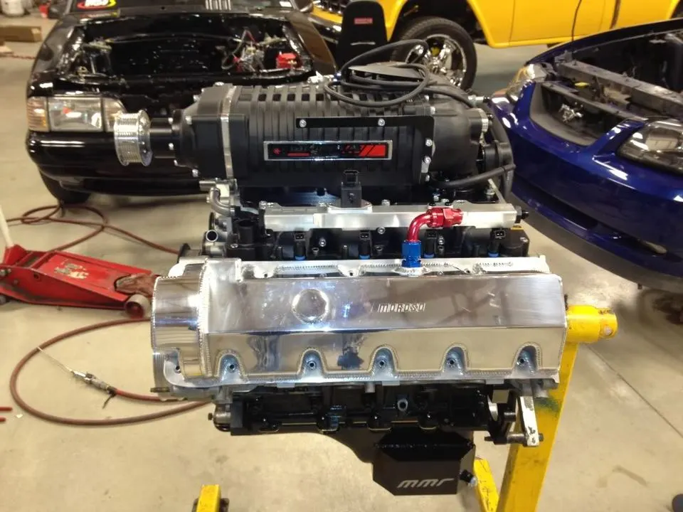

If you like the positive displacement route, go with a Tork Tech kit and a Whipple. They are 100x more efficient than that 2.1, and a 2.3 would easily support 600rwhp+. I went with Tork Tech and did a 2.9 Whipple. I wanted a little insane daily driver, so I went this route. This is how my engine sits right now.
The 2.9 was somewhere around 3400, but that is only for the blower. If you add the manifold, it was 5300. I have been seeing a lot of used cobra 2.3 Whipples for sale all over the place lately. Its possible to get the manifold and a 2.3 for less than 4k these days.
