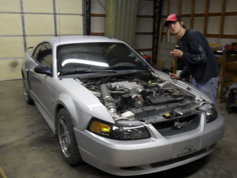

building 4.6l 2v any advice?
this is my build sheet
teksid aluminum block​
nodular iron crank​
billet steel h beam rods​
manley forged dish pistons 8.94 compression ratio​
clevite bearings​
copper head gaskets​
ARP studs​
1999 2v PI heads​
stage 1 comp cams duration @.050 226/230 lift 550​
comp cam stage 2 springs​
2.1l kenne bell 15 psi​
42lb injectors​
75mm throttle body​
90mm mass air​
billet cam spacers​
msd high output coils​
autolite forced induction plugs​
bbk shorty headers​
mmr high volume oil pan​
electric water pump​
Im sure i am leaving things out. Do you have any tips? this is my first modular build. how many ponies do you think it will be putting out?​
