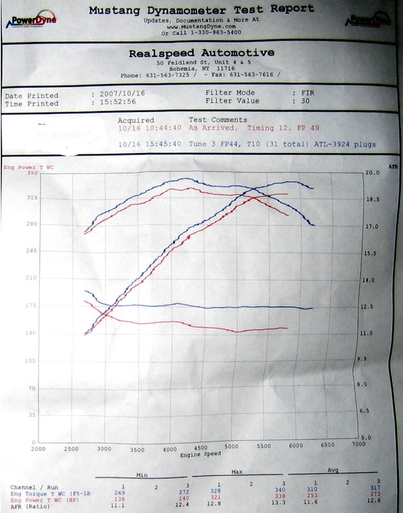

dyno results
poulrais said:
Holly sh***!!! Is there an error in the prior posts dates or it really took you 3 years to get it done?? You're one hell of a patient guy!!
if you want to count from when i started buying parts it would be 6-7years total.
heres the dyno results if anyone is interested

Good but was these numbers achieved with a tune? Seems your A/F ratio at peak hp and torque is a little on the lean side no?
yes the blue lines are after the tune, red is stock computer run.
i dont have a supercharger yet, not sure when if ever i will get one.
12.5:1 A/F i was told was pretty much ideal for a n/a combo

12.5:1 is just fine for a N/A motor
