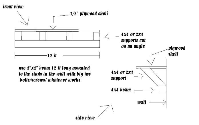

If you make sure your shelf is running perpendicular to the floor joists above and make sure the wall is a load bearing wall, I dont see why you cant just screw it with a self tapping screw if you have wood and a tapcon if there's masonry or cmu behind the gyp board on the wall

tundein's idea would be the strongest if combined with some beams from the edge of the shelf up to a headder beam that is screwed into the truses.
like have a 2X4 or a 2X6 running against the truses and have some 2X4's come off that to the edge of the shelf and have some tri supports like tunedin has on the bottom. you could hold alot of weight like that even how tunedin's is will hole more than enough.
