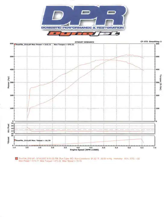

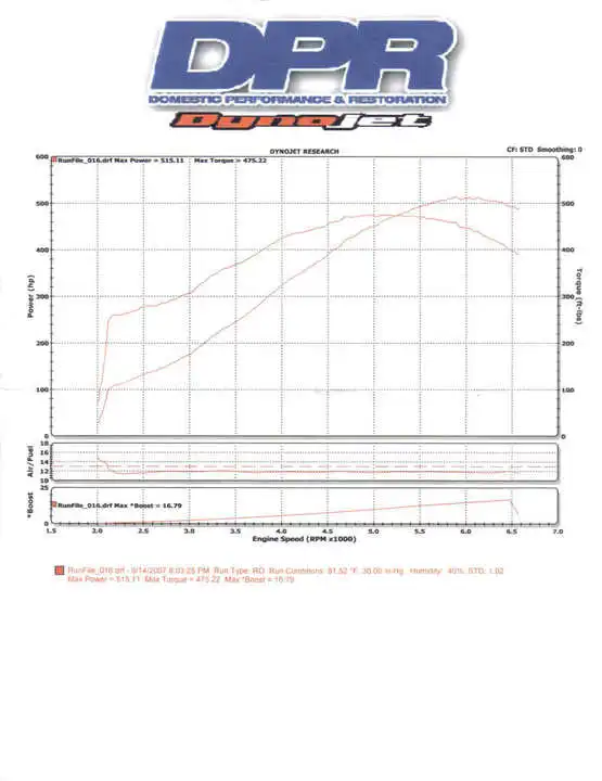

Here's my dyno after putting it back together, with an S trim, non intercooled, only spraying methanol which the IAT sensor was pre methanol at the time, and was pulling timing. It had more in it for sure.

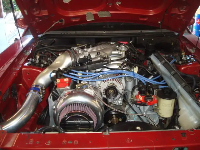

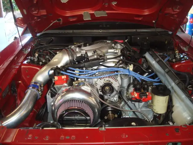

Now I've got the Novi 2000, FMIC, Bullitt intake and big fuel system. Looking for north of 650rwhp with this new combo, we'll see soon.
It's almost done!
