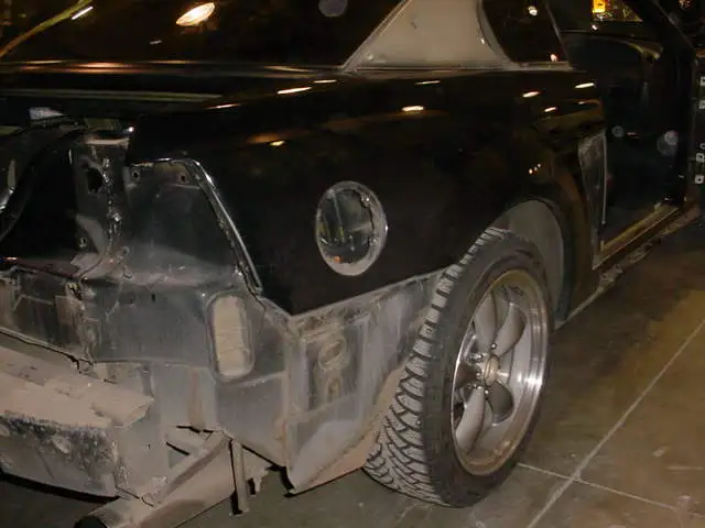

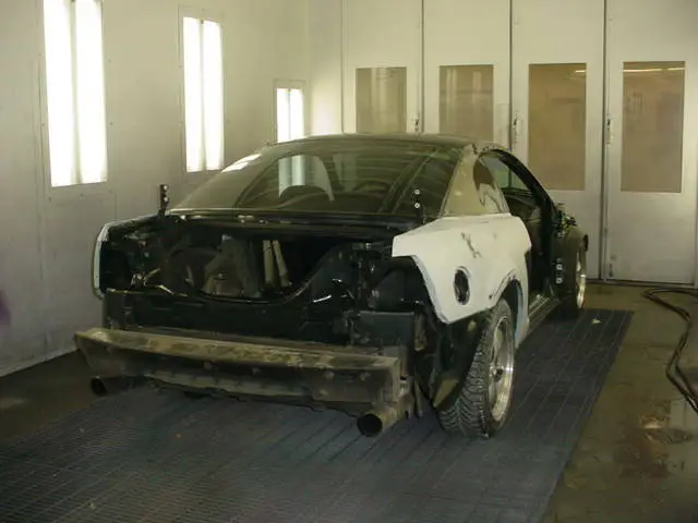

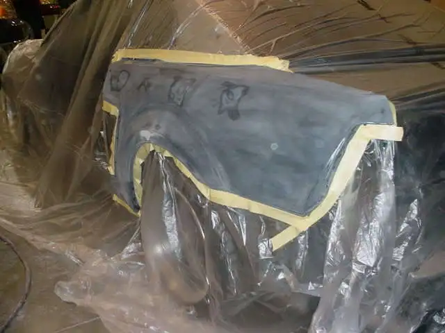

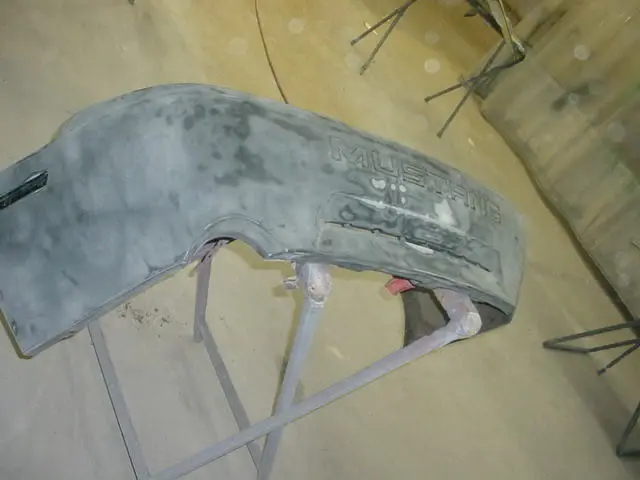

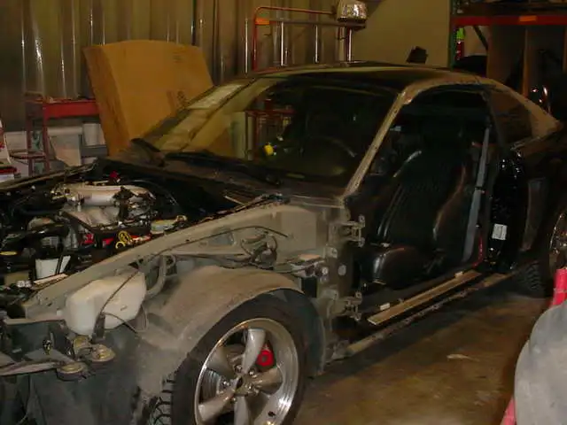

Teardown pics

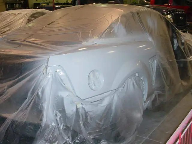

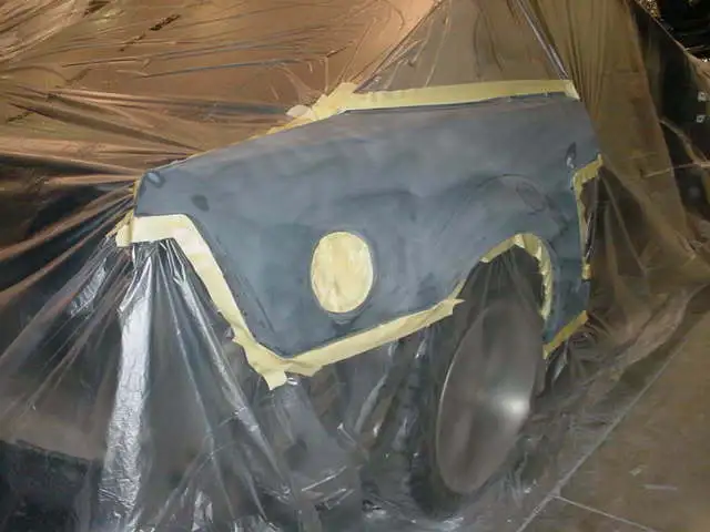

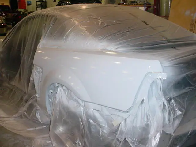

Quarter repair and primer
Tonight i am going to block and prep the quarters, roof, door and trunk jambs. Our plan is to paint the body of the car tomorrow night, then start working on the other panels and trim. The roof and jambs didnt need any primer do to not having any waves or door dings.

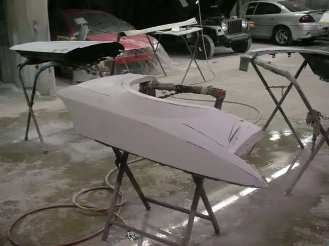

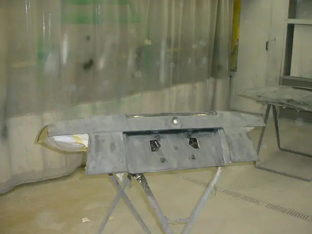

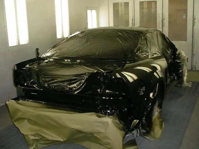

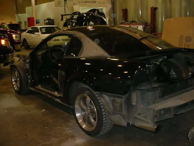

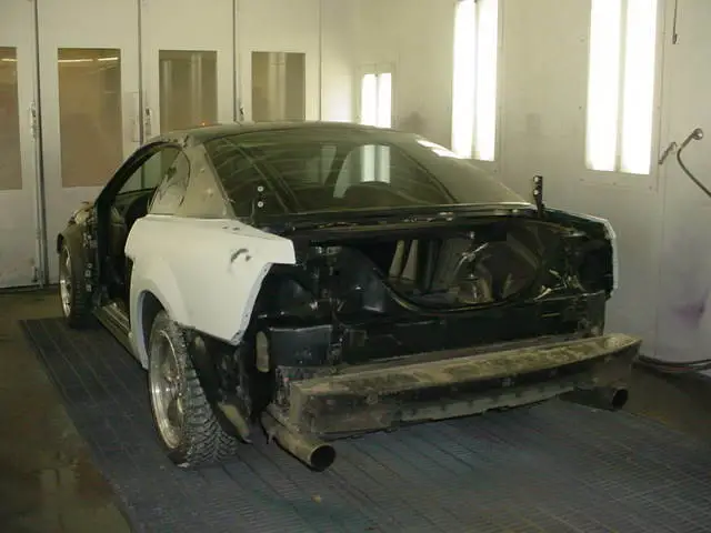

Okay, here are some more pics of the progress.

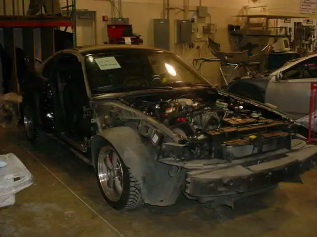

Car in booth prepped out for paint

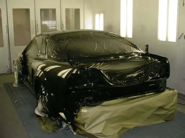

Car in booth painted "Jet Black", not the factory milky black

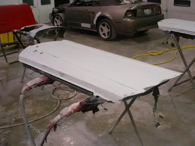

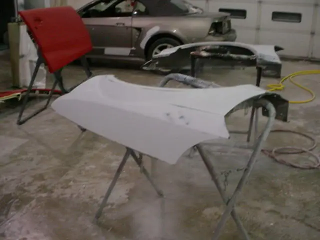

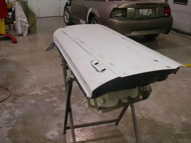

Trunk, hood, and bumper blocked out

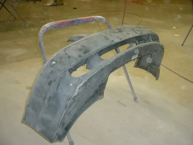

Trunk, hood, and bumper primed and ready to be blocked for paint

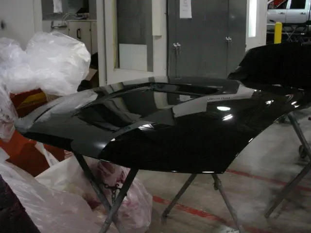

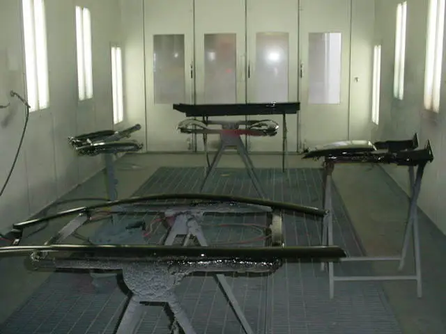

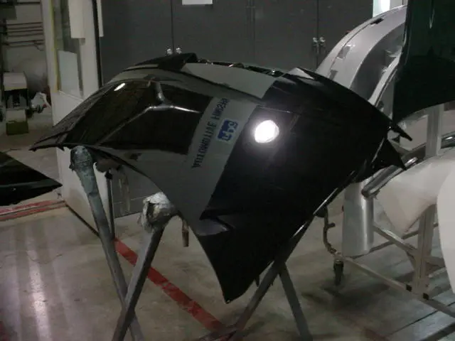

Hood and trunk painted last night
I will be getting the bumpers painted tonight and prep out the doors and fenders to get painted tomorrow. I am hoping on starting the re-assy Sunday.

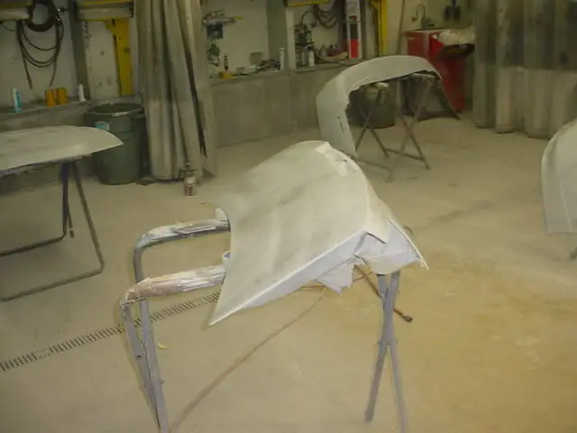

More pics for tonights blocking and wet sanding for paint tomorrow. welded up the emblem holes and antenna hole, much cleaner looking.
The door actually wasn't to bad. I actually mixed the filler, put it on, and blocked it down.I. Turned out pretty good too, for a first timer. The only thing I did not do myself was weld the fenders and spray the color. Bruce said I should work in the shop instead of the office.
