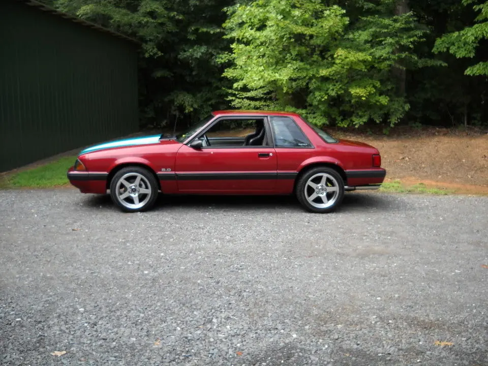

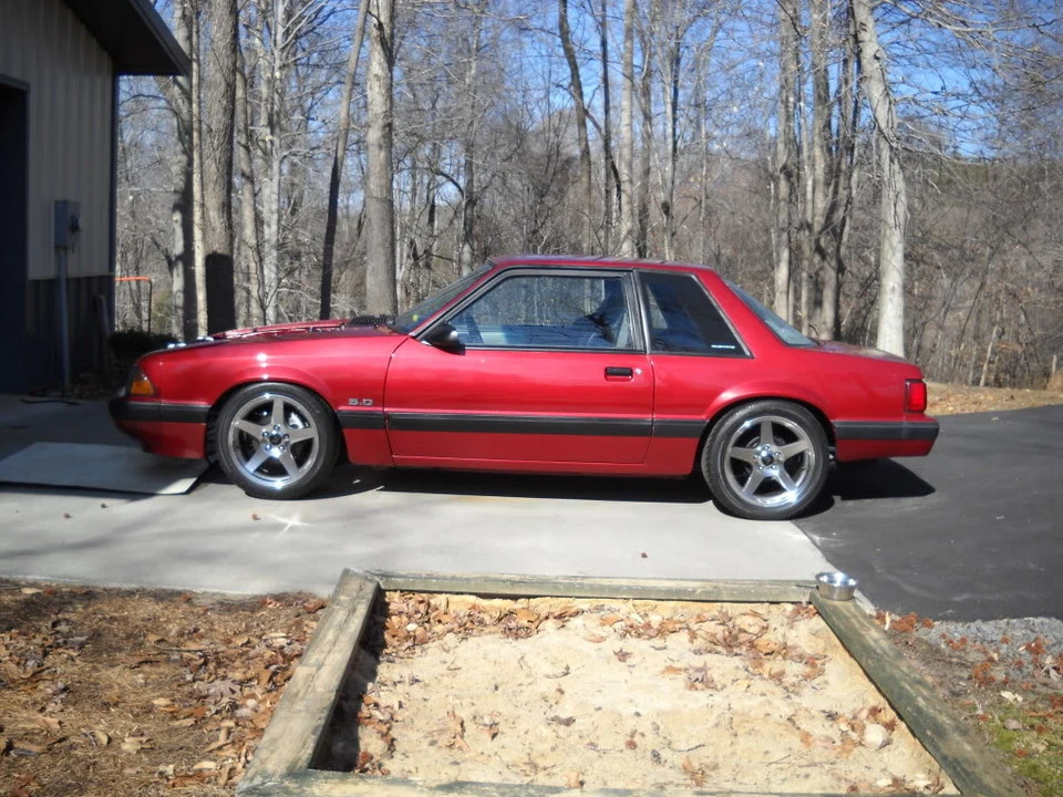

Ricer... Well let me see here. Is this "ricer" in your book?
let's compare to stock with no isolators on the same car... which would round out to about the bullitt springs stance.
Yea... Even if it rode like it was on bricks and barely turned, I would still rather have the first stance no matter what.
"Ricers" Usually don't even have good stance. They have body kits, 15" stock wheels with hubcaps, and 4x4 stance. An "Import" has great stance and stock body parts, besides a lip. A "Street" car can be lowered 1.5" and still ride good from all of my experiences. My coupe rides better now with the "RICER" stance that it has now that it did with the stock springs and struts. Not to even mention handling. Plus I have ZERO rubbing issues at this height. I don't see how you guys are having rubbing issues on your 4x4s. But I did go with coilovers, so that's probably part of the reason. My 97 GT rides exactly the same that it did with stock springs. It has Eibach sportlines on the STOCK 128,000 struts. It handles better and looks 50,000 times better.

slow90coupe your rear stock pic is still on the high side for bullitt springs. plenty of ricer dropped imports in my area, they hit a little bump or hump in the road and I can see the driver bounce around more than a freaken truck driver. most of them aren't running very good set ups and are going for looks vs function. you can lower and get function but also it gets to point where it starts going the other way, you would really have to drive hard enough to find that the car is over/understeering more than it should or be around a well set up car to see the difference. again street vs track are 2 different things. running a real low stiff set up while good looking granted can be much slower on the street when trying to make turns on rutted roads, etc and the car washing out ( in very basic terms). sweet looking notch though :nice:
Thanks! BTW... I love your car. So clean and tasteful!
