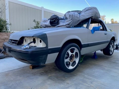

Full weight of the car must be on the suspension. I typically pull the wheels and put support under the balljoint.
To really set it, it needs to be measured. Eyeballing only gets you so close.
You want parallel from inner pivots to the balljoint pivot, not the physical control arm itself
