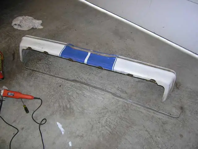

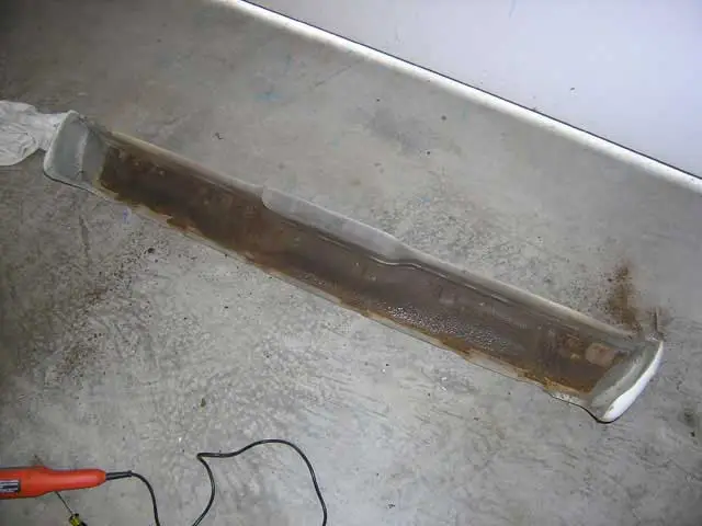

Getting ready for paint. I dropped the rear bumper and removed
the heavy rebar support section. There is a thin metal section that
attaches the urethane to the heavy support. The urethane is bumpy in
some spots like rust has formed underneath. My question is.
Do I try to peel the urethane bumper from this thin metal sheet or will
I end up ripping it? Is there a good way to do this. Lots of rust but bolts
are intact and I think it can be saved.
thanks for suggestions
andy

I just peeled my urethane off the cast-in reinforcement, and would suggest that you leave well enough alone. A couple of bumps won't match the heartache that you will find underneath that plastic. In short I am now looking for a whole new bumper (rebar and covering). I am seriously considering making the rebar and using a fiberglass cover, they are cheep.

Fixing Bumper
Had no idea bumpers rusted out and are difficult to find (like most II parts).
After looking around internet, I think I probably have a pretty good set. The
rear is the worst and I think I will leave alone and not try to peel away. I wirebrushed and coated with rust neutralizer, then I will prime. Let the body
shop sand and paint urethane.
thanks
andy

I would think that unless you are into/willing to do some major work on these, you would be better off to just grind or sand the high spots down flat than to do this?.
The bumpers on these cars are one of my biggest peves, I hate the way they hang over the ends and I was planning to cut/chop a section out each side and rebond/weld the bumper so it fits flush to the body side
