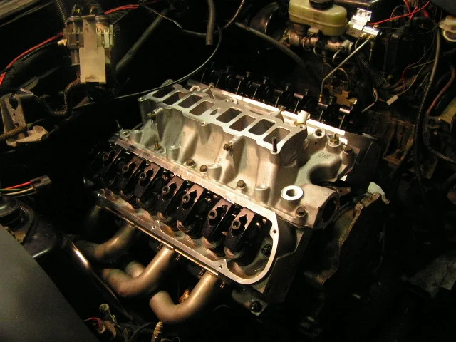

I have GT-40 P heads, and FMS Shorty P Headers (I guess they're P headers, they came w/ the car). Anyway, while the engine was out, I sanded the headers down to bare metal, cleaned them, painted them w/ 2 coats of POR 15, then used clear spray paint to clear them.
Got the engine back in and ready and started it up finally today. The engine started smoking almost immediately, but I thought nothing of it - figured it was oil etc burning off and looked down - MY HEADERS ARE BURNT TO A CRISP! After they cooled down, I picked at one of the bubbles w/ my finger and it flaked off and it looked like the POR 15 below might be ok, but I guess the clear is what burnt. This sucks!
pic.php
I really don't want to buy new headers, so I might just keep them.:nonono:

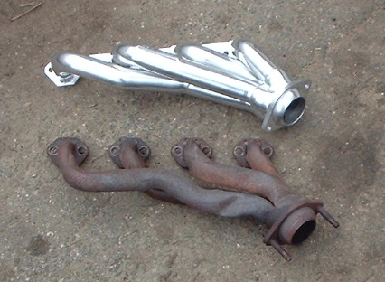

Polished ceramic are what I have, and even they wore down pretty quick. They looked like this brand new next to my stockers:
but now are a dull silver. While they may be dull, they still aer perfectly intact with no chips or anything of that nature. I am happy enough with that considering it could've been much worse. :shrug:
Any pics of what they look like now? I don't know...I don't have a show car, and there's a 50/50 chance I'll sell it within a year, but I'd like the headers to look decent without spending too much money.

...but now are a dull silver. While they may be dull, they still aer perfectly intact with no chips or anything of that nature...
You can go over the ceramic coating with a never dull compound and they should shine back up. That is what the jethot instructions said to do with my FRPP ceramics. It worked pretty good for me. Eventually they will dull back up.
