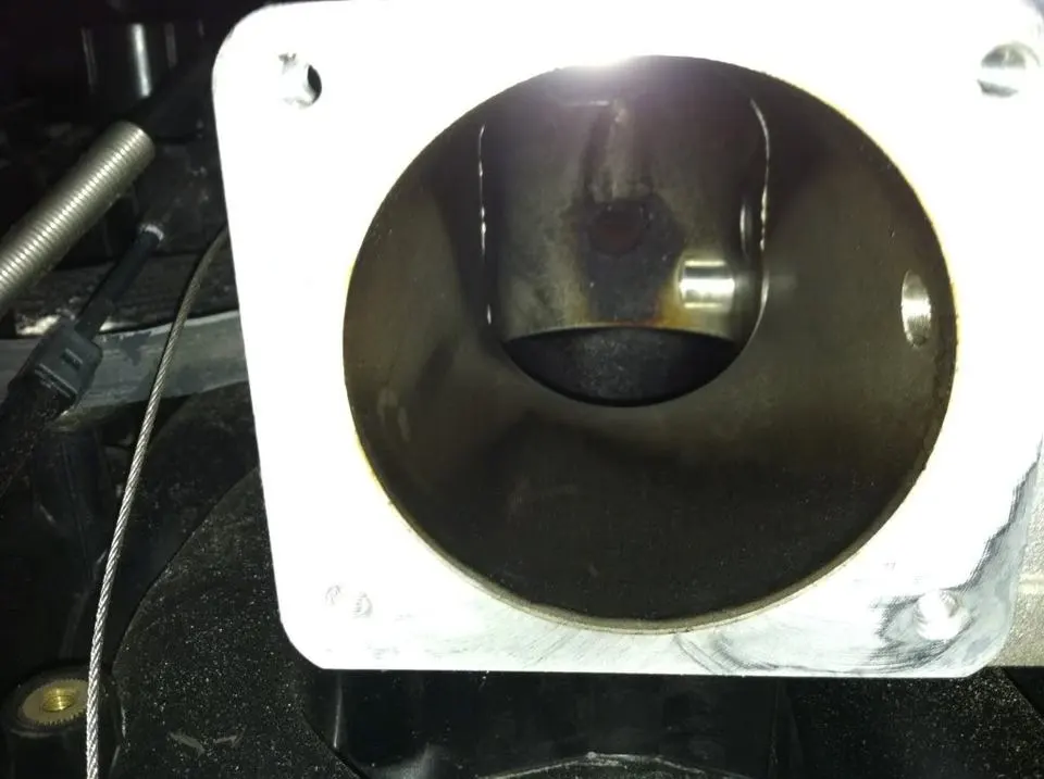

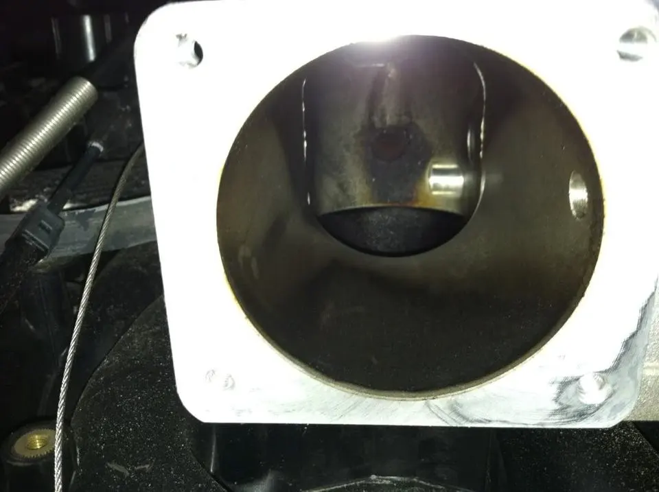

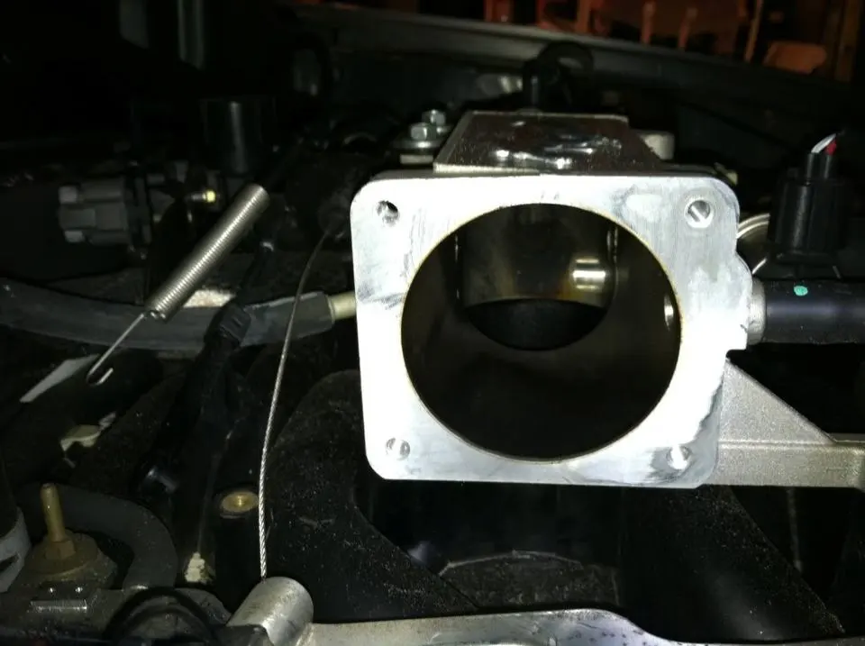

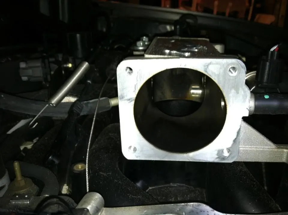

Burnt intake plenum and tb?
It's likely carbon build up. Wipe it out with a dry rag and leave what won't come out. MOST throttle body's have a coating of something (can't think what its called, hell it may not have a name, I'm getting old), anyway, tb's have a coating on them that if you clean it off, it will screw with the idle. If the stuff is oily, then ur pcv valve could be messed up/clogged and causing oil to seep up into the intake system. easy/cheap fix if that's the case.

What you are seeing is perfectly normal. It's a mixture of oil vapor and mist from the PCV system and exhaust gasses from the EGR system It's harmless and nothing to be worried about.
Don't bother cleaning the TB or plenum.

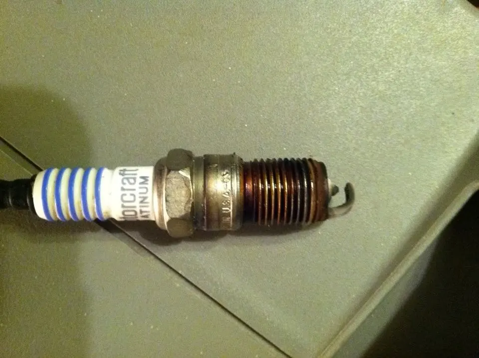

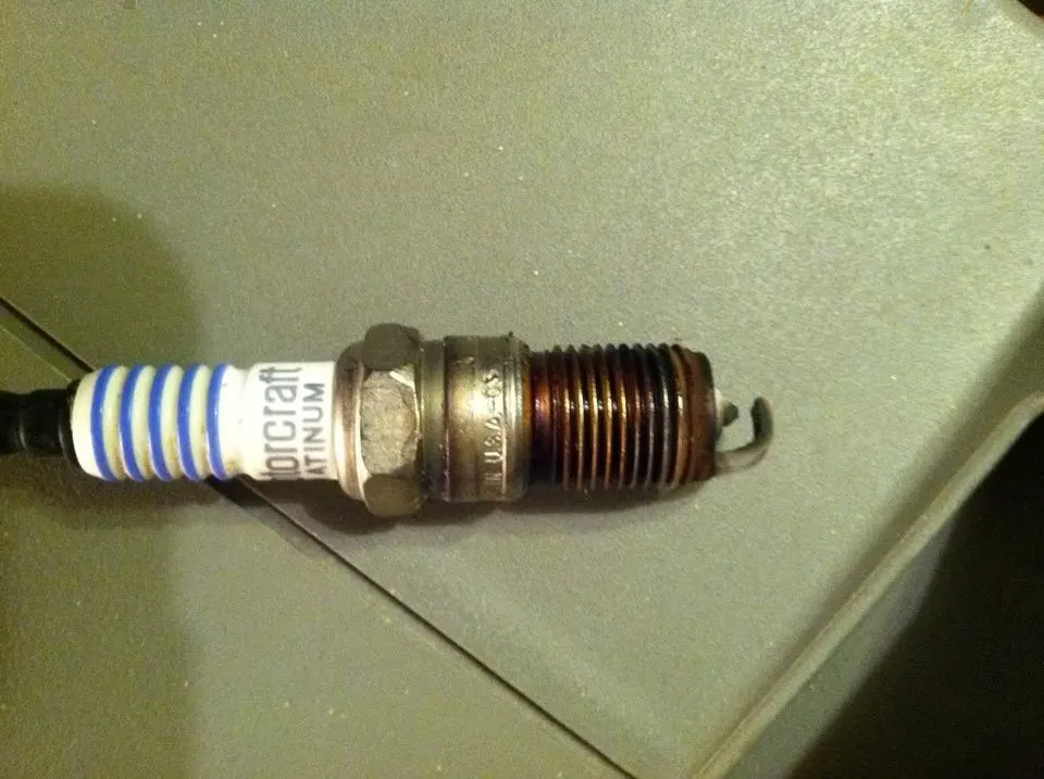

The plug looks normal too in terms of some oil on the threads. However, the electrodes from this angle look a little rounded and the plug gap a little large. Get some new OE plugs. Make sure you properly torque the plugs when re-installing them.
Yesterday, i replaced the spark plugs with new motorcrafts, did an oil change, and changed the fuel filter and put in a new air filter. Is there anything other maintance items i should do since i just got the car and i have no records of what has been done to it? Im just trying to cover all the bases.

The PCV valve won't change the amount of oil vapor entering the intake. This is a function of everything from engine blow-by to oil temperature to viscosity etc etc. The PCV valve is simply there to close off the system at idle to prevent a vacuum leak-like condition that would affect idle quality. If you're really concerned about oil in the intake look up what are known as "catch cans" or "oil separators."
What I see in your pictures raises no alarm bells for me in terms of oil in the intake.
